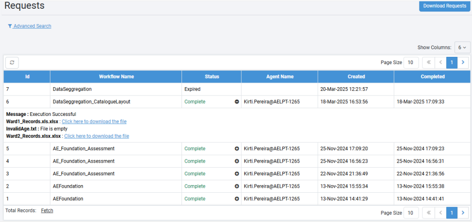

  1. In the menu, click Requests. The Requests page appears.
    Requests page
    IdDisplays the unique ID of the request.
    Workflow NameDisplays the name of the submitted workflow.
    Note: If the workflow fails, the reqeust status changes to Failure and the option to retrieve execution log appears. For details, see Retrieve Execution Logs.
    PriorityDisplays the priority of the workflow request.
    StatusDisplays request status and message description.
    Click Requests page to expand the view and see the message description.
    Click Requests page to collapse the message view.

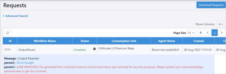

If there is an output parameter type hyperlink in the workflow, then you will see a link if the validations are fulfilled, else you will see a message, respectively. See the following screenshot:
Example 1:
Request
param2: if the validation is fulfilled, you will see the link to the external site. Click the link and you will get redirected to the site, which will open in a new tab. param3: if the validation is not fulfilled, the link is removed, and you will see the message informing why the link was removed. If there is an output parameter type AE-AppLink in the workflow, then you will see a button or message, respectively. See the following screenshot:

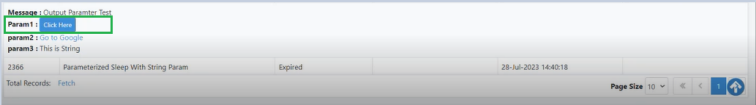

Example 2:
Request
Param1: if the validation is fulfilled, you will see the app button. Click the button and you will get redirected to the AE app, which will open in a new tab. However, if the validations are not fulfilled, you will see a message informing you that the app does not exist. For details about AE app, see Work with AE Apps. For more details about configuring the output parameters using hyperlink or AE-AppLink option, see Set Workflow Result step, in the Standard Plugin Reference Guide.

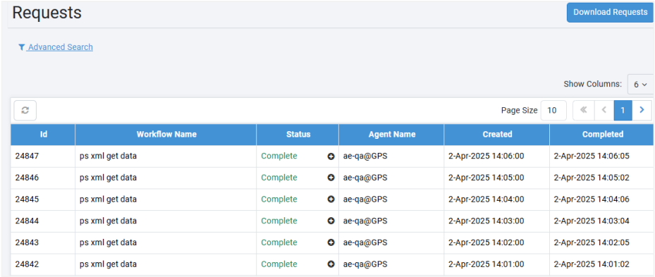

    Request
  2. Click Download Requests. The Download Requests dialog appears.

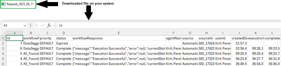

    Request
  3. Enter the page number and click Download. The file is downloaded in CSV format.
    CSV Format
