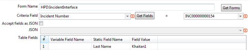

| Field Value | Specify field values to be inserted in the corresponding chosen fields. Following, is a sample snapshot of input tab with Table Fields with Static Field Name. You may also provide variables in Variable Field Name instead of Static Field Name. ![]() |
