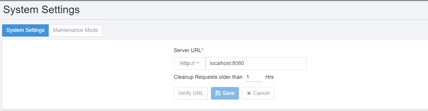

- In the menu, go to Settings→System Settings. The System Settings page appears with the System Settings tab selected, by default.
If you are configuring the details for the first time, then the System Settings page appears blank.
Figure 86: Configure System Settings
On the page, click Configure. The configuration fields appear.
Figure 87: Update Settings
- Enter the field details, as required.
| Field name | Description |
| Server URL * | Enter the URL of the primary server. |
| The server URL is the host name or IP address and Port of the AE server to connect to from the Intranet or Internet. | |
| Note: The server URL is also the Primary Site. | |
| The server URL is the URL (hostname/IP-address and Port) of the AE server to connect to from the Intranet/Internet. | |
| For example, http://localhost:8080 | |
| Cleanup Requests older than -Hrs | Enter the duration in hours after which requests in *New *state are cleaned up, and marked as Expired. |
*: indicates a mandatory field.
Click** Verify URL**. A message confirming the URL is valid appears.
Click Save. A message confirming that the system settings are saved successfully appears.

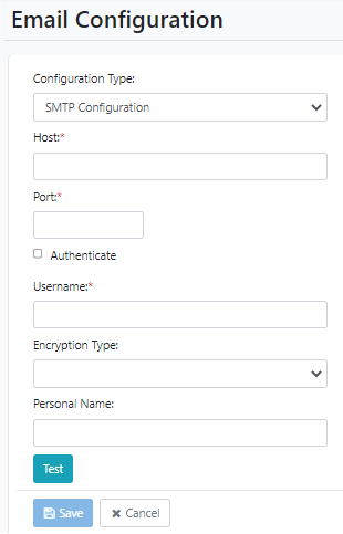

You can configure the email server using the Simple Mail Transfer Protocol (SMTP) configuration.
**To add an SMTP email configuration **
Following are the steps to configure SMTP.
In the menu, go to Settings→Email Configuration. The Email Configuration page appears.
On the page, click Add. The Configuration Type selection dialog appears.
If you are configuring the details for the first time, then the Email Configuration page appears blank.
Figure 92:Email Configurations
From the list, select SMTP Configuration. The SMTP Configuration detail fields appear.
Figure 93: SMTP Configuration page
| Field | Description |
| Host* | Enter the hostname or IP address of the LDAP server. |
| Port* | Enter the port number for LDAP connectivity. For example for Gmail SMTP serverthe port is SSL 465 TLS 582. |
| Authenticate | Select the checkbox if you want to authenticate the user before connecting to the SMTP server. |
| Note: If you select the checkbox, then the Password field is available. | |
| Username* | Enter a username for authentication. For example, mail ID is the username for Gmail. |
| Password* | Enter the app password for user authentication. For example for Gmail the password is the 16 digit app password |
| Note: The app password is not your mail login password. | |
| Encryption type | Select the type of encryption you want. Available options are: |
| - SSL | |
| - TLS | |
| Note: If you select TLS, then the Protocols field appears. | |
| Protocols | Select one or more protocols for setting up SMTP configuration. |
| Personal name | Enter the name you want to appear as the sender in the email. |
If user selects TLS as the Encryption Type, a Protocols list appears.
You can select one or more protocols for setting up SMTPconfiguration.
Click Test to validate the SMTP connectivity. A message confirming the success of the connectivity appears.
Click Save. The SMTP configuration details are saved.

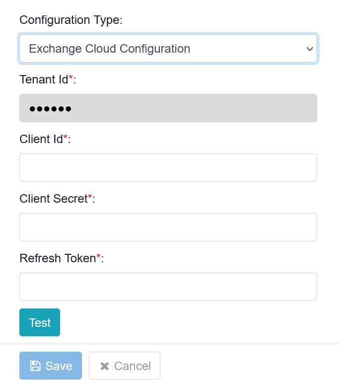

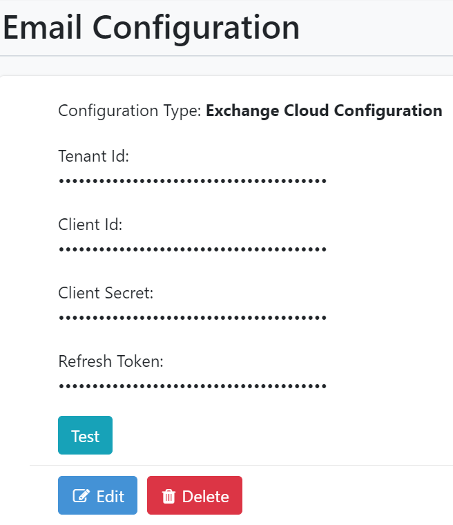

Add an Exchange Cloud configuration
To use Exchange Cloud configuration, you must have a Microsoft account. Create an account through the Azure AD portal. For details, see Appendix 17: Office 365 App Registration for Grant Type Refresh Token in Plugin Reference Guide 3.:::
To add an Exchange Cloud configuration:
From the list select Exchange Cloud Configuration. The Exchange Cloud Configuration detail fields appear.
Figure 94: Exchange Cloud Configuration page
Access your Microsoft account to fetch the details.The details will appear encrypted in the fields
Figure 95: Exchange Cloud Configuration details
| Tenant Id | Copy-and-paste your Microsoft account Tenant Id. |
| Client Id | Copy-and-paste the client ID of the application created in your Microsoft account. |
| Client Secret | Copy-and-paste the client secret generated in your Microsoft account. |
| Refresh Token | Copy-and-paste the refresh token generated in your Microsoft account. |
Click Test to validate the Exchange Cloud connectivity. A message confirming the success of the connectivity appears.
Click Save. The Exchange Cloud configuration details are saved.

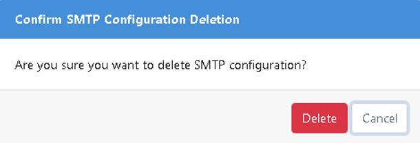

Delete email configuration
You can delete the email configuration, if required.
To delete an email configuration:
In the menu go to Settings->Email Configuration. The Email Configuration page appears.
On the Email Configuration page, click Delete. The confirmation dialog appears. For example, if you are deleting SMTP Configuration, then the Confirm SMTP Configuration Deletion dialog appears.
Figure 96: Confirm SMTP deletion dialog
- On the dialog, click Delete. The SMTP configuration deleted successfully message appears.

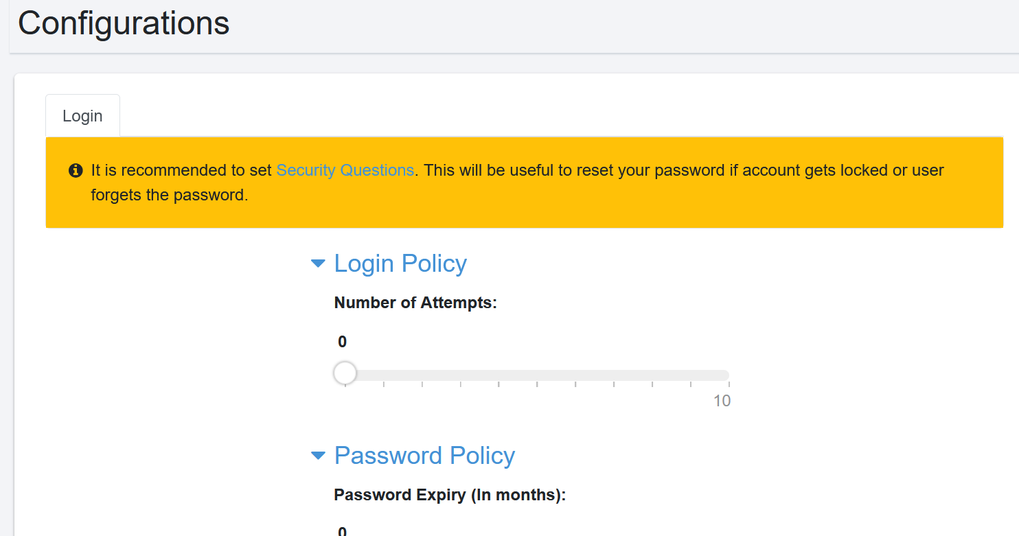

You can view or configure the policy for sign in attempts, creating a password, and concurrent logins.
Note: The assumption is that you are already signed in to the AE UI as System Administrator.
View System Administrator configurations
View the various policy configuration details.
To view the configuration details:
In the menu, go to Settings -> Configurations menu. The Configurations page appears.
Click the links to view the respective policy details:
Login Policy: View the configured number of login attempts.
Password Policy: View the password policy configuration.
Login Session Control: View the concurrent login configuration.
Modify System Administrator policies
You can modify the details of the System Administrator policy, if required.
To modify the System Administrator policy details:
In the menu, go to Settings -> Configurations. The Configurations page appears.
Figure 97: Login Policy
Click Login Policy and toggle the switch to set the number of login attempts for the user. You can set the value between zero to ten (0 to 10).
The default value is 0, which indicates that there is no limit on the number of times a user will be able to sign in even after an incorrect sign in attempt. If you set a value other than 0, the user is informed about the number of attempts left after every incorrect sign in attempt. If the number of attempts exceed the set value, then the user account is locked. For more information on unlocking a user account, see Unlock user account.

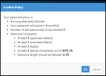

- Click Password Policy, and toggle the switches for the respective fields:
| Password Expiry (In months) | Scroll to set the password expiry month. You can set the month between 0 to 12. |
| NOTE: If you set the value as 0, then there is no expiry month for the password. | |
| Password History | Scroll to set the number of previous passwords that cannot be reused by the user. The default value is one. |
| Minimum Length | Scroll to set the minimum length of the password.The default minimum length of a password is six characters. |
| Maximum Length | Scroll to set maximum length of the password, which is 20 characters. |
| Minimum Uppercase | Scroll to set the minimum uppercase characters you want in the password. The default and minimum value is one and maximum value is 17. |
| Minimum Lowercase | Scroll to set the minimum lowercase characters you want in the password. The default and minimum value is one and maximum value is 17. |
| Minimum Special Characters | Scroll to set the minimum special characters you want in the password. The default and minimum value is one and maximum value is 17. |
| For example, special characters, such as @, #, and so on. | |
| Minimum Digits | Scroll to set the minimum digits you want in the password. The default and minimum value is one and maximum value is 17. |
- Click Login Session Control, and enter the following field details:
If you have configured the Concurrent Login details in the ae.properties file (for details see, Installation guide prior to release 7.7.2), then you will have to reconfigure the details through the AE UI.
| Control Options | Select from any of the following option to configure for concurrent logins to AE: |
| Allow Multiple Sessions: This is the default setting. If selected, a user can log in and have multiple active sessions at the same time. | |
| Prevent New Sessions: If this option is selected, the user cannot start a new session if one is already active. Trying to log in again will result in an error message. | |
| Invalidate Old Sessions: If the option is selected, then the user will log out of the current active session, and will log into the new session. | |
| User Exception List | Select the tenant users for whom you don't want to allow concurrent logins. |
Click Save. The details are saved, and the Confirm Policy dialog appears.
Figure 98: Confirm Policy
- Click Ok. The password policy updated successfully message appears.

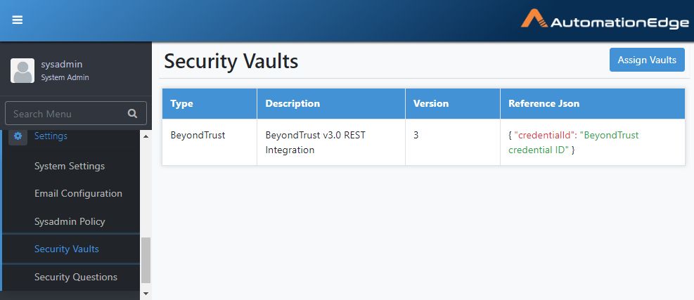

Security Vaults
Security Vaults is a secure enclosure used for storing valuable items.It often implies a high level of security. The System Administrator can assign security vaults to different tenants. Once the vaults are given to the tenants, the Admin can set up connections to the vaults. The security vault allows users to access and retrieve the credentials stored in the security vaults.
The Security Vaults option is available only if you set the enableSecurityVault key to true in the aeui-config.properties file.
You will have to change the key value in the aeui-config.properties file every time you upgrade the AE UI.
Assign security vaults to tenants
In the section, you will learn how to assign the security vault to tenants.
To assign security vaults to tenants:
- In the menu, go to Settings->Security Vaults. The Security Vaults page appears.
Figure 99: Security Vaults page
- On the page click Assign Vaults. The Assign Vaults dialog appears.
Figure 100: Assign Vaults dialog: Tenants
- Select the tenants to which you want to assign the vaults, and then select the vault type.
Figure 101 : Assign Vaults dialog: Type
- Click Save. The vault is assigned to the selected tenant.
For details about using the vaults, see the AutomationEdg User Guide.

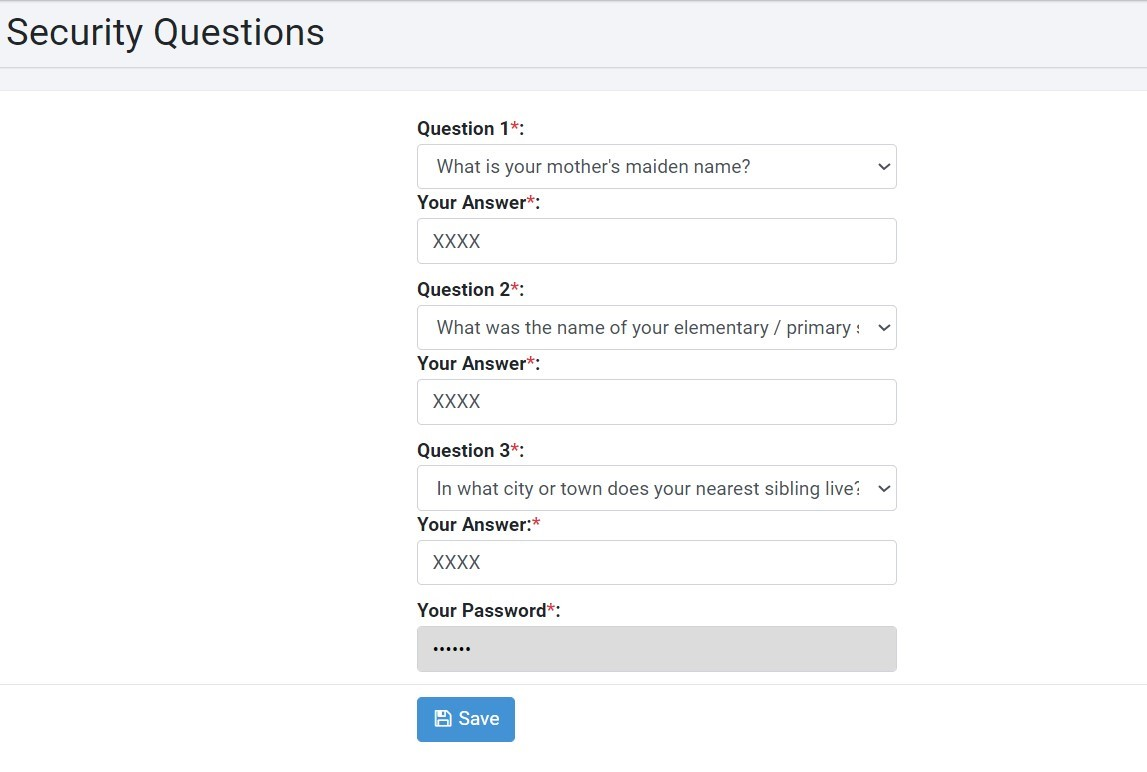

Security Questions
Setting security questions is essential in enhancing the security of user accounts and supporting account recovery.
To set security questions:
Sign in to the AE UI, and in the menu click, Settings.The Settings menu options appear.
In the Settings menu, select Security Questions. The Set Security Questions page appears.

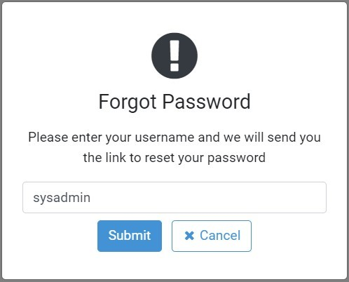

To reset a forgotten password:
On the login page, click the Forgot Password link. The Forgot Password dialog appears.
Figure 6: Forgot Password dialog
In the username box, provide the name of the user, and then click Submit. The user will receive a link to reset the password.

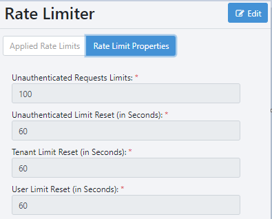

Rate Limit Properties
In addition, you can modify the rate limit for unauthenticated requests and the time limit after which the users can again attempt to make request calls.
To modify the rate limit properties
In the menu, go to Settings -> Rate Limiter. The Rate Limiter page appears.
Click the Rate Limit Properties tab. The properties details appear.
Figure 104: Rate Limiter
Click Edit. The read-only fields become available for modifying the details.
Modify the details, as required, and click Save. The limit details are updated.
