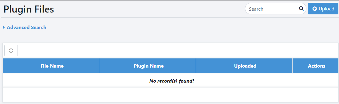

  3. Navigate to the File Management Plugin Files menu. The Plugin Files page appears.
IMG_256
Figure 55: Plugin Files Page

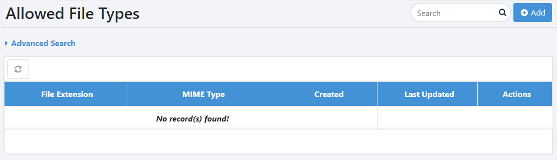

  1. Navigate to the File Management -> Allowed File Types menu. The Allowed File Types page appears.
IMG_256
Figure 57: Allowed File type
