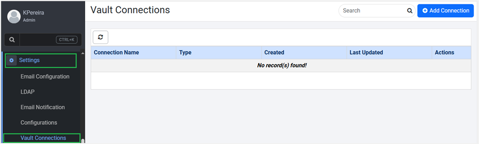

  1. In the menu, click Settings → Vault Connections. The Vault Connections page appears.
    Vault page

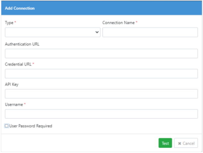

  2. Click Add Connection. The Add Connection page appears.
    Vault page
    Add Connection page
  3. Enter the field details.
    Field NameDescription
    Type*Select the security vault. For example, BeyondTrust.
    Note: The system administrator can assign multiple security vaults to a tenant.
    Connection Name*Enter a unique name for the vault connection.
    Authentication URLEnter the security vault's sign-in API URL. For example, BeyondTrust's sign-in API URL.
    Credential URL*Enter the security vault's credential API URL. For example, BeyondTrust's credential API URL.
    API KeyEnter the unique API key through which you will communicate with the security vault.
    Username*Enter your security vault's username.
    User Password RequiredSelect the checkbox if you want to sign in with your security vault's password. Else, clear the checkbox.
    The Password field is available, if you select the checkbox.
    Important:
    To allow password less sign in at BeyondTrust, ensure to clear the User Password Required checkbox under Configuration → API Registrations.
    PasswordEnter your security vault's password.
    *Indicates mandatory field.

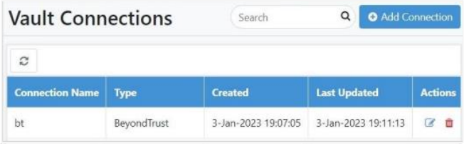

  4. Click Test. A message confirming that vault connection is established successfully appears.
    Vault page
    Vault connection established
In the Actions column:
  • To modify the vault connection details, click Edit.
  • To delete the vault connection details, click Delete.
