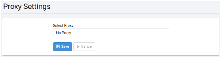

    Proxy: No Proxy​

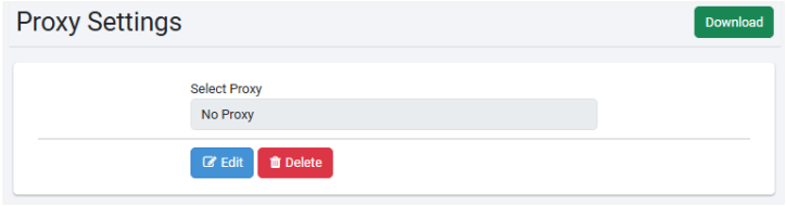

    After selecting No Proxy, click Save. The proxy setting is saved. The Proxy Settings page is refreshed, and you see the following view:
    Proxy Settings
    No Proxy settings saved

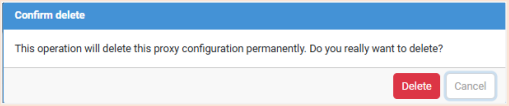

    • To change the selected proxy type, click Edit.
    • To delete the proxy setting, click Delete → Confirm delete dialog → click Delete.

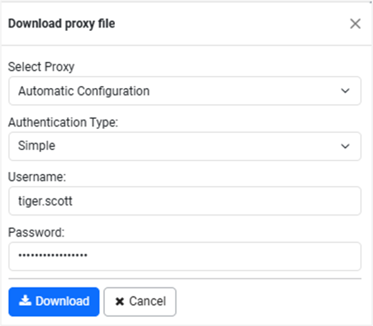

      Authentication Type: SimpleProxy Settings
      UsernameEnter the name of the user.
      PasswordEnter the password.

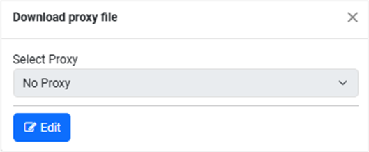

  1. On the Proxy Settings page, click Download. The Download proxy file dialog appears.
    Proxy Server
    The option to download the configuration file in unavailable for proxy type, No Proxy. Therefore, you will need to select another proxy.
  2. Click Edit and select another proxy type. The selected proxy type’s fields appear along with the download option.

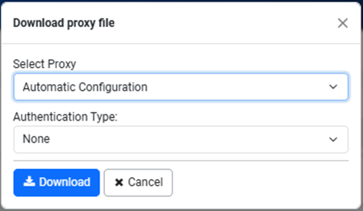

    Proxy Server
    Proxy type selection with download option
  3. Click Download. The <tenant name>-proxy-config.properties file is downloaded.
