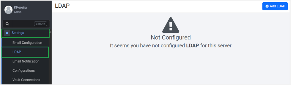

  1. In the menu, click Settings → LDAP. The LDAP page appears.
    LDAP page
    LDAP page

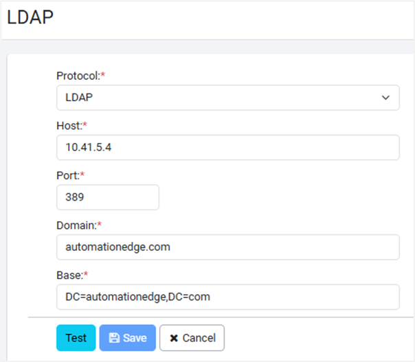

  2. Click Add LDAP. The LDAP details page appears.
    LDAP details
    LDAP details page
  3. Enter the LDAP field details, as required:
    FieldDescription
    Protocol*Select the protocol from the following options:
    • LDAP
    • LDAPS
    Host*Enter the host IP address. For example, 10.41.5.4.
    Port*Enter the port number to which to connect. For example, 389.
    Domain*Enter the domain name which you want to use. For example, automationedge.com.
    Base*The details appear as you enter your details in the Domain field. For example, Base:DC=automationedge,DC=local.
    *Indicates mandatory field.*
  4. Click Test. The domain connection is validated.
  5. Click Save. The LDAP configuration details are saved.

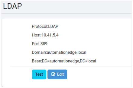

View LDAP configuration​
In the section, you’ll learn about viewing and modifying the LDAP details.
To view LDAP configurations:
    FieldDescription
    ProtocolDisplays the selected protocol.
    HostDisplays the host IP address.
    PortDisplays the port number.
    DomainDisplays the added domain.
    BaseDisplays the base details.
To modify the LDAP details, click Edit.
