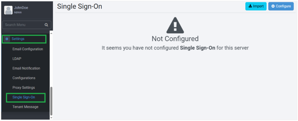

  1. In the menu, click Settings → Single Sign-On. The Single Sign-On page appears.
    SSO
    Single Sign-On page

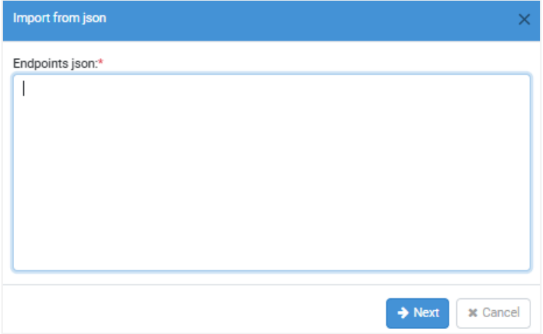

  2. Click Import. The Import from json dialog appears.
    Import from json
    Import from JSON dialog
  3. Paste the JSON in the Endpoints JSON field. See the following Endpoints JSON sample:
    Sample Endpoints JSON
    {"issuer":"https://dev-371272.okta.com/oauth2/default","authorization_endpoint":"https://dev-371272.okta.com/oauth2/default/v1/authorize","token_endpoint":"https:/ /dev-371272.okta.com/oauth2/default/v1/token","registration_endpoint":"http s://dev-371272.okta.com/oauth2/v1/clients","jwks_uri":"https://dev-371272.okta.com/oauth2/default/v1/keys","response_types_supported":["c ode","token","id_token","code id_token","code token","id_token token","code id_token token"],"response_modes_supported":["query","fragment","form_post","ok ta_post_message"],"grant_types_supported":["authorization_code","impli cit","refresh_token","password","client_credentials"],"subject_types_s upported":["public"],"scopes_supported":["OpenID Connect","profile","email","address","phone","offline_access"],"token_ endpoint_auth_methods_supported":["client_secret_basic","client_secret _post","client_secret_jwt","private_key_jwt","none"],"claims_supported ":["ver","jti","iss","aud","iat","exp","cid","uid","scp","sub"],"code_ challenge_methods_supported":["S256"],"introspection_endpoint":"https: //dev-371272.okta.com/oauth2/default/v1/introspect","introspection_endpoint_ auth_methods_supported":["client_secret_basic","client_secret_post","c lient_secret_jwt","private_key_jwt","none"],"revocation_endpoint":"htt ps://dev-371272.okta.com/oauth2/default/v1/revoke","revocation_endpoint_auth_me thods_supported":["client_secret_basic","client_secret_post","client_s ecret_jwt","private_key_jwt","none"],"end_session_endpoint":"https://dev-371272.okta.com/oauth2/default/v1/logout","request_parameter_supported ":true,"request_object_signing_alg_values_supported":["HS256","HS384", "HS512","RS256","RS384","RS512","ES256","ES384","ES512"]}

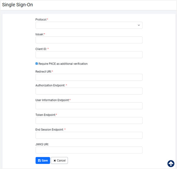

  1. Click Next. The Single Sign-On page appears with the endpoint details in the respective fields.
    Single Sign-On
    Single Sign-On endpoint details
    • Ensure all mandatory details are filled in the page. For field explanation, see Configure SSO using Configure option.
    • In case of Okta for Web application, Client Secret field is mandatory.
    • Keycloak supports OpenID Connect (OIDC) and SAML protocol.
    • For details on how to fetch configuration values in Okta, Keycloak, and AFDS, see Appendix: About SSO Identity Providers.
  2. Click Save. The details are saved.

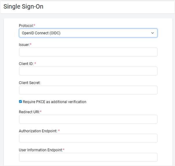

  2. Click Configure. The Single Sign-On fields appear.
    Single Sign-On
    Single Sign-On configuration fields
    Protocol*Select the Single Sign-On protocol from the list. For example, select OpenID Connect. The available options are:
    - None (SSO configuration cannot be saved with None Protocol)
    - OpenID Connect
    - SAML 2.0
    Issuer*Enter the Identity Provider base URL. For example, https://dev-371272.okta.com/oauth2/default in case of Okta;
    Get the URL from the Endpoints URL or Identity Provider portal.
    Client ID*Enter the public identifier for apps.
    Client SecretEnter the password. The password is known only to the application and the authorization server.
    Require PKCE as additional verificationSelect the checkbox if you want additional verification when signing in to the application.
    Redirect URI*Enter the URL which your web application must host so that Identity Provider sends information to when a user signs in. the Redirect URL must be an absolute URI, that is, https://host:port/aeui/.
    Redirect URL in the AE application’s SSO configuration page must be the same as redirect_uri in Identity Provider portal.
    Note: SSO authentication is supported only for secure sites (HTTPS), either with a domain name or IP address.
    For example, https://mydomain:8443/aeui or https://10.51.4.161:8443/aeui
    An HTTPS environment in IE11, Chrome browser and Firefox support SSO functionality.
    Authorization Endpoint*Enter the Identity Provider Authorization Endpoint in the form of a URL. For example, in Okta - https://dev-371272.okta.com/oauth2/default/v1/authorize.
    IDP generates Authorized Code and sends it to the AutomationEdge server.
    User Information Endpoint*Enter the endpoint provided by IDP to retrieve user information. If the endpoint is missing from the IDP JSON then Claims needs to be added manually to the IDP.
    Token Endpoint*Enter the token endpoint. The token endpoint is an IDP URL containing the Token parameter, which AE can use.
    Steps to enter the token endpoint:
    1. AE server uses the Authorized Code from Authorization Endpoint to request Token from IDP.
    2. Token Endpoint, for example, https://dev-371272.okta.com/oauth2/default/v1/token uses the Authorized Code sent back from AE server, generates Token and sends the Token to AutomationEdge Server.
    End Session Endpoint*Enter the endpoint to logout from IDP. For example, https://dev-371272.okta.com/oauth2/default/v1/logout.
    JWKS URIDisplays the URL that is used to verify the token received from IDP.
    *Indicates mandatory field.
    • You may obtain the Identity Provider authorization endpoint, Redirect URL and Client ID from the configurations in the Identity Provider.
  4. Click Save. The SSO configuration is saved successfully.

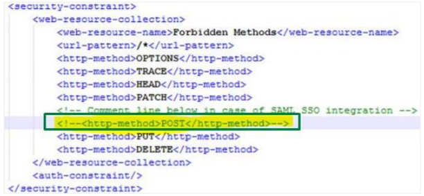

Make some changes in the webapps aeui folder. If we are using the SAML protocol, we need to comment on the POST request.
To comment the POST statement in the file:
  1. Go to Tomcat home/Webapps/aeui/WEB-INF web.xml.
  2. Open web.xml. Search for and comment the following in the file <http-method>POST</http-method>. For details, see the following screenshot:
    web.xml file
    web.xml file with POST statement

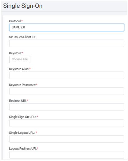

    SSO details
    SAML Single Sign-On fields
    Protocol*The Single Sign-On protocols supported are:
    - OpenID Connect
    - SAML 2.0
    Select SAML 2.0
    SP Issuer/Client IDEnter the SP Issuer value for Okta.
    For Keycloak/ADFS, enter the Client ID.
    Keystore*Select and upload the Keystore file, .jks.
    Through the field you will share public and private keys with AE, which is for xml signature verification. Upload the Keystore file (.jks) here; it is mandatory.
    Keystore Alias*Enter the alias you provided while generating Keystore.
    Keystore Password*Enter the password. The password is known only to the application and the authorization server.
    Redirect URL*Enter the URL which your web application must host so that Identity Provider sends information to when a user signs in. the Redirect URL must be an absolute URI, that is, https://host:port/aeui/.
    An HTTPS environment for IE11, Chrome browser and Firefox support SSO functionality.
    Single Sign-On URL*Copy and paste the Identity Provider Single Sign-On URL from the IDP site.
    Single Logout URL*Copy and paste Identity Provider Single Logout URL from the IDP site.
    Logout Redirect URL*Enter the logout redirect URL. For example, https://mydomain:8443/aeui/logout.jsp or https://10.51.4.161:8443/aeui/logout.jsp.
    On logout from the SSO application, you will log out of the application as well as IDP.
    *Indicates mandatory fields.
