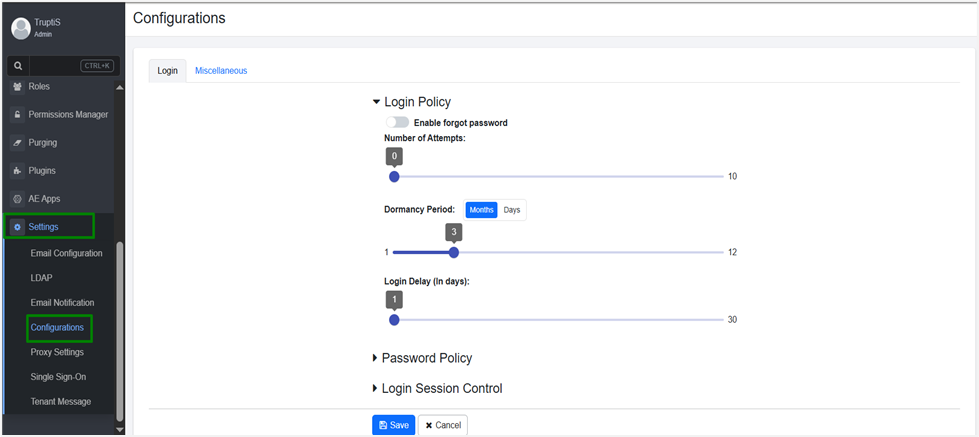

To modify the Login configuration details:
  1. In the menu, click Settings → Configurations. The Configurations page appears and has two tabs Login and Miscellaneous.
  2. Click Login Policy and toggle the Enable forgot password switch to enable user to reset the forgotten password. And, then set the following details:

    Enable forgot passwordToggle the switch to allow users to reset forgotten passwords, if required.
    Number of AttemptsDrag the switch between zero to ten (0-10) and set the number of attempts to sign-in to the application.
    The default attempt limit is 0, that is, there is no limit on the number of wrong password attempts.
    The user is notified of the remaining attempts whenever they log in with the wrong password. Once the user reaches the unsuccessful login attempt limit the user account is locked.
    The locked user account can be unlocked only by the Admin, by setting the new password. AutomationEdge sends the new password to the user email if:
    - User registration has an email Id.
    - SMTP configuration is available for the tenant.
    - Email Notification is enabled for password change.
    Else, the user needs to contact the Admin.
    Note: NATIVE users need to change the password after the user is unlocked. However, the LDAP users need not reset the password.
    Dormancy Period (In months)If an account has had no activity for a long period, then the state of the account changes to Dormant. The dormancy period helps identify inactive users or processes to improve security, optimize resources, and ensure compliance.
    You can configure the dormancy period in days or months, which allows flexibility based on business needs.
    To set the dormancy period:
    - If Months is selected, drag the slider between 1 and 12.
    - If Days is selected, drag the slider between 1 and 365.
    The minimum period you can set is 1 day.
    User accounts are marked Dormant during the nightly job.
    Note: • User accounts are marked Dormant during the nightly job.
    • An Admin can change the state by enabling or disabling it, or it is automatically disabled.
    Login delays (In days)When a locked or disabled or dormant user account is enabled, the user needs to log on at the earliest so that the user state changes to Active.
    To set the period, drag the switch between one to thirty (1-30). The minimum setting for login is one day.
    The default login delay is one day. Therefore, the user should log in to the account on the same day else the account is automatically disabled again. However, if the configuration is changed the user needs to log on to the application within the set period so that the user is not disabled again.

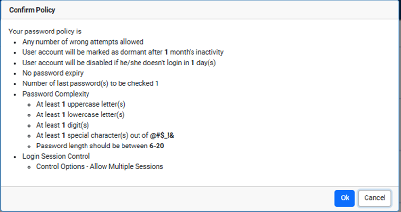

  5. Click Save. The details are saved, and the Confirm Policy dialog appears.
    Confirm policy
  6. Click Ok. The login policy details are saved.

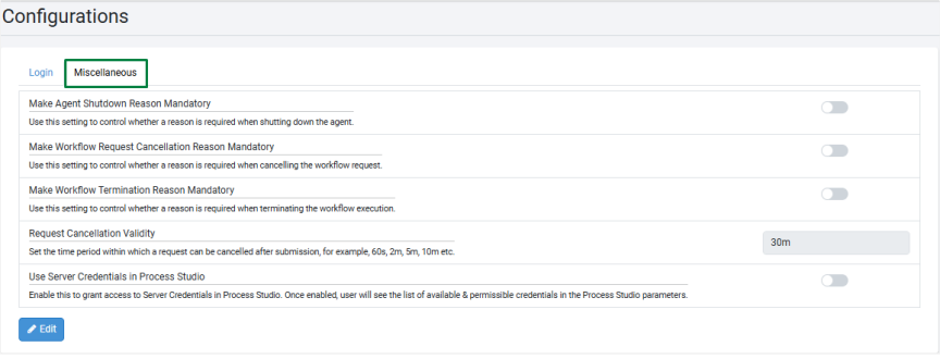

To modify the Miscellaneous details:
  2. Click the Miscellaneous tab. The details page appears.
    Miscellaneous tab
    Miscellaneous tab
  3. Click Edit. Modify the details, as required:
    Make Agent Shutdown Reason MandatoryToggle the switch if you want to control whether a reason is required when shutting down the agent.
    Make Workflow Request Cancellation Reason MandatoryToggle the switch to control whether a reason is required when cancelling the workflow request.
    Make Workflow Termination Reason MandatoryToggle the switch to control whether a reason is required when terminating the workflow execution.
    Request Cancellation ValidityEnter the time within which a request can be cancelled after submission. For example, 60s, 2m, 5m, 10m, and so on.
    Use Server Credentials in Process StudioToggle the switch to grant access to AE Server Credentials in the Process Studio. For details, see the Process Studio User’s guide.

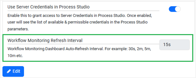

    Workflow Monitoring Refresh IntervalEnter the time in minutes to refresh the workflow monitoring view automatically.
    Miscellaneous tab
    Notes:
    - The minimum time you can configure for auto-refreshing the view is one (1) minute.
    - The field is available only if the Workflow Monitoring feature is enabled.
