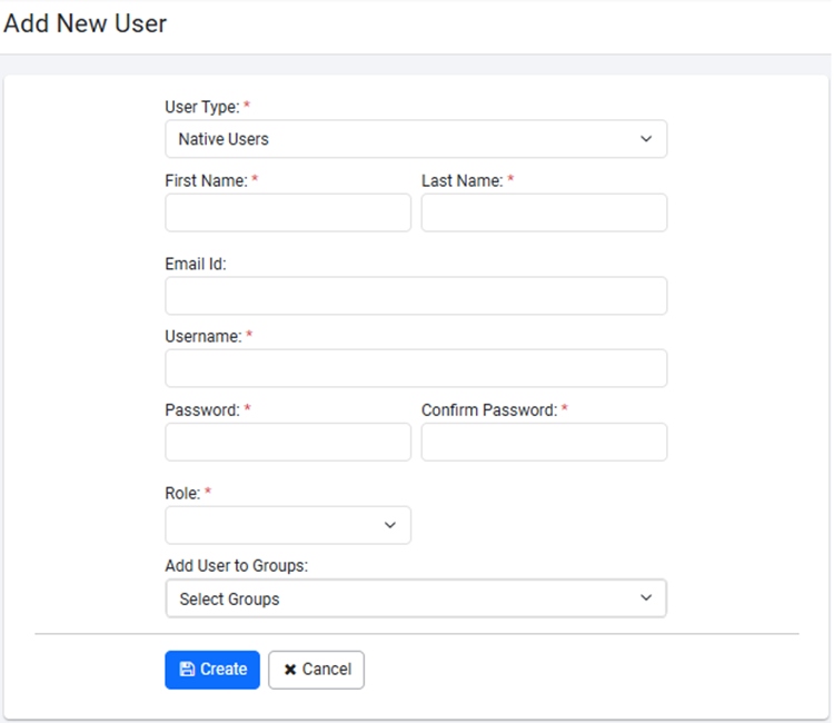

To add a new user:
In the menu, click Users → User List. The Tenant Users page appears.
Click Add New. The Add New User page appears.
Add New User page -

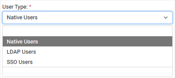

In the User Type* field, select the type of user you want to add.
Add New User page - User Type list

| Field name | Description |
| First Name* | Enter the first name of the user. |
| Last Name* | Enter a last name of the user. |
| Email Id | Enter the user’s email ID. |
| Send verification link over email | Select the checkbox to send a verification email link to the user. Users can verify the sign in details through the link, which will activate their user account. Users will receive message confirming that the verification is successful. Users can also reset their password after they activate their account. Important: To use the field, user must set the email configuration details in Email Configuration. Note: - The field is available only if you select Native User in the User Type field and specify the email address of the user in Email Id field. The link is active for 24 hours only. You can also send mail to users to reset their forgotten password. - Ensure that the proper URL is added to the ae.portal.baseURL property in the ae.properties file. Reach out to your support team if you face any issues when accessing the URL. |
| Username* | Enter the login name of the user. |
| Password* | Enter the user’s login password. |
| Confirm Password* | Re-enter the user’s login password. |
| Role* | Select the role you want to assign to the system user. Select from: - Admin - User Admin - Workflow Admin - Agent Admin - Activity Monitor - User |
| Add User to Groups | Select the group to which you want to add the user. NOTES: - The field is available only if you select User as the role in the Role field. - You can assign the user to one or multiple groups. |
*Indicates mandatory field.
Important: For Native Users, change the password after first login.

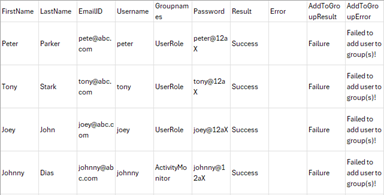

Upload users

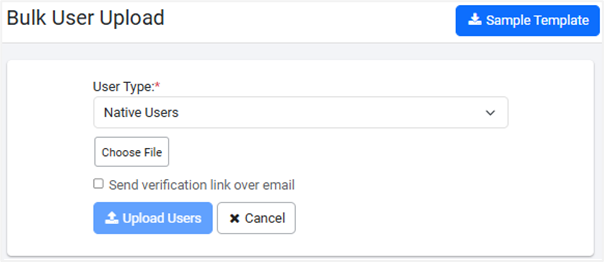

Use the Upload Users feature to create users in bulk at a time. You can only create users with role User using the feature.
To upload users in bulk:
On the page click
, and then click Upload Users. The Bulk Users Upload page appears.
Bulk User Upload
Select the User Type* from Native Users or LDAP Users or SSO Users.
important- SSO Users option is available if you have completed SSO setup.
- You can add LDAP users only if the LDAP configuration is complete.
Click Sample Template. A sample template file is downloaded.
User Type: Native Users Bulk Upload template
Note- Template for Native users has the following columns: first name, last name, email, username, and group names.
- Template for LDAP users has only username and group names columns.
- Template for SSO users has username, idp username, and group names columns.

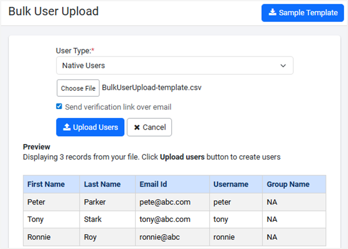

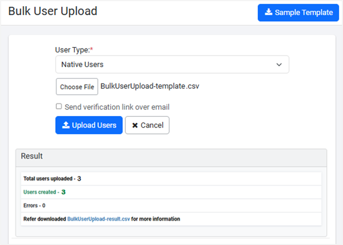

Edit the downloaded template and save the details. Go to the Bulk User Upload page in the application.
i. On the Bulk User Upload page, click Choose File. In the File Explorer dialog, select the template to upload.
Selected bulk user templateii. Select the Send verification link over email checkbox, if required. The users will receive an email notification after the details are uploaded.
NoteFor users to receive the email notification you must ensure that the email server is configured.
iii. View the preview details of the template you want to upload and then click Upload Users. In the Result section, the upload details appear.
Bulk User Upload page view after uploading the templateNoteTo see the results of the bulk upload, view the BulkUseUpload-result file that is automatically downloaded to the system.
Bulk user upload result viewYou can view the details on the Tenant Users page.

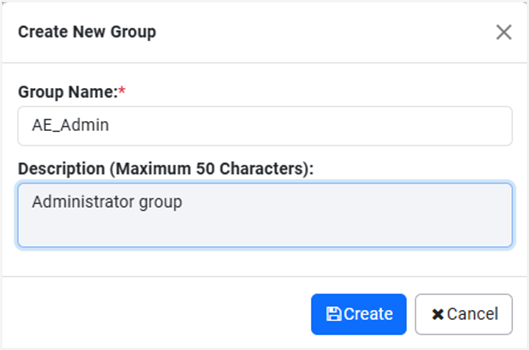

Click Add New. Create New Group dialog appears.
Create New Group page -
Enter the following field details:
Field name Description Group Name* Enter the name of the unique you want to create. Description (Maximum 50 Characters) Enter a description of the group that you want to create. *Indicates mandatory field.
Click Create. The details appear on the User Groups page.

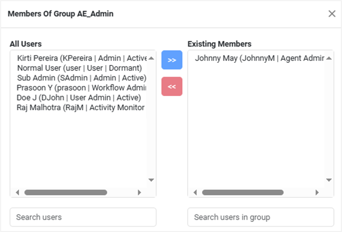

Add user to a group
You can add user to the groups, as required. There are two ways to add users to a user group:
- Create user groups first and then add multiple users through bulk upload. The users are added automatically to the respective group mentioned in the bulk upload file.
- Manually add users to the available user groups. The All Users dialog lists all users along with their status, except Sys Admins and deleted users.

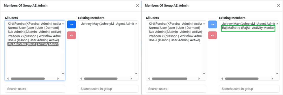

To add a user to a group:
In the menu, click Users → User Groups. The User Groups page appears.
In the Actions column, click
. The Members of Group (selected group) dialog appears with the list of users along with their role and status.
Members of Group dialog -
In the All Users list, select the user you want to add to the Existing Members list, and then click
. The user is added to the Existing Members list.
Members added to the list
In All Users, you can search for the user you want to add to the selected user group.
In Existing Members, you can search for the user you want in the group.
To remove a member from the group, select the member and click
. The member is removed from the Existing Members list and appears in the All Users list.

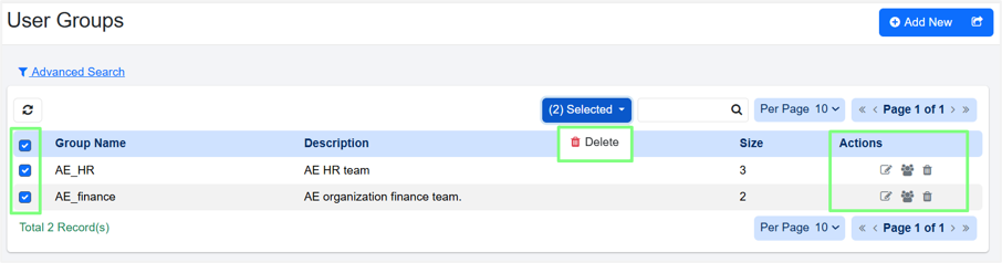

To delete one or multiple user groups:
- Select the checkbox in the Group Name column. The Selected tab appears with the count of selected groups.
User Group multiselect
- Click Delete to remove all the selected user group. The Confirm Workflows Deletion dialog appears.
Selected tab view
- In the Confirm User Groups Deletion dialog, click Delete. The Bulk Action Result dialog appears, indicating whether the user group deletion was successful or a failure.
- In the Bulk Action Result dialog, click Ok. The User Groups page refreshes and displays the updated user group list.

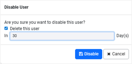

Disabled

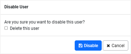

A user can be manually disabled from Active, Enabled, or Locked states. If a user is disabled, their schedules get automatically disabled. A display message to show this warning is shown in the confirmation box for disabling users. On login, a disabled user gives a generic error message.

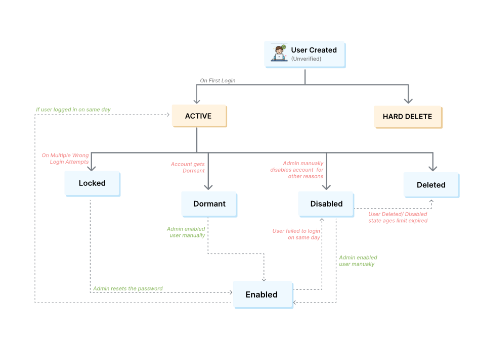

User states inter-relationships
The following screenshot depicts the inter-relationship between the user states:
User states inter-relationships representation
User state and login behavior

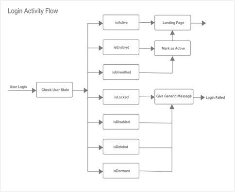

Additionally, to complement the previous User State interrelationship diagram, the following diagram illustrates the login behavior of users within various states. The following screenshot depicts the different user states:
User login activity
If user is in Active state, then after login, user goes to the AutomationEdge UI landing page.
If a user is in an Enabled or Unverified state, then after login, user account is marked as Active, and user goes to the AutomationEdge UI landing page.
If a user is in Locked, Disabled, Dormant, or Deleted state, then after login, a generic failure message appears.

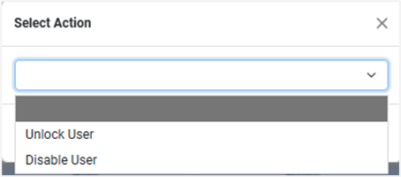

To change the state of any user, click the state link in the Status column complete the steps to change the user state.
Unlock user
You can unlock Admins and other tenant users.
To unlock a tenant user:
In the menu, click Users -> User List. The Tenant Users page appears.
In the Status column, click the LOCKED link corresponding to the tenant user you want to unlock. A Select Action dialog appears.
In the dialog, select Unlock User and then click Next. The Unlock User dialog appears.

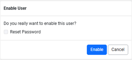

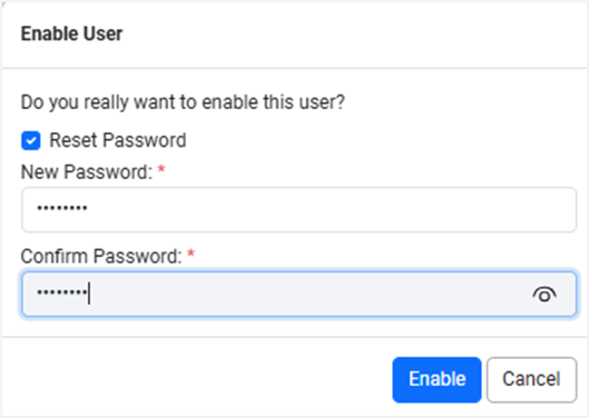

Enable user
You can enable dormant or disabled tenant users.
To enable a tenant user:

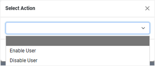

In the Status column, click the DORMANT Or DISABLED link corresponding to the tenant user you want to enable. A Select Action dialog appears.
In the dialog, select Enable User. The Enable User dialog appears.
