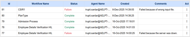

  • Add Comment: The option is available only for failed workflows. Click Add Comment to log remarks or notes. A maximum of 512 characters is allowed. The comment can be entered only once and cannot be edited after saving. Only Admin and Workflow Admin users can add comments to a failed workflow. The comments appear in a separate column on the Requests page and are also included in the CSV file downloaded from the same page. The field is displayed only when a comment has been added.

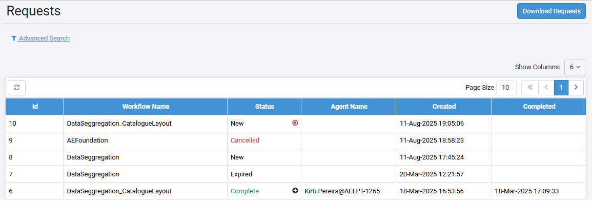

Cancel a new request
You can cancel a new request only before you log out of the instance.
To cancel a new request:
  1. Submit a new workflow execution request through Catalogue. The request appears in the Requests page with status New.

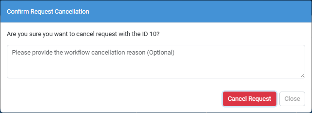

  2. Click Cancel. The Confirm Request Cancellation dialog appears.
    Cancel dialog

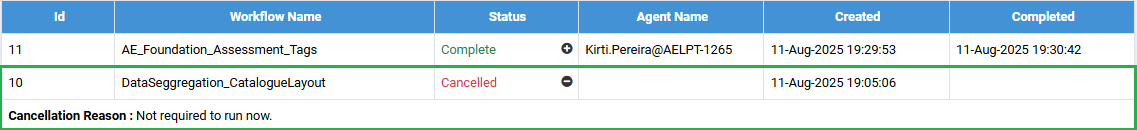

  3. Enter the reason for canceling the new request, and then click Cancel Request. The reason for canceling the request is saved.
    Cancel dialog
    Cancelled request on Requests page
