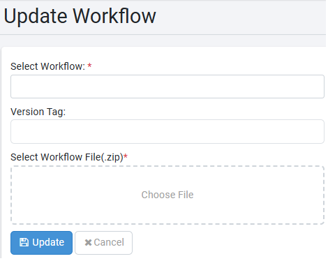

Use the feature to activate, edit, export, import, or update the workflows that are published.

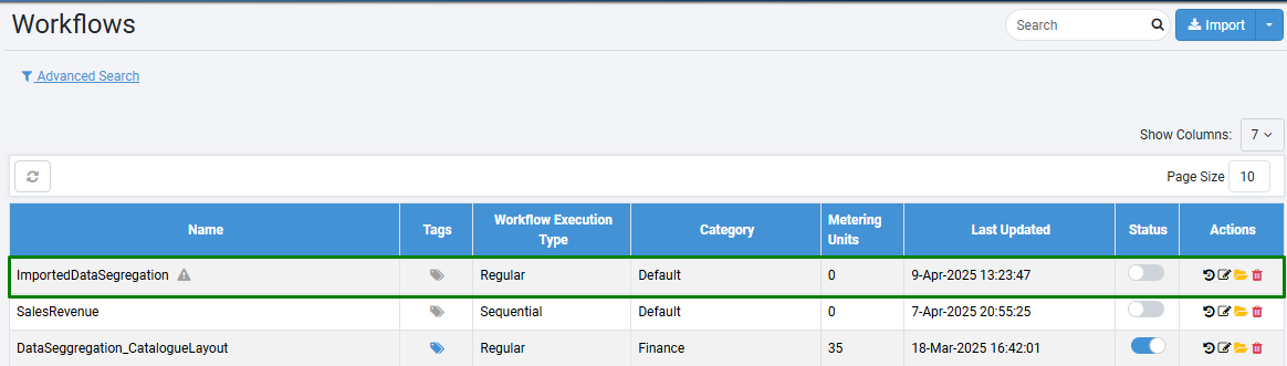

    StatusToggle the switch to activate or deactivate the workflow.
    • If there are any plugins that are not assigned, then a message listing the missing plugins appears. You can assign the missing plugins and activate the workflow.

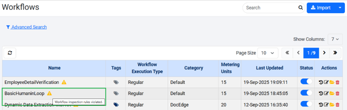

    • If a workflow is published with warnings, then it appears in the Workflows page as follows:
      Workflow
      Workflows published with warnings

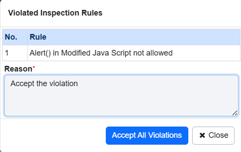

      Click the warning icon. The Violated Inspection Rules dialog appears.
      Workflow
      Enter a reason to accept the violation. The system stores the reason and adds it to the audit log description. The most recently added comment appears in the user interface for reference. Providing a reason ensures proper documentation for accepted violations.
      Click Accept All Violations. If you are using your own workflow, you cannot accept the violations. If the workflow was published by another user, you can accept the violations and use the workflow.
    • Click view reason to view the most recent reason for the violation.
  • When you view the Workflows page, you will only see the active (enabled) workflows, as the Status equal to Active filter is set by default.
  • Click Accept All Violations. If you are using your own workflow then you cannot accept the violations. However, if the workflow was published by another user, then you can accept the violations and use the workflow.

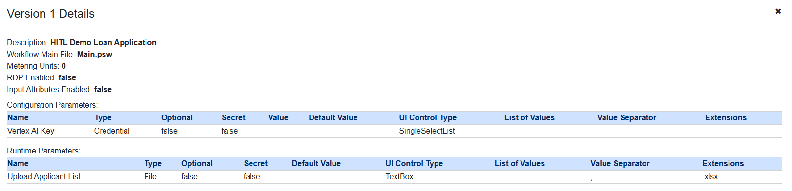

    • Click version history to view the workflow version history.

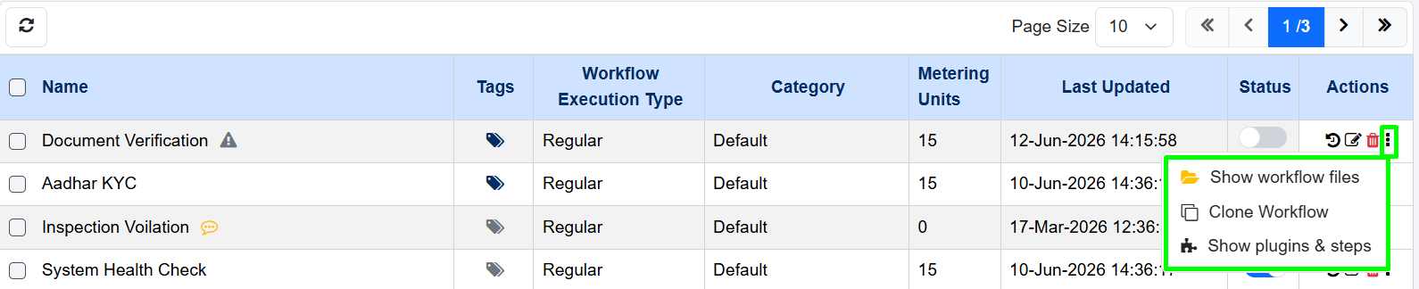

    • Click more actions, list of actions appears:
      More Actions menu
      More Actions menu
From the More Actions menu, you can:

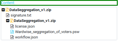

To view the workflow files
Click show workflow files to view the workflow files.
View of files in a workflow

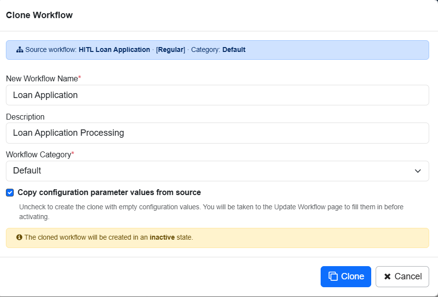

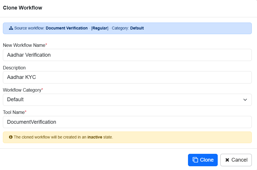

To clone a workflow
Cloning creates an independent copy of an existing workflow. The clone is fully separate from the source. The changes you make to the clone do not affect the original, and changes to the original do not affect the clone. Any files attached to the source workflow are copied into the clone as well.
Cloning is useful when you want to reuse a workflow that already works instead of building a new one from scratch. For example, suppose your Finance team has an approval workflow that's been running smoothly for months. HR now wants a similar one, with the configuration parameter values changed. Rather than editing the Finance workflow (and risking the production version), you can clone it, and update the configuration parameters — while the original keeps running untouched.
To clone a workflow:
  1. Click clone workflow. The Clone Workflow dialog appears.
  2. Enter a New Workflow Name and Description.
  3. Select a Workflow Category.
  4. (Optional step) Select Copy Configuration Parameter Values to retain the source workflow's configuration parameter values in the clone.
  5. Click Clone. You are redirected to the Edit Workflow page of the newly cloned workflow.

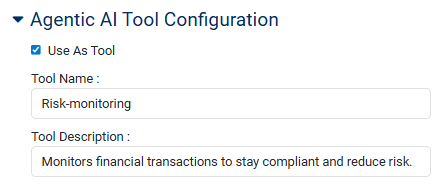

If the source workflow has Agentic AI Tool configurations, the Clone Workflow dialog also displays the Tool Name.
Clone Workflow dialog with Tool Name

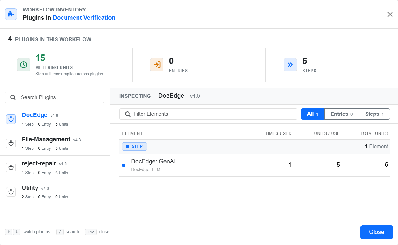

Show plugins and steps
Use the Workflow Inventory option to view all plugins, steps, and entries used in a workflow — without opening it in Process Studio. This option gives you a quick way to review what a workflow contains before you edit, clone, or troubleshoot it
Click show plugins and steps. The Workflow Inventory dialog appears.
Top Section
Three metric cards give an at-a-glance health check of the entire workflow.
MetricDescription
Metering UnitsTotal workflow consumption. For example, 15 units.
EntriesNumber of workflow entry points or triggers. For example, 0 entries.
StepsTotal number of workflow actions or steps. For example, 8 steps
Left Panel — Plugin List
Lists every plugin included in the workflow with quick-access stats.
ElementDescription
Search BoxFilter plugins by name to quickly locate a specific one.
Plugin Name & VersionEach entry shows the plugin name for example, DocEdge and its version for example, v4.0.
Per-plugin summary shows:
- Number of steps
- Number of entries
- Metering units
Right Panel — Plugin Inspector
Explore the selected plugin to see its individual elements and their unit costs.
ElementDescription
Inspecting HeaderDisplays the currently selected plugin name and version.
Filter Elements BoxSearch within the plugin's elements list.
All / Entries / Steps tabsToggle to view all elements, or filter to only Entries or only Steps.
Element NameName and type identifier of each step or entry element. For example, DocEdge: GenAI.
Times UsedIndicates how many times this element is invoked within the workflow.
Units / UseMetering units charged per single invocation of this element.
Total UnitsTotal metering units consumed = Times Used × Units per Use.

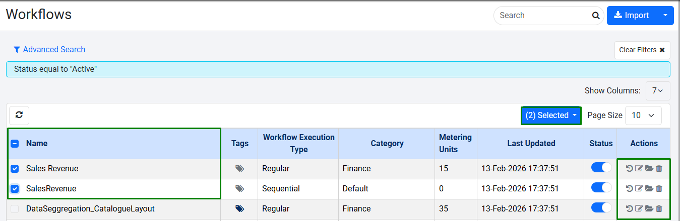

To enable or disable or delete one or multiple workflows:
  1. Select the checkbox in the Name column. The Selected tab appears with the count of selected workflows.
    Workflows page Selected option
    Workflows page: Selected option
    The options in the Actions column become inactive.
  2. Click Selected. The following options are available:

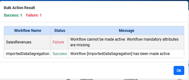

      In the Confirm Workflows enable dialog, click Enable. The Bulk Action Result dialog appears, which displays if activation of each workflow was a success or a failure and the reason for it.
      In the Bulk Action Result dialog, click Ok. The Workflows page displays the updated status of the workflows.

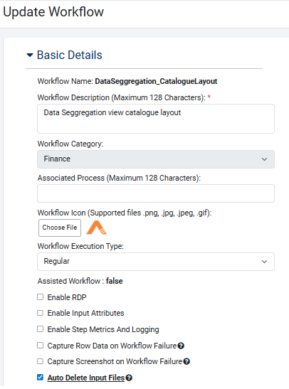

Edit workflow configuration
You can edit the workflow configuration, if required.
To edit workflow configuration:
  1. In the Actions column, click edit. The Update Workflow page appears.
    Workflow
  2. Modify the following field details:
    Basic Details
    Workflow Name*Displays the name of the workflow.
    Workflow Description*Modify the workflow description.
    Workflow CategoryDisplays the category to which the workflow belongs.
    Associated Process (Maximum 128 characters)Modify or enter the name of the process you want to associate with the workflow.
    Workflow IconClick Choose File and browse and select the image for the workflow.
    Click remove icon to remove the custom icon added to the workflow. When the custom icon is removed, the system automatically applies the default AutomationEdge icon AE default icon to the workflow.
    Workflow Execution TypeSelect the type of execution you want to assign to the workflow. Available execution types are:

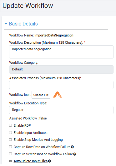

    Enable Input AttributesEnable checkbox to display Additional Input Attributes in the Parameter Form displayed during workflow execution from AutomationEdge Catalogue. These are to capture additional information.
    Enable Step Metrics And LoggingSelect the checkbox if you want the logging details of the workflow or process and step or entry to be made available in the Request page.
    Enable Workflow MonitoringSelect the checkbox if you want to enable the workflow monitoring feature.
    Enable Workflow CheckpointingSelect the checkbox if you want to activate the workflow checkpointing feature.
    For details, see Workflow Checkpointing
    Push Metrics IntervalSelect the duration after which the data is pushed into metrics and the Workflow Monitoring table or graph view is refreshed. The interval duration can be 15 seconds to 10 minutes.
    Capture Row Data on Workflow FailureSelect the checkbox if you want to view the workflow failure details.
    Capture Screenshot on Workflow FailureSelect the checkbox if you want to view the screenshot of the error.
    Auto Delete Input FilesSelect the checkbox if you want to automatically delete the input files after execution of workflow.
    If the workflow includes the Reject/Repair step that uses the Document parameter name option, then after publishing and before running the workflow from the agent make sure that you clear the Auto Delete Input Files option in the Workflow Configuration page.
    If the Auto Delete Input Files setting is enabled, the request input files are deleted from the server storage (AE_HOME) after a successful execution. If the execution fails, the files are kept until the restart validity of request, so that they can be used again after restart. After this period, a midnight job deletes the files.

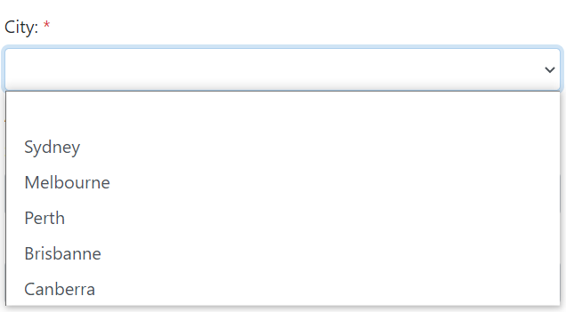

  • Combo Box (List)
    On AEUI, select a single Checkbox or enter a custom value in the field.

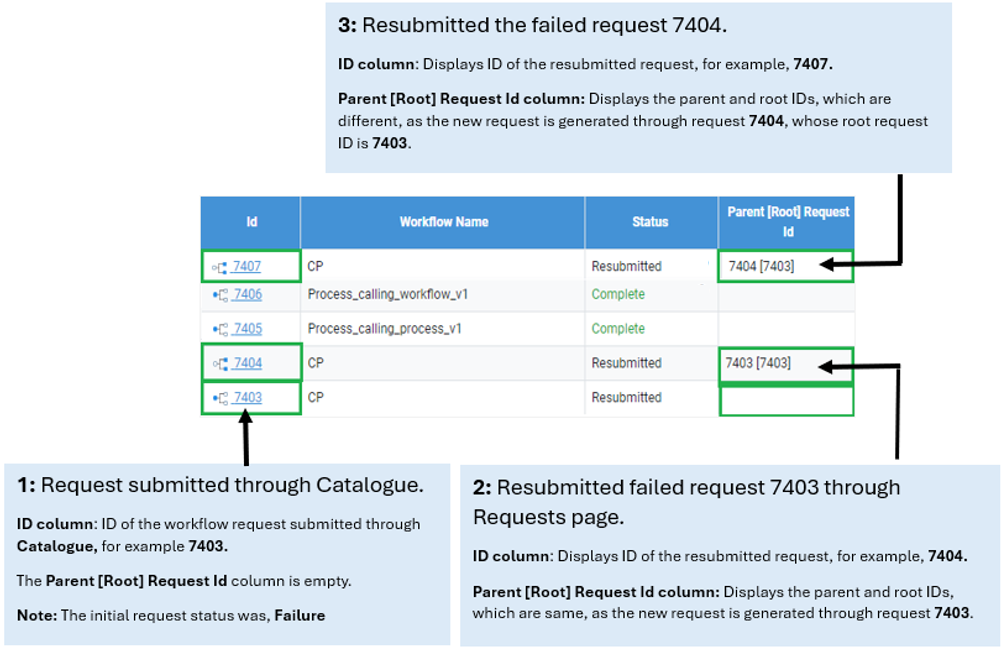

  4. Generate the workflow request through Catalogue and then go to Requests → Request List. The Requests page appears.
  5. In the Requests page, view the status of the request. If the request has failed, then you will see the following:
    Workflow
    Request status view
    Id: If the Workflow Monitoring feature is enabled the request ID appears with a link, for example, request ID link. Else, the request ID appears as plain text, for example, request ID plain.
    To directly go to table view in the Workflow Execution Metrics page, click the request ID link in the Requests page. For example, click request ID link. And, to go directly to graph view, click graph view. For details, see Workflow Monitoring.
    Status: If the request fails, then in the Act column click action and you can restart or resubmit the request OR add a comment or retrieve execution logs. For other request statuses, you can only retrieve execution logs.
    Parent [Root] Request Id: The column displays the parent and root request Id. The Parent Request Id is the request ID through which you have resubmitted the request, and the Root Request Id is the request ID of the first request that was submitted.
    For understanding the column, see the following image:
    Resubmission of requests
  6. In the Act column, click action and select resume option. The process opens in Graph view.

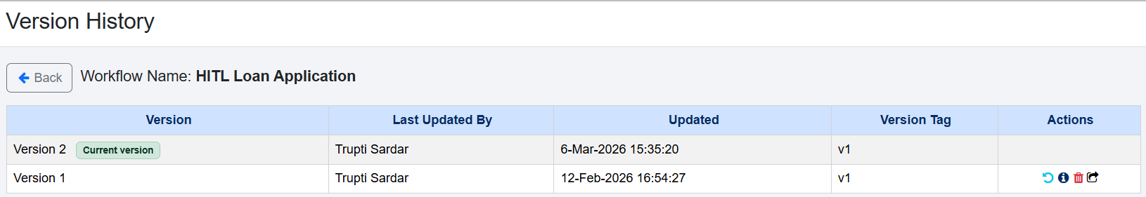

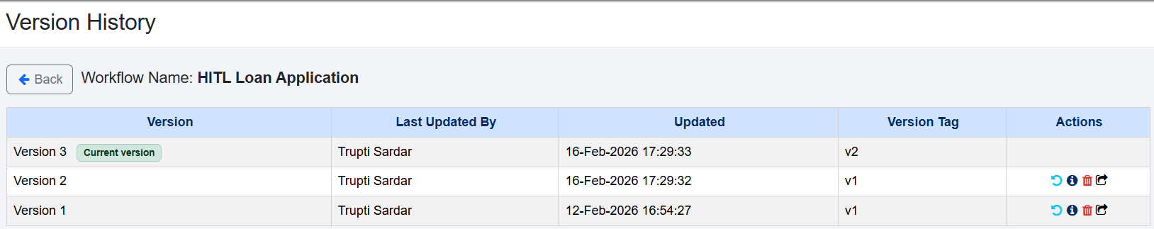

You can view the workflow versions through the Actions column.
  • You can maintain a configurable number of workflow versions in AEUI, which includes one active version and a number (for example, 3) of archival versions.
  • The most recently updated version will be the default working workflow version. For example, if Version 3 is the most recently updated version, then it will be shown as the Current version of workflow, which will be in use.
To view the version details:
  1. In the menu, click Workflows → Workflow List page, and then in the Actions column click version history next to the workflow. The Version History page appears.
    Workflow
  2. View the following details:
    VersionDisplays the available versions of the workflow.
    Last Updated ByDisplays the user who last updated the workflow version.
    UpdatedDisplays the date when the version was uploaded.
    Version TagDisplays the version tag, if any.
  3. In the Actions column:
    The Actions column options are unavailable for the current version of the workflow.
    • Click change version to change the version.
      Before changing the version, you must make the workflow inactive.
    • Click view details to view the details of the version.
      Workflow
      Version Details view
    • Click delete to delete the workflow.
    • Click export to export the workflow as a zip.
To maintain workflow versions:
  • In the Process Studio, update a workflow, for example add or delete a step, or change names of files or step name, using the Publish → Update option.
  • To maintain a version, ensure that the workflow also exists on the AE UI.
  1. In the menu, click Workflows → Workflow List. The Workflows page appears.
  2. In the Actions column, click version history. The Version History page appears.
  3. In the page, view the versions of the workflow. The recently updated version will have a Current version label against it.
  • Whenever the workflow is updated, from Process Studio → Publish → Update or from AEUI → Workflows → Update option (Update option), the version is incremented. The updated version becomes the active workflow.
  • Enter the following field details:
    • Select Workflow: Select the updated workflow you want to upload. The field is mandatory.
    • Version Tag: Provide a unique version number to the workflow, which will enable ease of analysis and / or restoration, if required.
    • Select Workflow File(zip): Choose the zip file of the selected workflow. The field is mandatory.
      Workflow
      Update Workflow dialog
    • If there are three versions of a workflow already available, and you update the workflow to the AEUI Server then the first version is automatically deleted from the server.
      For example, there are Version 1, Version 2, and Version 3 workflow on the AEUI Server, and you add Version 4 to it, then Version 1 gets deleted automatically from the server.
Restore listed version of workflow as the current version
You can restore any of the other two versions as your current version, if required.
You can restore a version only if the status of the workflow is Inactive.
To restore listed version of workflow as the current version:
  2. On the page, in the Actions column click version history next to the workflow. The Version History page appears.
    Workflow
  3. On the page, in the Actions column click restore. A message asking you to confirm restoration of the selected version appears.
  4. Click Restore. The selected version is now the current version.
    Workflow
    Version restore
When you restore the workflow to a specific version, for example, Version x, then all the versions that were created after Version x are automatically deleted after its restoration. For example, if you select to restore workflow Version 1 as the current version then, both, Version 2 and Version 3, are automatically deleted.

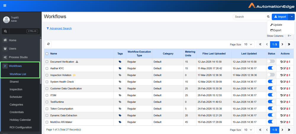

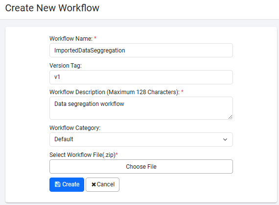

  2. On the page, click Import. The Create New Workflow page appears.
    Workflow Name *Enter the name of the workflow.
    Version TagEnter the version tag. For example, 1.0.
    Workflow Description (Maximum 128 Characters) *Enter a description for the workflow.
    Workflow CategorySelect the category to which you want to upload the workflow.
    Select Workflow File(.zip) *Click, browse, and select the zipped workflow file that you want to import.

  5. Click Create. The workflow is imported, and Update Workflow page appears.
    For field details, see Edit workflow configuration.
  6. Update the workflow details and click Save. The workflow appears on the Workflows page.

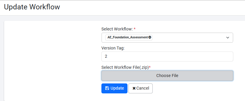

  2. On the page, click action menu and then select Update. The Update Workflow page appears.
    Select Workflow *Select the workflow that you want to update.
    • Indicates mandatory field.
  4. Click Update. The workflow is updated and appears in the Workflows page.
