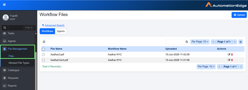

  1. In the menu, click File Management → Workflow Files. The Workflow Files page appears.
alt text
Workflow Files page

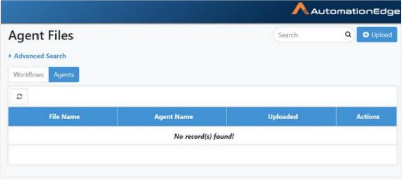

  1. In the menu, click File Management → Workflow Files. Click the Agents tab, the Agent Files page appears.
    FM page
    Agent Files page

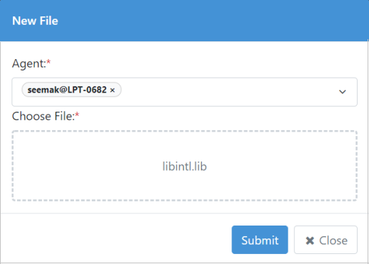

  2. In the Agents tab, click Upload. The New File dialog appears.
    FM page
    New File dialog for Agent
  3. In the Agent field, select the agent from the list. The name of the selected agent appears in the box.
  4. Click in Choose File and browse for the file you want to upload. Click Submit. The uploaded file appears in the Agent Files list.

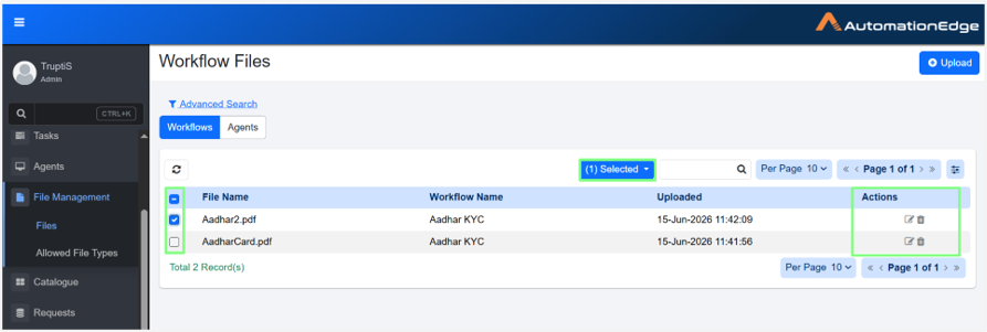

To delete one or multiple workflow files:
  1. Select the checkbox in the File Name column. The Selected tab appears with the count of selected files selected.
alt text
Workflow files multiselect
The options in the Actions column become inactive.
  1. Click Delete to remove all the selected workflow files. The Confirm Files deletion dialog appears.

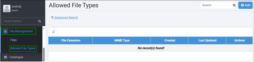

  1. In the menu, click File Management → Allowed File Types. The Allowed File Types page appears.
    FM page

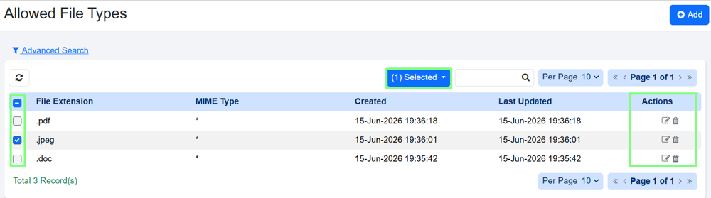

  1. Select the checkbox in the File Extension column. The Selected tab appears with the count of selected files selected.
alt text
Allowed file Types multiselect
  1. Click Delete to remove all the selected files extension. The Confirm File Types deletion dialog appears.
