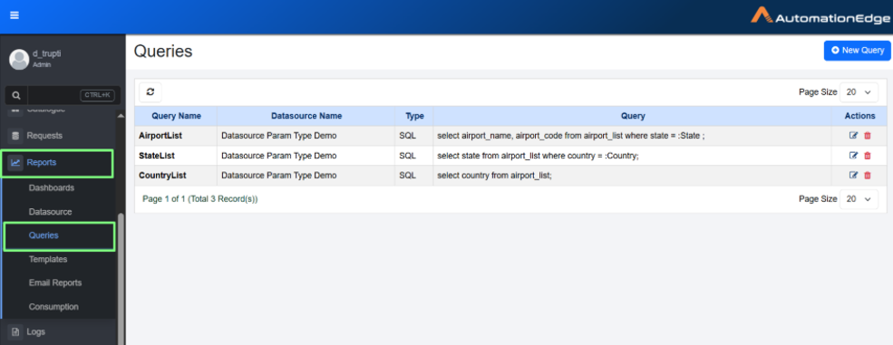

  1. In the menu, click Reports → Queries. The Queries page appear.
Queries page

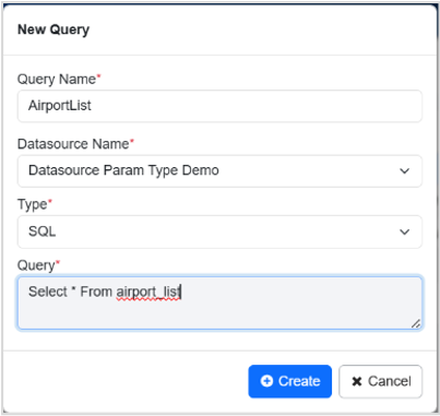

  1. Click New Query. The New Query dialog appears.
New Query dialog
  1. Enter the following details:
Query Name*Enter the name of the query you want to create.
Datasource Name*Select the datasource name from the list. For detail about how to create datasource, see Create new datasource
Type*Select the type of query from the list. Currently support is available for SQL only.
Query*Enter an SQL query to fetch values for the input field.

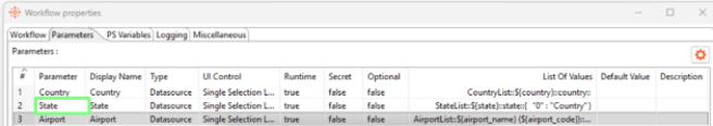

The query must follow JDBC syntax and use named parameters that are defined in the Process Studio -> Workflow Properties tab.
Specify each parameter in the query using the :parameterName format. alt text
For example: Select airport_name, airport_code from airport_list where state = :State
* indicates mandatory field.
  1. Click Create. A Query created successfully message appears.

  • You can use the queries created through AEUI in the Workflow properties → Parameters tab of the Process Studio. For details, see the Create a workflow section in AutomationEdge Process Studio User’s Guide.
