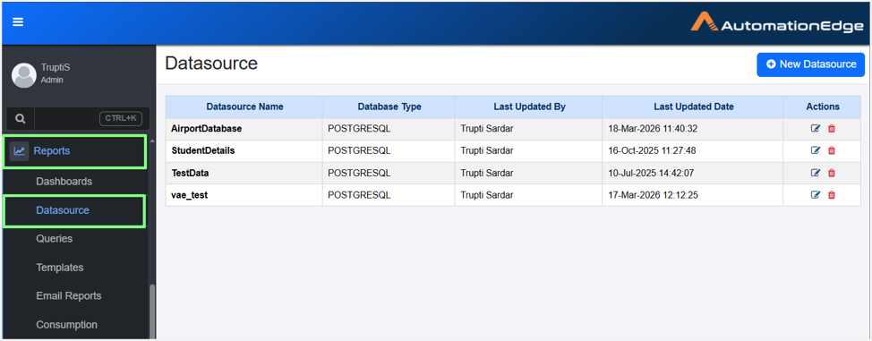

  1. In the menu, click Reports → Datasource. The Datasource page appears.
    reports
    Datasource page

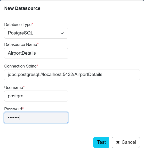

  2. Click New Datasource. The New Datasource dialog appears.
    reports
    Datasource Name *Enter a name for the datasource.
    Database Type *Select the type of database you want to create. The available options are:
    - PostgreSQL
    - MS-SQL
    - Oracle
    Last Updated ByDisplays the First name and Last name of the person who last updated the data source.
    Last Updated DateDisplays the date and time when the data source was last updated.
    Connection String *Enter a JDBC connection string to the database. For example, jdbc:postgresql://localhost:5433/vae, assuming you have the database on the same machine as the AutomationEdge server, else replace with the IP address.
    Username *Enter the name of the user with which you’ll connect with the datasource.
    Password *Enter the password to connect with the datasource.
    *Indicates mandatory field.
  4. Click Test. The database connection is validated and the option to Create database appears.

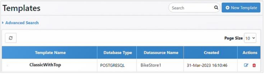

  1. In the menu, click Reports → Template. The Templates page appears.
    reports
    Reports Templates page
  2. View the following fields:
    Template NameDisplays the name of the template you want to create.
    Database TypeDisplays the type of database used for the template.
    Datasource NameDisplays the datasource name used for the template.
    CreatedDisplays date and time when the template was created.
    ActionsClick edit to edit the template.
    Click export to export the report template as a JSON format file. Confirm Password Inclusion dialog appears. Click yes if you want to export report template with Password.
    Click delete to delete the report template. Confirm Delete dialog appears. If you select Force delete it will remove all associated user and group permissions for the selected report template and will remove any reports created from report template that have been added to dashboards while deleting the template.
    Delete report template

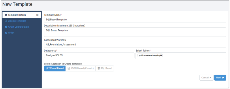

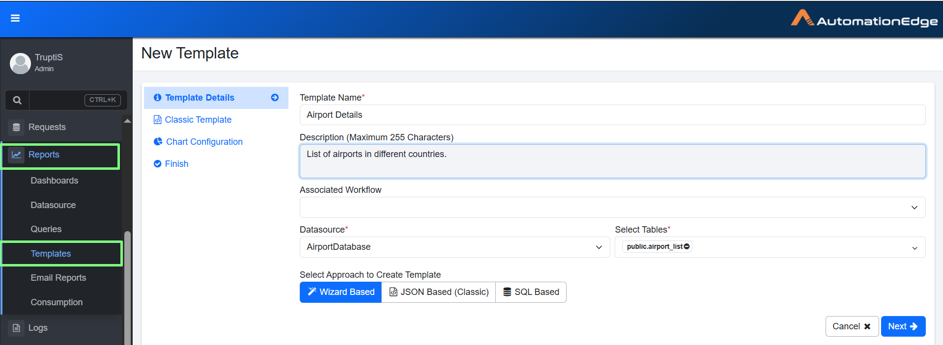

  3. Click New Template. The New Template page appears.
    reports
    New Template page
  4. Enter the following field details:
    Template Name *Enter the name of the template you want to create.
    Description (Maximum 255 Characters)Enter a description of the template.
    Associated workflowSelect an associated workflow. If selected, only users with permission to the workflow will have access to the template, and the report will be specifically for data of that workflow.
    Datasource *Select the datasource from the list.
    Note: To get a list of tables, click Fetch Table Lists, which is available only after you select the data source. However, use the table details only for creating the Structured Query Template.
    *Indicates mandatory fields.

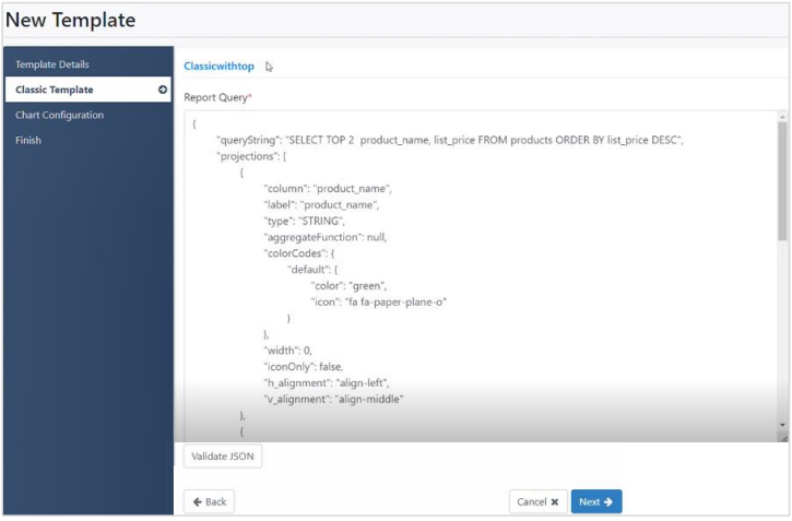

  5. After filling the details, click JSON Based (Classic) under Select Approach to Create Template. In the Classic Template page, the report placeholder template query is generated.
    reports
    JSON Based (Classic) report query
    As the generated template query is a placeholder and not a working JSON query, you must modify the query to achieve the required result.
  6. Click Validate JSON. The validation is successful message appears.

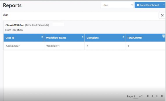

The template appears on the Dashboard, which you can use to generate reports.
reports
Report dashboard

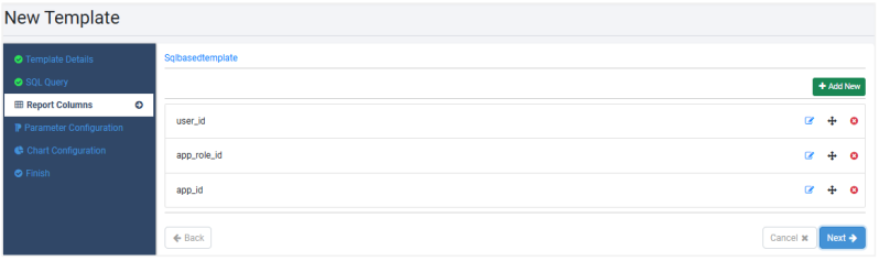

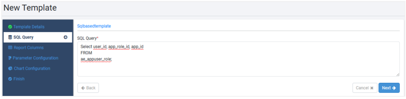

  4. Click SQL Based and then click Next. The SQL Query menu appears in the left pane.
    reports
    New Template - SQL Query
    In SQL Query, enter the query, which is tested, and then click Next. The Report Columns page appears.
  5. In the Report Columns section, the columns selected in SQL Query appear.
    reports
    New Template - Report Columns
    If the SQL Query’s select statement contains ‘*’, that is, all columns, then you need to add the projection columns manually using Add New in the Report Columns page.

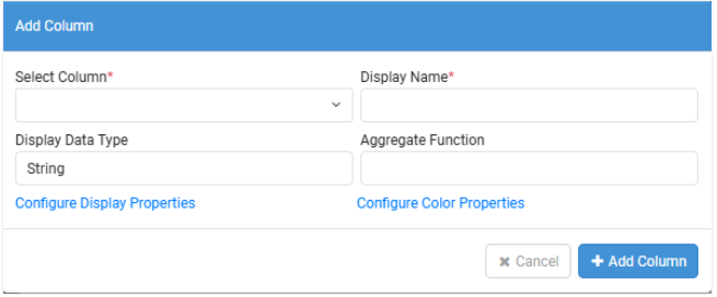

    To add a new column: i. Click Add New. The Add Column dialog appears.
    reports
    Add Column dialog
    ii. Enter the following field details:
    • Select Column: Select the name of the column, as called out in the SQL query.
    • Display Name: Enter the column name, as you want it to appear in the report.
    • Display Data Type: Select the data type of the selected column.
    • Aggregate Function: Select the aggregate function used for the selected column. For example, COUNT, AVERAGE, and so on.

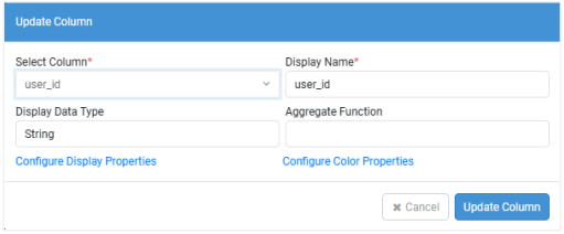

    vi. In the Reports Column page, in addition to adding new columns, if required, you can perform any of the following tasks:
    • To view the actual JSON details for a projection column, click on the column name and expand the view.
    • To modify the details of the columns, click reports make the required changes and then click Update Column.

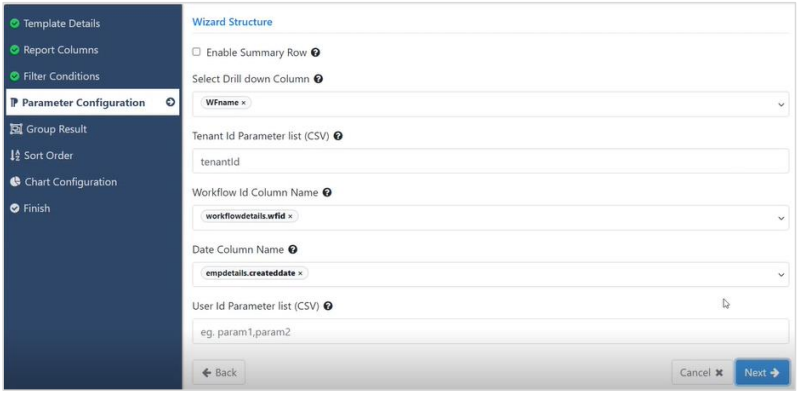

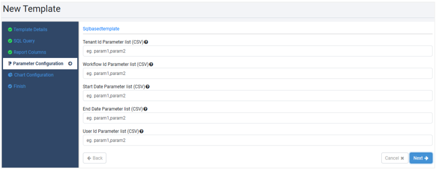

    vii. Click Next. The Parameter Configuration page appears.
    reports
    Tenant Id Parameter list (CSV)Enter the name of the tenant ID parameter list.
    Note: For both SQL Based and Wizard based approach, it specifies a list of parameter names for tenant IDs. For example, ["param1", "param2"].
    AE Engine identifies these parameters in the query. The parameters should be present in the query as :param1 and :param2.
    It substitutes these query parameters by run time values of the tenant id of the user running the report. This parameter value in the query table should be numeric.
    Workflow Id Parameter list (CSV)Enter the name of the workflow ID parameter list.
    Note: Only for the SQL Based approach, it specifies a list of parameter names for workflow IDs. The AE engine identifies these parameters in the query and substitutes them with runtime values. This parameter value in the query table should be numeric.
    Start Date Parameter list (CSV)Enter the name of the start date parameter list.
    Note: Only for the SQL Based approach, it specifies a list of parameter names for the start date. The AE engine identifies these parameters in the query and substitutes them with the start date-time stamp of the report. This parameter value in the query table should be of type date.
    End Date Parameter list (CSV)Enter the name of the end date parameter list.
    Note: Only for the SQL Based approach, it specifies a list of parameter names for the end date. The AE engine identifies these parameters in the query and substitutes them with the end date-time stamp of the report. The parameter value in the query table should be of type date.
    User Id Parameter list (CSV)Enter the name of the user Id parameter list.
    Note: For both, SQL Based and Wizard based approach, it specifies a list of parameter names for user IDs. For example, [“param1”, “param2”].
    AE engine identifies these parameters in the query. These parameters should be present in the query as :param1 and :param2. It substitutes the query parameters by the run time values of the user ID running the report.

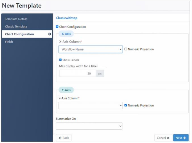

  6. Click Next. The Chart Configuration page appears.
    For Chart Configuration field details, see Create Classic template using JSON based approach.

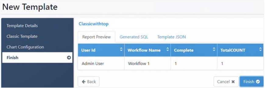

  7. Click Next. The Finish page appears.
    For details about the three tabs, see Create Classic template using JSON based approach.
  8. Click Finish. The template appears in the Template page.
  2. Click New Template. The New Template page appears.
    reports
    New Template page
  3. In the Template Details section, enter the field details. The following options are available under Select Approach to Create Template after you select the tables in the Select Tables list:
    • Wizard Based
    • JSON Based (Classic)
    • SQL Based
  4. Click Wizard Based and then click Next. The Wizard Based menu appears in the left pane.

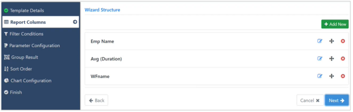

  5. In the Report Columns page, you can perform the following tasks, if required:
    • Click Add New, to add new columns.
    • Click Edit, to modify the column details.
    • Click Move, to sort the columns on the page.
    • Click Remove, to delete the column.
    For details about field details and tasks, see Create Flat Query template using SQL based approach.

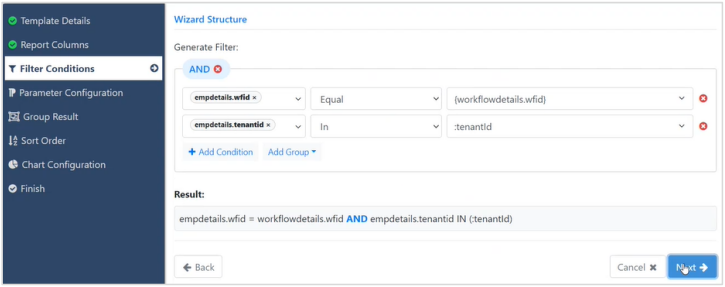

  6. Click Next. The Filter Conditions page appears.
    reports
    ▪ In the Filter Conditions page:
    o Click Add Group. From the list, select the grouping option, AND or OR.
    o Click Add Condition, and select the filter condition, the comparator, and the mapped column. The filter conditions are captured in the Result field.
  7. Click Next. The Parameter Configuration page appears.
    reports
    Enter the following details:
    Enable Summary RowSelect the checkbox if you want the summary row in the report.
    Note: Only for structured query, a boolean value specifying if the summary row should be present for the report or not.
    Select Drill down ColumnSelect the column on which you want to drill down.
    Note: Only for structured query, if the report needs a feature where clicking on a row drills down further, the user must populate this field with the column's name to use for further grouping. This name must be present in projections.
    Note: For both SQL Based and Wizard based approaches, it specifies a list of parameter names for tenant IDs, for example, ["param1", "param2"].
    The AE engine identifies these parameters in the query. These parameters should be present in the query as :param1 and :param2.
    It substitutes these query parameters by run time values of the tenant ID of the user running the report. The parameter value in the query table should be numeric.
    Workflow Id Column NameSelect the workflow ID column name.
    Note: For structured query only, this parameter can be present only if workflowIdParamNames is not present. The parameter has the workflow ID column on which the engine adds a workflow ID filter.
    Date Column NameSelect the date column name.
    Note: Only for structured query, this parameter can be present only if startDateParameterNames and endDateParamNames are not present. The parameter has the name of the column on which the engine adds the date filter. The parameter value in the query table should be of type date.
    The AE engine identifies these parameters in the query. The parameters should be present in the query as :param1 and :param2. It substitutes these query parameters by the run time values of the user id running the report.
    If Tenant users execute a custom report with the userIdParamNames option, the user can see rows that contain his user id.
    However, if Admins execute a custom report with the userIdParamNames option, the user can see all rows for the first, that is, oldest created 1000 users.

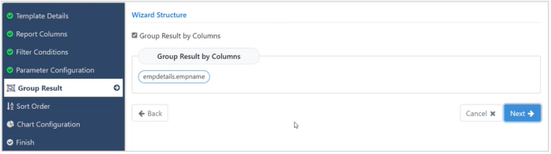

  8. Click Next. The Group Result page appears.
    reports
    Group Result page
  9. Select the Group Result by Columns checkbox. The group by columns appear in Group Result By Columns.
    Group by columns are selected based on report columns (projections) and aggregate functions used on the columns. Number of group by columns also depend on configured parameters. If the inner Query column name is configured, then group must have only one column, therefore, the user needs to remove some of the group by columns.
    To remove some of the group by columns, hover over the column, and then click Remove column that appears.

  13. Click Next. The Chart Configuration page appears.

  15. Click Finish. The template appears in the Template page.
    The template appears in the Dashboard, which you can use to generate reports.

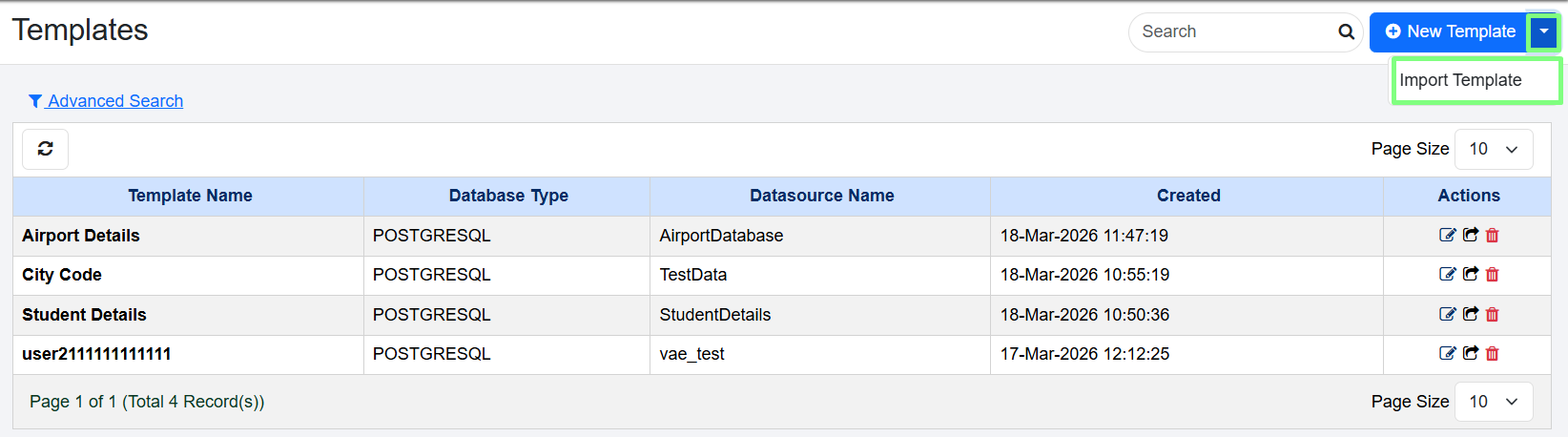

  1. In the menu, click Reports → Templates. The Templates page appears.

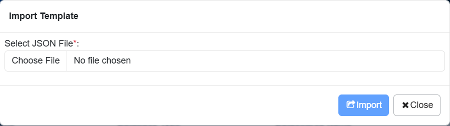

  2. Click import options. Import Template option appears.
    Import Template

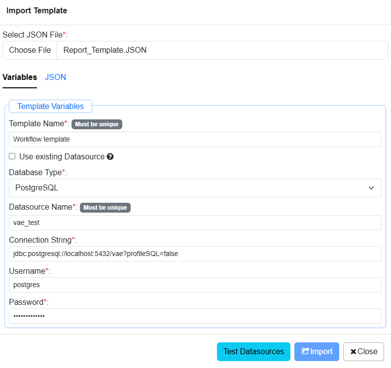

  3. Click Import Template. Import Template dialog appears.
    Import template dialog
  4. Click Choose File and select the required JSON file. Once the file is loaded, the Variables and JSON tabs appear.
    Refer the following details:
    • Variables Tab: Displays any configurable variables defined in the template. Review and adjust variable default values as needed before import.
      • Template Name: Enter a unique, descriptive identifier for the template. This name appears in the Templates list and is used to locate the template during report generation.
      • Datasource Name: Enter the datasource that supplies data to the template. The template's query definitions must align with the schema of the selected data source.
    • JSON Tab: Shows the raw JSON payload of the template. Available in Edit Mode. Modify query paths, field mappings, or layout definitions directly.
      • Edit Mode (Toggle): Enable this switch if you need to manually modify the JSON structure or variables.
    Variables tab
    Variables tab
  5. Click Test Datasource. If details are right success message appears.
  6. Click Import. The new template now appears in the Templates list and is available for report generation.
