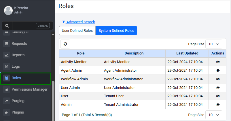

  1. In the menu, click Roles. The Roles page appears.
  2. On the page, click System Defined Roles tab. List of system defined roles appear.
    Roles - System Defined Roles tab
  3. View the following field details:
    Field NameDescription
    RolesDisplays the system defined roles. The roles are:
    - *Activity Monitor
    - Agent Admin
    - Workflow Admin
    - User Admin
    - User
    - Admin
    DescriptionDisplays the description of the roles.
    Last UpdatedDisplays the date and time the role details were updated.
    ActionsClick to view the role permissions.

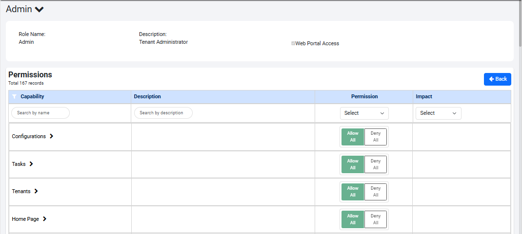

  4. In the Actions column, click Eye icon. The permissions page of the selected role appears as follows:
    Role permissions page
  5. View the following field details:
    Role NameDisplays the name of the role.
    DescriptionDisplays the description of the role.
    Web Access PortalDisplays the selected checkbox.
    Note: If the checkbox is selected, then users can sign in to AEUI with both API and UI access. Else, the user will have only API access to allowed modules.
    Permissions
    CapabilityDisplays the name of capability that the role is assigned.
    DescriptionDisplays the description of the capability.
    PermissionDisplays the permission granted for a capability or sub-capability assigned to the role. Permission values are: Allow or Deny.

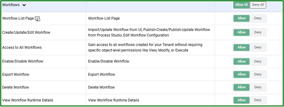

    To view the permission at the sub-capability level, click each capability. If each sub-capability has either Allow or Deny, then at the Capability level the permission is seen as, Allowed All or Deny All.
    For example,
    Sub-capability - Workflows

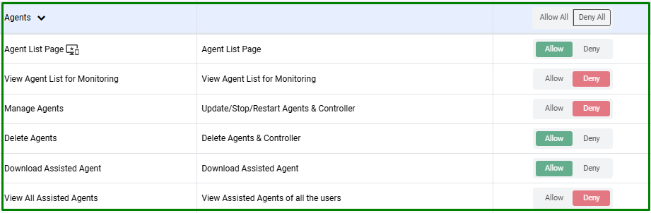

    If the permission at sub-capability level is a mix of Allow and Deny, then neither Allow All or Deny All is selected at the Capability level.
    For example,
    Sub-capability - Agents
