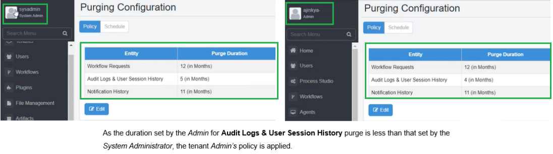

Scenario 1: If the flag, ae.global.purge.enabled=false, in the ae.properties file, then:
  • You can apply purging only for those tenants who have specified a purge policy.
  • The Purge Duration set by the System Administrator and Admin are considered, and the policy which has lesser purge duration is applied to the tenant. For example, see the following screenshot:
    Purge
    Purge policy scenario with duration comparison

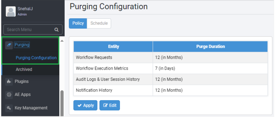

To apply or edit a purge policy:
  1. In the menu, click Purging → Purging Configuration. The Purging Configuration page appears.
    Purge configuration
    Apply is unavailable, if ae.global.purge.enabled=true, in the ae.properties file.

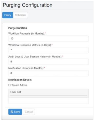

  2. To apply the purge policy, click Apply. Application of the tenant policy is a one-time activity. OR To edit the tenant policy, click Edit.
    Purge configuration
    Edit purge policy page
  3. In the edit page, enter the following details:
    Purge Duration
    Workflow Requests (in Months)*Enter the data retention duration in months for the workflow requests. The records older than the set duration are purged from the data table.
    For example, if you set 12 months, then any record older than 12 months will be permanently deleted from the data table when the scheduled purge job runs.
    Workflow Execution Metrics (in Days)*Enter the data retention duration in days for the workflow execution metrics. The records older than the set duration are purged from the data table.
    For example, if you set 7 days, then any records older than 7 days will be permanently deleted from the data table when the scheduled purge job runs.
    Note: The Workflow Execution Metrics (in Days) field is available only if the Workflow Metrics service is running.
    Audit Logs & User Session History (in Months)*Enter the data retention duration in months for audit logs and user session history. The records older than the set duration are purged from the data table.
    For example, if you set 12 months, then any records older than 12 months will be permanently deleted from the data table when the scheduled purge job runs.
    Notification History (in Months)*Enter the data retention duration in months for notification history. The records older than the set duration are purged from the data table.
    Notes: The value for Notification History must be less or equal to the value entered for Workflow Request.
    Notification Details
    Tenant AdminSelect the checkbox to add the list of emails to whom you want send notification emails.
    Email ListEnter the email addresses of users you want to send the emails to.
    *Indicates mandatory field.

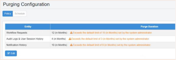

    You can set the purge duration of the policy equal to or less than the duration set by the System Administrator. Else, you’ll see the following:
    Purge configuration
    The purge policy is applied depending on the purge duration set by the System Administrator or Admin. If you set the purge duration less than that set by the System Administrator, then the Admin’s purge policy is applied to the tenant.

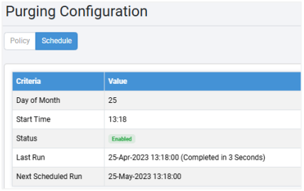

To view a purge schedule:
  2. On the Purging Configuration page, click the Schedule tab. The purge schedule page appears.
    Purge configuration
    Purge schedule page
  3. View the schedule details:
    Criteria
    Day of Month
    Or
    Day of Week
    Displays the day of the month when the purge is scheduled. For example, 5 indicates 5th day of the month.
    Or
    Displays the day of the week when the purge is scheduled. For example, Saturday.
    Week of the monthDisplays the week of the month in which the purge is scheduled. For example, 4.
    Note: The field is displayed only if the selected criteria is Day of Week.
    Start TimeDisplays the time when the scheduled purging will start.
    StatusToggle the switch to enable or disable the schedule.
    Last RunDisplays when the previous scheduled purge was run.
    Next Scheduled RunDisplays the date and time when the next scheduled purge will run.
