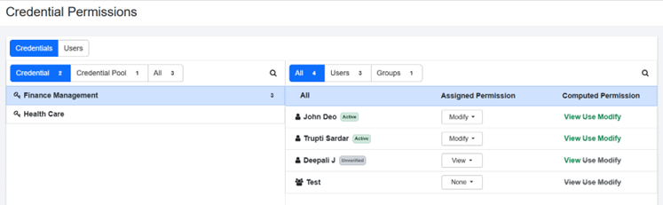

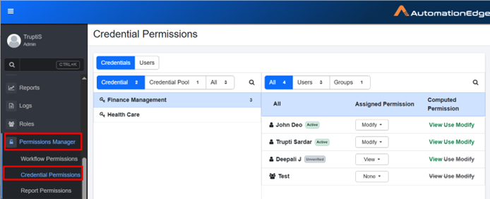

  1. Click Permissions 🡪 Credential Permissions. The Permissions page appears.
    Credential and Credential Pool Permissions
    Credential Permissions page
  2. Click the Credential tab, (the tab selected by default), the following sub-tabs are available: All or Credential or Credential Pool sub-tab. You will see the following under each sub-tab:
    • All: Lists all credentials and credential pool.
    • Credential (Credential icon): Lists all credentials.
    • Credential Pool (Credential Pool icon): Lists all credential and credential pool.
  3. Select the credential or credential pool to which you want to assign permissions to users or groups.
  4. In the right pane, select All or Users or Groups sub-tab. You will see the following under each sub-tab:
    • All: Lists all users and groups.
    • Users(Users icon): Lists all users.
    • Groups(Groups icon): Lists all groups.

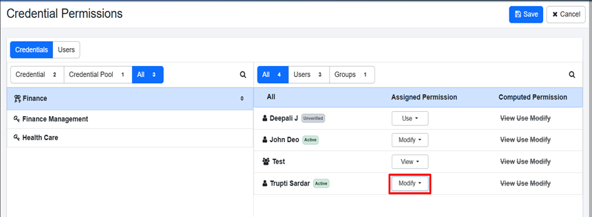

  5. In the Assigned Permission column, select the permission you want to assign to the user and / or user group for the selected credential or credential pool. Available options are View, Use, and Modify.
    In the Computed Permission column, view the maximum permissions assigned to the users or user groups or credential or credential pool.
    Credentials
    Credential permissions assigned
  6. Click Save. The permissions are saved successfully.
