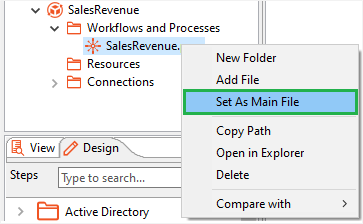

    1. Select and right-click on the workflow you want to publish and in the contextual menu, select Set As Main File. The selected workflow or process is set as the main file of the project.
      Set As Main File
      Set As Main File option

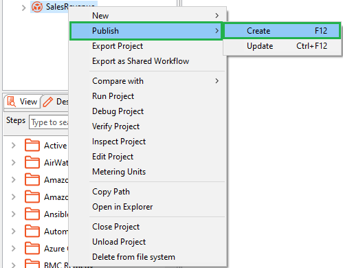

    2. In the Project Explorer, select and right-click on the Sales Revenue project. In the contextual menu, select Publish -> Create.
      Publish -> Create
      Publish Create option
