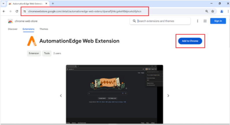

  1. Open MS Edge/Google Chrome browser.
  2. Enter Web store extension URL in address bar: chromewebstore.google.com/detail/automationedge-web-extens/dpanaffjihkcgekehfbkjncekdifphcn
  3. Chrome web store page opens. Click Get/ Add to Chrome.
Chrome Web Store page with Add to Chrome button for AutomationEdge extension

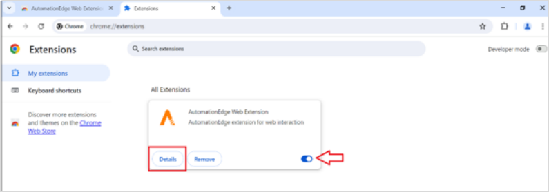

  1. After download and installation complete, go to Settings > Extensions > Manage Extensions.
  2. Enable AutomationEdge Web Extension vX.X.X.
Chrome Extensions page with AutomationEdge Web Extension enabled

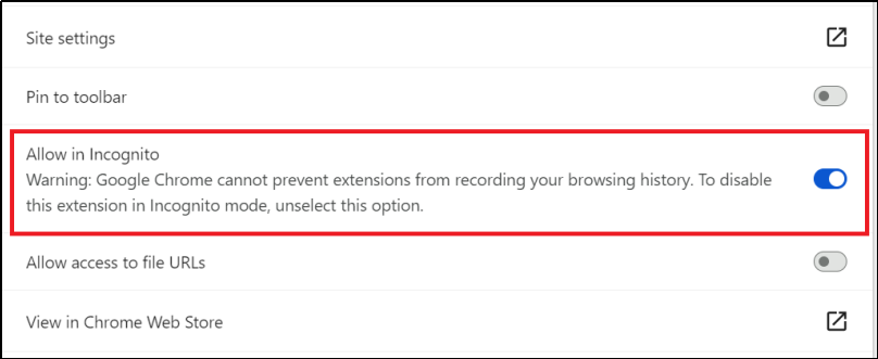

  1. Click Details and then toggle the Allow in Incognito mode switch. The extension will work in the incognito mode for Web technology.
Chrome extension details page with Allow in Incognito mode toggle

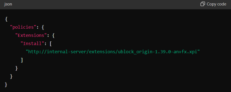

  1. Add Extension Configuration:
  • Add the necessary JSON configuration for the extensions you want to install. Here’s an example for installing the "uBlock Origin" extension:
Firefox policies.json configuration example for extension deployment
  • Adjust the URL to point to your internal server or file share where the .xpi file is hosted.
