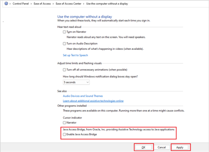

Enable Java Access Bridge
To enable JAB: 1.Click Start → Control Panel → Ease of Access → Ease of Access Center → Use the computer without a display. The details page appears. 2.In the details page, scroll down and then select Enable Java Access Bridge checkbox. JAB is enabled.
Windows Control Panel Ease of Access with Enable Java Access Bridge checkbox
