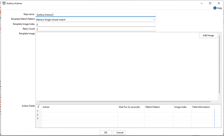

  1. Drag the Surface Actions step on the canvas or generate a Surface Actions step from Surface Spy. For more information, see Appendix: Surface Spy Tutorial. OR If the step is not generated using Surface Spy, then open the step and click Edit Image, and then select the template image.
  2. Click on the Surface Actions step. The Surface Actions dialog appears.
Surface Actions dialog with captured template image

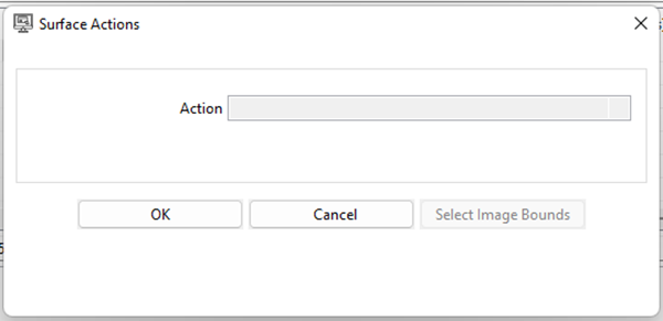

  1. The Surface Actions dialog displays the captured template image, and then in the Action column, click in the first-row cell. The Surface Actions dialog appears.
Surface Actions action selection dialog
  1. Enter the common field details. In addition to the common fields, you will also see the following field details, depending on the action selected.

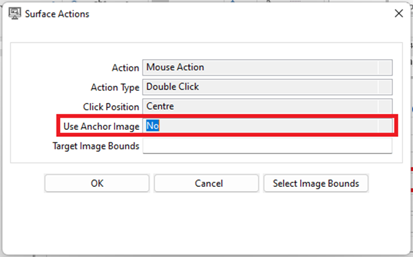

Use Anchor ImageAn anchor image is used as a reference point for identifying and fetching the target from the active screen.
Select either Yes or No.
• If Yes, it searches for the anchor image on the active screen. If found, the step performs the specified action on the target area. Requires two selections:
    • Anchor Image Bounds
    • Target Image Bounds
• If No, it searches the Target Image on the active screen. If found, it performs the specified action. Requires:

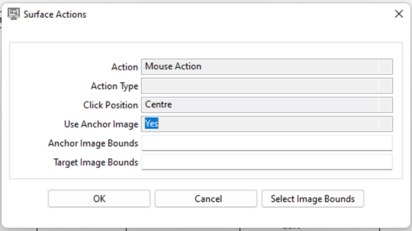

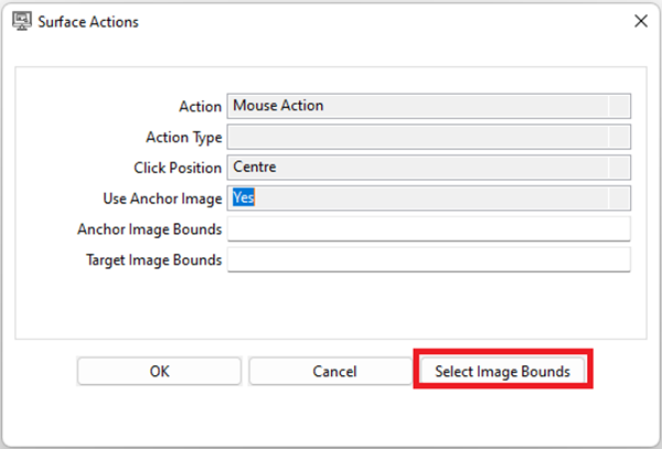

Anchor Image BoundsSelect the Anchor Image Bounds of the template image using the Select image bounds button.
Target Image BoundsSelect the Target Image Bounds of the template image using the Select image bounds button.
  • Actions
  1. Mouse Action:
Mouse Action configuration dialog
Field NameDescription
Click PositionSelect the position to perform the action on the selected area of the image.
Note: The position is applicable to the target image area.
Select an option from the following:
• Centre
• Right
• Left
• Top Left
• Top Right
• Top Middle
• Bottom Right
• Bottom Left
• Bottom Middle

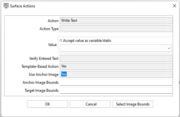

  1. Write Text:
Write Text action configuration dialog
ValueProvide the text to perform the Write Text operation.
Leave the checkbox unchecked to accept the value from a field in the previous steps of the stream using a drop-down list.
Verify Entered TextSelect Yes or No.
If you select Yes, then it will verify if the inserted text is correctly inserted or not.
If the inserted text is different than the value in the Value field, it will throw an exception.
1. You must have the system clipboard access.
2. It will not work with password fields.
3. Sometimes due to incorrect image OCR data, it will not match with the given data in the Value field.
4. The field will read the text as per the given OCR provider.
5. Not applicable for “Current Caret Position” option to write text.
6. OCR results using Tesseract may be inaccurate due to image quality or noise, which may affect the verification of entered text.
Template-Based ActionSelect Yes or No.
If you select Yes, then it will perform the Write Text action based on the selected area of the template image.
If you select No, then the Write Text action will be performed at the current position of the mouse cursor on the active screen.
To perform Template-Based Action with the option as No, you must have clipboard access to the system.
If the type of fields is non-editable, read-only, disabled, or masked, then it is recommended to use Template-Based action as Yes instead of No.

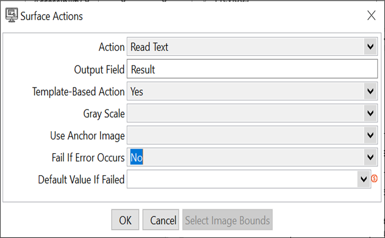

  1. Read Text:
Read Text action configuration dialog
If you select Yes, then it will perform the Read Text action based on the selected area of the template image.
If you select No, then the Read Text action will be performed at the current position of the mouse cursor on the active screen.
Note: To perform Template-Based Action with the option as No, you must have clipboard access of the system.
If the type of fields are non-editable, read-only, disabled, or masked, then it is recommended to use Template-Based action as Yes instead of No.
Gray ScaleSelect Yes or No.
If the selected option is ‘Yes’ then it will convert the specified area of the active screen of the image to Gray-Scale to read the text.
Fail If Error OccursSpecify Yes, to fail the step when an Image is not found, else specify No to not fail the step on error.
Allow values: Yes, No.
Default Value: Yes.
Default Value If FailedSpecify the default or null value to be returned when no value is retrieved, or an error occurs.
This field ensures the process execution without interruption.
Note: This field will be available only if Fail If Error Occurs is No.
Output FieldIt is a field to define the output variable name. The default output variable name is “Result”.

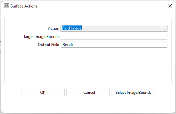

  1. Find Image
Find Image action configuration dialog

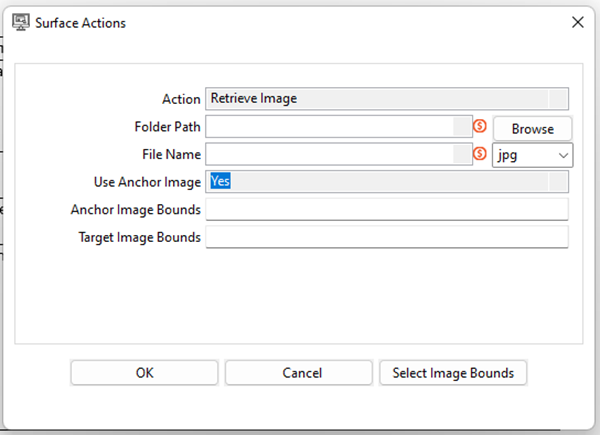

  1. Retrieve Image
Retrieve Image action configuration dialog
Folder PathClick the Browse button and select the folder path where you want to save the image file.
BrowseClick to open the folder dialog for selecting the folder.
File NameSpecify the name of the image without an extension.
File ExtensionsProvide the image file extension.

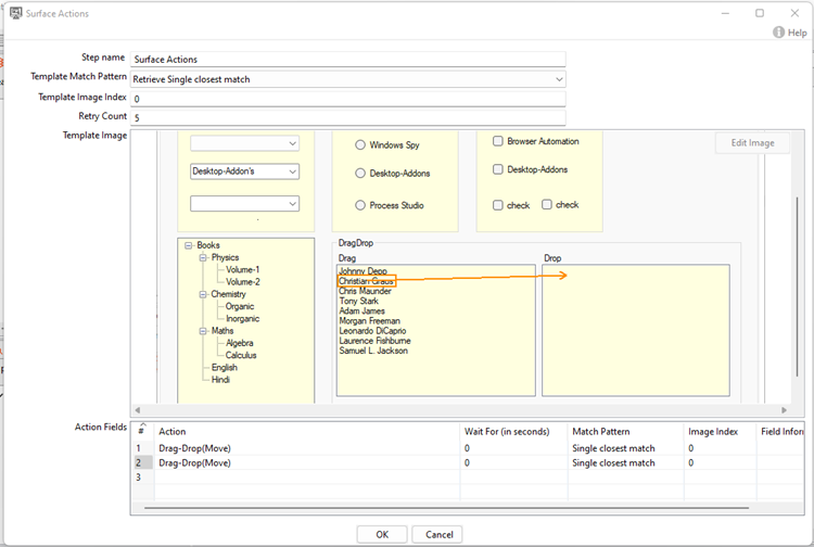

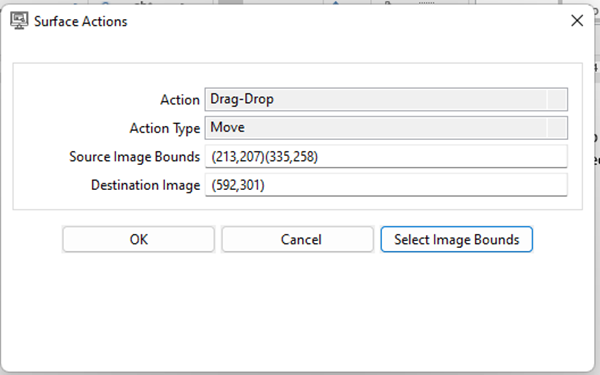

  1. Drag-Drop
Drag-Drop action configuration dialog
Action TypeSelect the action type.
Default: Move
It will move the object from the Source Point to the Destination Point.
Source Image BoundsSelect the Source Point from the template image with the help of the ‘Select image bounds’ button.
Destination Image Bounds/PointSelect the Destination Point from the template image with the help of the ‘Select image bounds’ button.

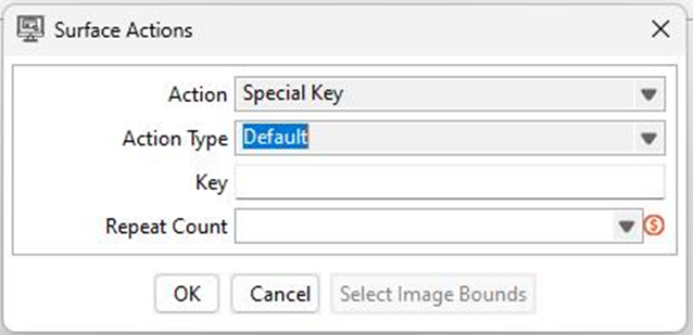

  1. Special Key
Special Key action configuration dialog
Keys Combination/KeyProvide the single key or combination of keys in separate square brackets ‘[]’ for each key.
For example:
• [enter]
• [win]
• [ctrl]
• [ctrl][c]
• [alt][enter]
• The single alphabetic and numeric keys are not allowed.
• The Java Robot class cannot simulate certain key combinations and actions reserved for system use, such as system-level shortcuts and secure attention sequences, due to security restrictions in modern operating systems like Windows. These actions are intercepted by the operating system to ensure security and integrity.
You cannot perform actions like logging off, locking the screen, or invoking system tools.
For list of keys, see Appendix: Surface Actions: Special Keys.
Repeat CountIt repeats the press and release operation of the specified key(s) for the given count.
The option is only visible if the Action Type is ‘Default’.
For example: If the key is [tab] and the Repeat Count is 5, then it will simulate the tab key press and release five times.

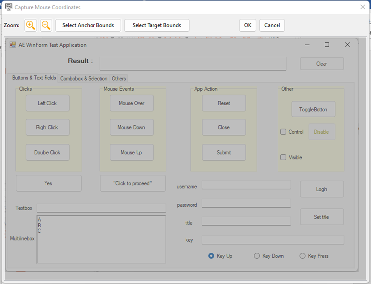

  • Click Select Image Bounds. It will open the ‘Template Image’ as seen in the following image:
Template Image opened for selecting image bounds
  • Steps to select the image bounds if the Anchor image is “Yes” If the Anchor Image option is ‘Yes’ then select two image areas as seen in the following screenshot:
  1. Anchor Image Bounds
  2. Target Image Bounds
Anchor Image Bounds and Target Image Bounds selection areas

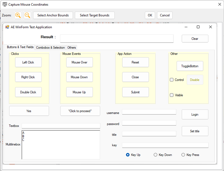

  1. Click Select Anchor Bounds to select the Anchor Image Bounds, once clicked on the button image will be highlighted with ‘Gray Color’ as seen in the following image:
Select Anchor Bounds with image highlighted in gray
  1. Select Anchor Image Bounds. The image is highlighted with the ‘Red’ color.
Anchor Image Bounds selected and highlighted in red

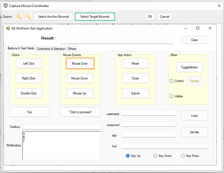

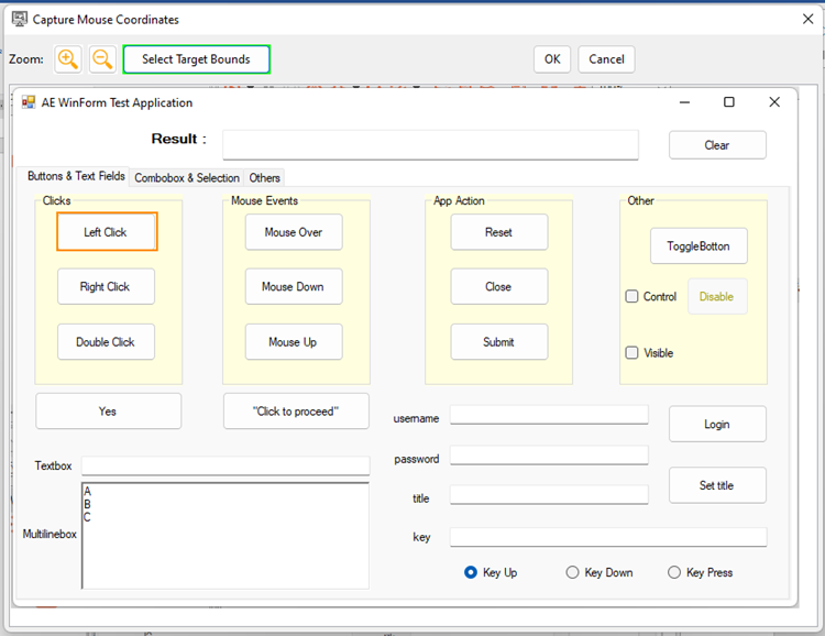

  1. Click Select Target Bounds to select the Target area by using the mouse pointer and the canvas will be highlighted with an ‘Orange’ color as seen in the following image:
Select Target Bounds with canvas highlighted in orange

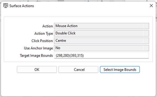

  1. After selecting the target area click on the ‘OK ‘button, it will close the Capture Mouse Coordinates popup window, and the selected coordinates will be reflected in the Anchor Image Bounds and Target Image Bounds on the Action popup.
Anchor and Target Image Bounds reflected in Action popup

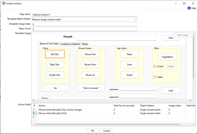

  • Steps to select the area if the Anchor image is “No” If the Anchor Image is selected as ‘No’ then only need to select the single image area.
Anchor Image set to No with single area selection
  1. After selecting the image area click OK. The Capture Mouse Coordinates popup window closes, and the selected coordinates are reflected in the Target Image Bounds on the Action popup.

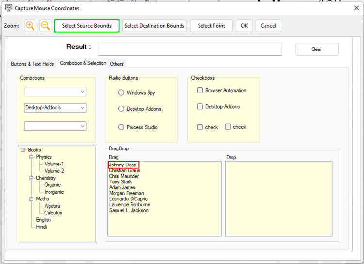

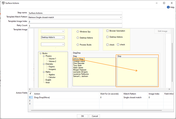

  • Steps to select the Drag-Drop points In the Drag-Drop action need to provide Source Point and Destination Point.
  1. Click Select Source Bounds and select the area from the Template Image. After selecting, the area is highlighted with a ‘Red’ color as seen in the following image:
Source Bounds selected and highlighted in red for Drag-Drop
  1. Select the Destination Point from any of the following two options:
  • Point To select the drop point, double-click on the area where you want to drop the dragged element and press ‘Escape’ from the keyboard to reflect the selected area and point in the Action popup.
Destination Point selected by double-clicking on template image
  • Region Click Select Destination Bounds to select the destination region. After selecting, the area is highlighted with an ‘Orange’ color as seen in the following image.
Destination Bounds selected and highlighted in orange
  • After selecting the Destination Point, click OK to reflect the selected area in the Action popup.
Source and Destination areas reflected in Action popup

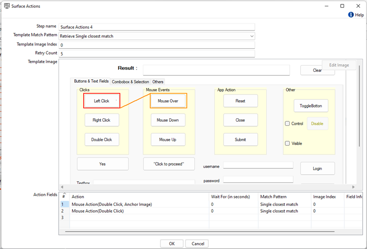

  • Spot Coordinate feature We have introduced the Spot Coordinates Feature to visually represent the actual operation positions on the template image with respect to different actions specified in table rows. To spot the coordinates of the row user just needs to select the Action Fields table row. For example:
  1. With Anchor Image The image highlighted in ‘Red’ color is the Anchor Image and the image highlighted in ’Orange’ color is the Target image.
Spot coordinates with Anchor Image in red and Target in orange
  1. Spot coordinates without Anchor Image. The image highlighted with ‘Orange’ color is the selected image for the action.
Spot coordinates without Anchor Image highlighted in orange
  1. Spot coordinate of Drag-Drop. In the image, the highlighted Source area and Destination area and line with the arrow shows the direction of the Drag-Drop action, its starting from center of the source point to center of destination point.

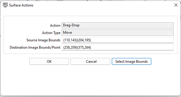

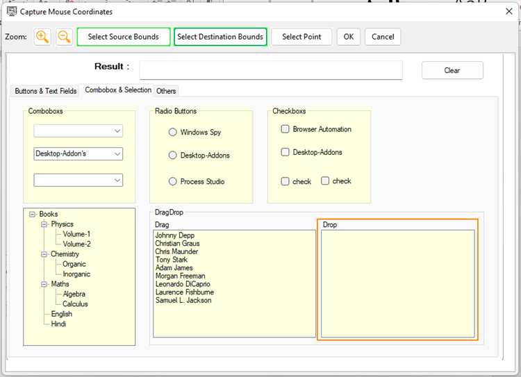

Drag-Drop spot coordinate with arrow from source to destination
The image is spotted with the Drag-Drop area from the center of the source area to the drop point.
Drag-Drop area spotted from source center to drop point
