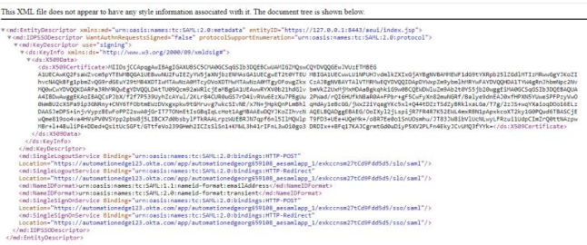

  3. To create the descriptor.xml: i. Click Application -> Your Application Name -> Sign On. ii. Click the highlighted link to get the descriptor details. iii. Save the descriptor details into an xml file called descriptor.xml.
    Descriptor XML
    Descriptor XML details

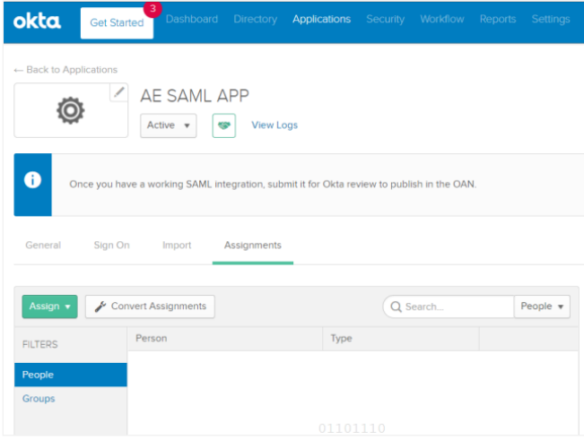

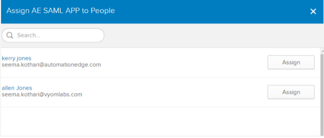

  4. To assign the web SAML application to users:
    i. Click Assignments -> Assign.
    AE SAML app
    AE SAML app Assignments
    ii. Search for the people to whom you want to assign the application to and click Assign. The application is assigned to the selected user.
    Assign AE SAML app
    Assign users to AE SAML app

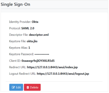

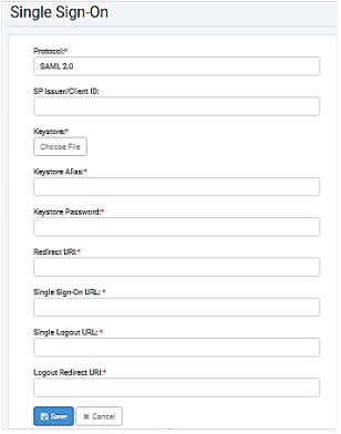

  5. To configure Single Sign-On in AutomationEdge UI:
    i. Sign on to AE UI and click Settings -> Single Sign-On. The Single Sign-On page appears.
    AE SAML SSO
    AE Single Sign-On settings page
    ii. Fetch and enter the field details, and then click Save. The details are saved.
    SSO details
    SSO configuration details
