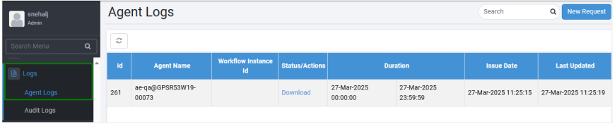

  1. In the menu, click Logs → Agent Logs. The Agent Logs page appears.
    Agent logs
    Agent Logs page

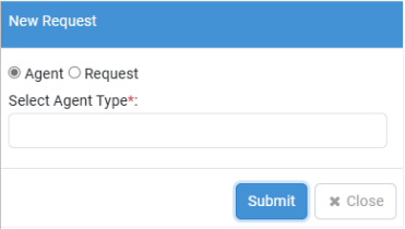

  2. Click New Request. The New Request dialog appears.
    Agent logs
    New Request dialog

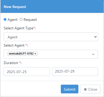

  3. Select Agent or Request and then:
    i. In the Select Agent Type*, choose the type of agent, Agent or Assisted Agent for which you want to download the log.
    ii. Enter the following details:
    • Select Agent*: Select the agent for which you want to download the log.
    • Duration*: Set the start and end date for downloading the log. The maximum duration to download log files is five days, that is, the difference between start and end date must be less than or equal to five.
