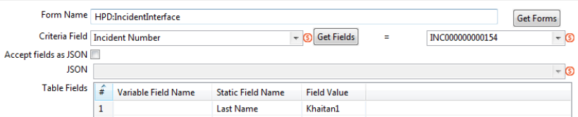

INPUT tab:Input Fields
Form NameDouble click the field to open a Form Explorer dialog with a list of Remedy forms and choose the Form from the list to populate the Form Name field. The field will not work for the previous step fields. However, you can provide static values, for example, CTM:People, HPD:IncidentInterface, PBM:ProblemInterface, CHG:ChangeInterface, and so on. Users can update records on any form according to the permissions.
Get FormsClick to open a Form Explorer dialog with a list of Remedy forms. Choose a form from the list to populate the Form Name field.
Criteria FieldDouble click the field to open the Field Explorer window. Select form field names to set Criteria Field. Criteria Field has to be chosen from the Field Explorer window. It will not work for the previous step fields; however Static Values and Environment Variables can also be provided.
Get FieldsClick to open the Field Explorer window. Select a Criteria form field from the list.
Criteria Field ValueSpecify a value for the selected criteria field.
Accept Fields as JSONSelect a checkbox to accept field names as JSON input.
JSONIf ‘Accept Fields as JSON’ checkbox is selected, then the field is activated. Choose a field containing the JSON text. JSON text should contain key-value pairs enclosed by double quotes (“) enclosure. Provide all the required or mandatory fields as well as other fields to be inserted as as keys in the JSON.
Note: The JSON could be from any input step such as Generate rows, Text File input, Excel Input etc. In Remedy (REST) steps JSON text can only be accepted from input fields from previous steps and not as files directly.
Sample JSON text for updating an Incident record:
Provide key-value pairs in the JSON text denoting the fields to be updated and the new values for the record.
Note: Lookup field values must exactly match existing values in the Remedy instance. For example, if Last_Name is to be updated in HPD:IncidentInterface create a JSON field with value:
{"Last Name":"Khaitan"}
Table Fields
Variable Field NameChoose a field in input stream from the list or provide a user or system defined variable.
The field is optional.
Static Field NameClick the column field, it opens a dialog with the list of available form fields of the provided Form Name. Select the name of the fields you want to insert. You can select multiple fields.
Field ValueSpecify field values to be inserted in the corresponding chosen fields. Following, is a sample snapshot of input tab with Table Fields with Static Field Name. You may also provide variables in Variable Field Name instead of Static Field Name.
