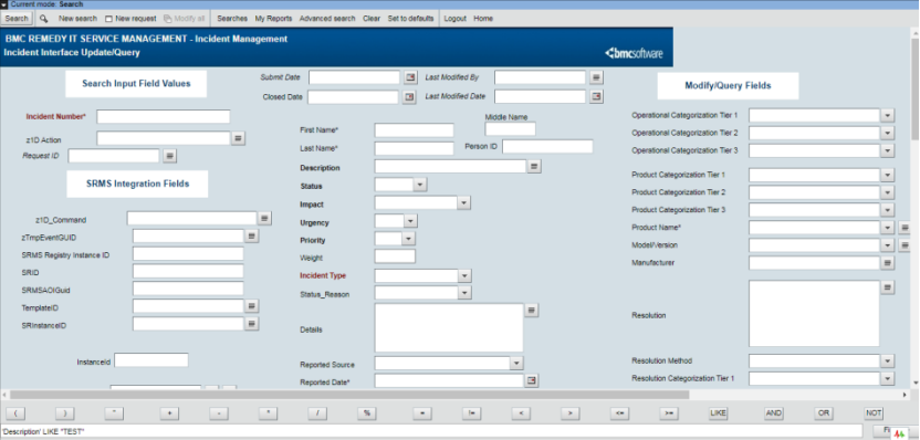

Query Criteria in BMC Remedy can be built by navigating to the Advanced Search on the form on which search is being conducted. See the following screenshot, HPD:IncidentInteface in Advanced search.
BMCRR-4
On the bottom row you can see the operators that can be used in Criteria Query.

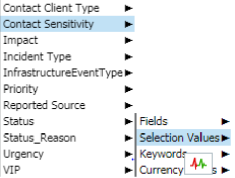

On the bottom right you may click Fields. You have the options to select Fields, Selection Values (List of Values), Keywords and currency as part of query building.
BMCRR-5
Query built in BMC Remedy forms can be used in Criteria Query field of the plugin. Make modifications as required.
