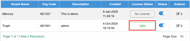

To check the license details,
  1. In the menu, click Tenants. The Tenants page appears.
alt text
  1. On the page click Valid. The License Details dialog appears.
alt text
You can check the Customer Id, License Id, License Type, Start Date, Expiry Date, Grace Period, Agent Threads in use, Assisted Agents, Consumed Process Studios and Step Units Consumed.

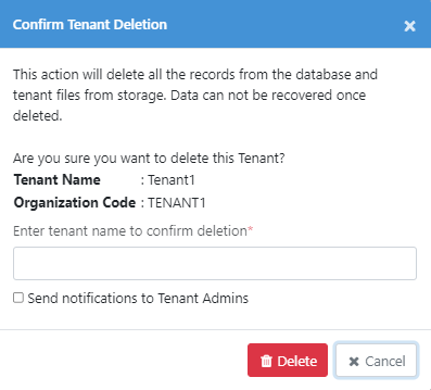

Delete
The System Administrator can delete tenants, if required:
  1. Toggle the status, and disable the tenant. The delete option becomes available.
  2. Click IMG_256 . The Confirm Tenant Deletion dialog appears.
    IMG_256
Figure 18: Confirm Tenant Deletion
  1. Enter the name of the tenant and select the Send notifications to Tenant Admins. Tenant Admins will receive a notification informing them of the deletion.
  2. Click Delete. The tenant details are deleted.
