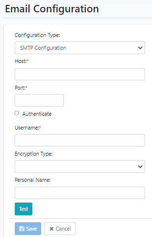

SMTP Configuration
You can configure the email server using the Simple Mail Transfer Protocol (SMTP) configuration.
To add an SMTP email configuration
Following are the steps to configure SMTP.

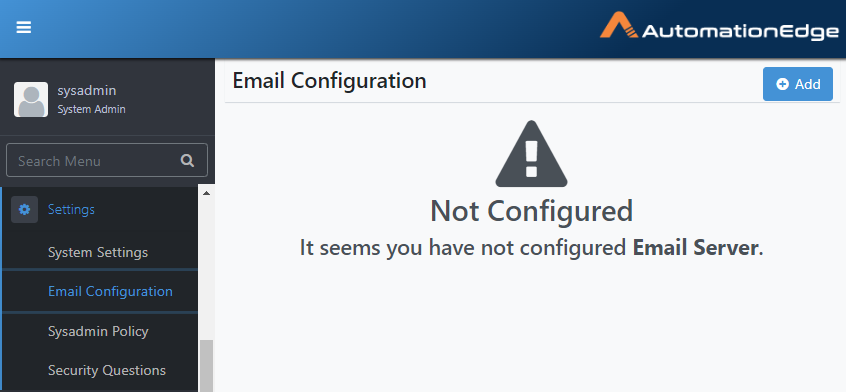

  1. In the menu, go to Settings→Email Configuration. The Email Configuration page appears.
  2. On the page, click Add. The Configuration Type selection dialog appears.
If you are configuring the details for the first time, then the Email Configuration page appears blank. IMG_256 IMG_257 Figure 92:Email Configurations
  1. From the list, select SMTP Configuration. The SMTP Configuration detail fields appear.
    IMG_256
Figure 93: SMTP Configuration page
  1. Enter the field details, as required.
Field Description
Host* Enter the hostname or IP address of the LDAP server.
Port*Enter the port number for LDAP connectivity. For example for Gmail SMTP serverthe port is SSL 465 TLS 582.
Authenticate Select the checkbox if you want to authenticate the user before connecting to the SMTP server.
Note: If you select the checkbox, then the Password field is available.
Username*Enter a username for authentication. For example, mail ID is the username for Gmail.
Password* Enter the app password for user authentication. For example for Gmail the password is the 16 digit app password
Note: The app password is not your mail login password.

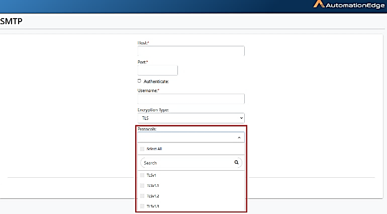

Encryption type Select the type of encryption you want. Available options are:
- SSL
- TLS
Note: If you select TLS, then the Protocols field appears.
Protocols Select one or more protocols for setting up SMTP configuration.
IMG_256
Personal name Enter the name you want to appear as the sender in the email.
If user selects TLS as the Encryption Type, a Protocols list appears.
IMG_259 You can select one or more protocols for setting up SMTPconfiguration.
  1. Click Test to validate the SMTP connectivity. A message confirming the success of the connectivity appears.
  2. Click Save. The SMTP configuration details are saved.

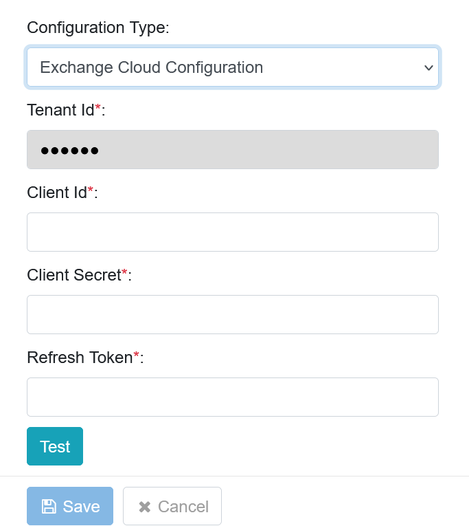

  3. From the list select Exchange Cloud Configuration. The Exchange Cloud Configuration detail fields appear.
    ExchangCloudConf
Figure 94: Exchange Cloud Configuration page

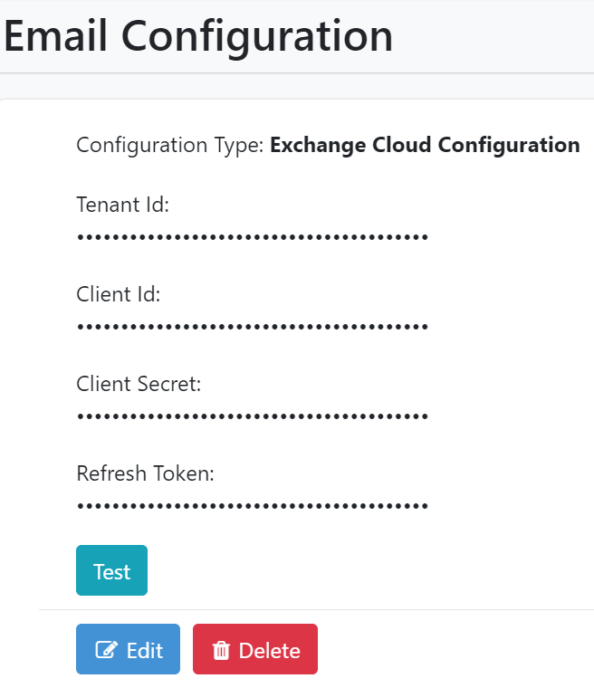

Access your Microsoft account to fetch the details.The details will appear encrypted in the fields
Figure 95: Exchange Cloud Configuration details
Field Description
Tenant Id Copy-and-paste your Microsoft account Tenant Id.
Client Id Copy-and-paste the client ID of the application created in your Microsoft account.
Client Secret Copy-and-paste the client secret generated in your Microsoft account.
Refresh Token Copy-and-paste the refresh token generated in your Microsoft account.
  1. Click Test to validate the Exchange Cloud connectivity. A message confirming the success of the connectivity appears.
  2. Click Save. The Exchange Cloud configuration details are saved.

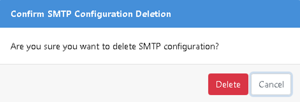

Delete email configuration
You can delete the email configuration, if required. 
To delete an email configuration:
  1. In the menu go to Settings->Email Configuration. The Email Configuration page appears.
  2. On the Email Configuration page, click Delete. The confirmation dialog appears. For example, if you are deleting SMTP Configuration, then the Confirm SMTP Configuration Deletion dialog appears.
    IMG_256
Figure 96: Confirm SMTP deletion dialog
  1. On the dialog, click Delete. The SMTP configuration deleted successfully message appears.

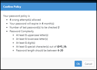

  1. Click Save. The details are saved, and the Confirm Policy dialog appears.
    IMG_257
Figure 98: Confirm Policy
  1. Click Ok. The password policy updated successfully message appears.

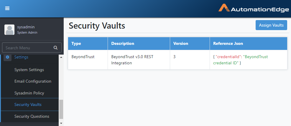

Security Vaults
Security Vaults is a secure enclosure used for storing valuable items.It often implies a high level of security. The System Administrator can assign security vaults to different tenants. Once the vaults are given to the tenants, the Admin can set up connections to the vaults. The security vault allows users to access and retrieve the credentials stored in the security vaults.
The Security Vaults option is available only if you set the enableSecurityVault key to true in the aeui-config.properties file. You will have to change the key value in the aeui-config.properties file every time you upgrade the AE UI. IMG_256 |
Assign security vaults to tenants
In the section, you will learn how to assign the security vault to tenants.
To assign security vaults to tenants: 
  1. In the menu, go to Settings->Security Vaults. The Security Vaults page appears.
IMG_256
Figure 99: Security Vaults page
  1. On the page click Assign Vaults. The Assign Vaults dialog appears.
IMG_257
Figure 100: Assign Vaults dialog: Tenants
  1. Select the tenants to which you want to assign the vaults, and then select the vault type.
IMG_258
Figure 101 : Assign Vaults dialog: Type
  1. Click Save. The vault is assigned to the selected tenant.
For details about using the vaults, see the AutomationEdg User Guide.

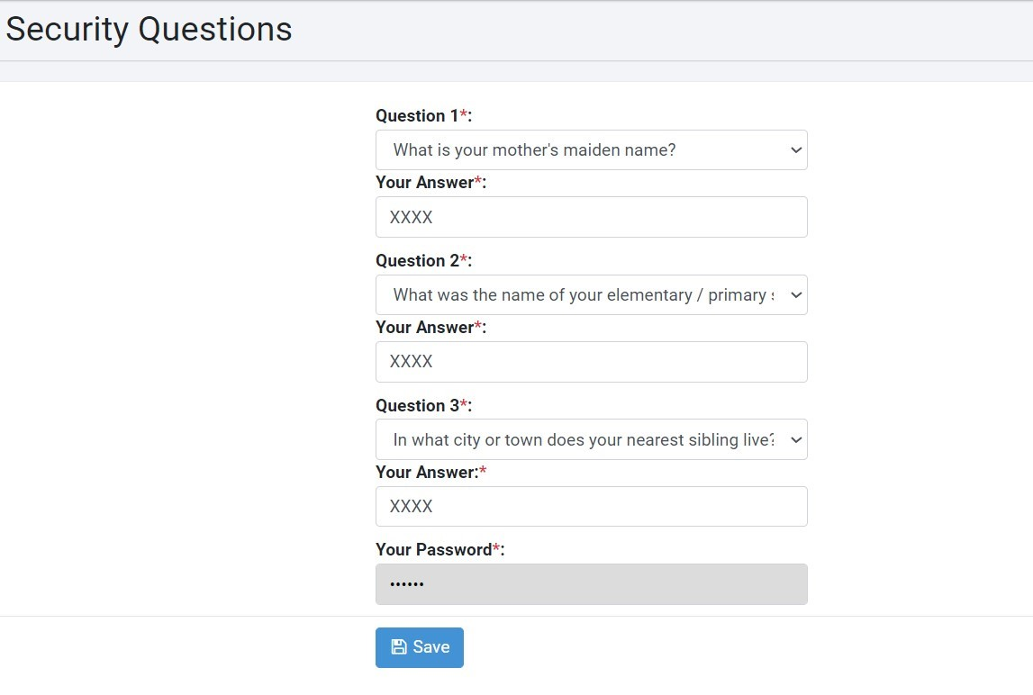

  1. Sign in to the AE UI, and in the menu click, Settings.The Settings menu options appear.
  2. In the Settings menu, select Security Questions. The Set Security Questions page appears.
  3. Select the queries that you want to set as security questions, enter the answers, and then click Save. A message confirming that the security questions are set successfully appears.
    IMG_256
Figure 5:Choose Security questions and answers
If you click Skip, you are directly taken to the Tenants page.

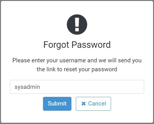

  1. On the login page, click the Forgot Password link. The Forgot Password dialog appears.
    IMG_256
Figure 6: Forgot Password dialog

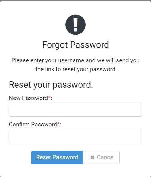

  1. In the username box, provide the name of the user, and then click Submit. The user will receive a link to reset the password.
  2. Click the link. The Reset your password dialog appears.
IMG_256
Figure 7: Reset your password dialog
  1. Enter the password in the New Password and Confirm Password box, and then click Reset Password. The new password is saved. 

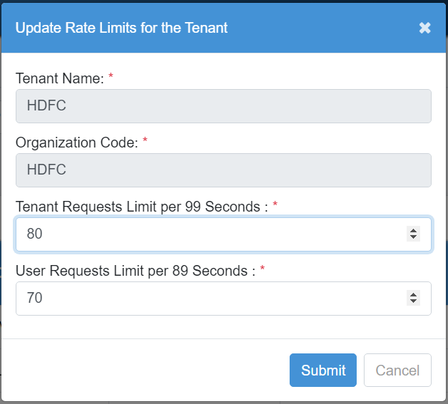

  1.  To modify the request limit details at individual level, click IMG_256. The Update Rate Limits for the Tenant dialog appears.
    IMG_256
Figure 102:Update Rate Limits for the Tenant
  1. Modify the tenant or user request limit, and click Submit. The updated details appear in the table on the Rate Limiter page.

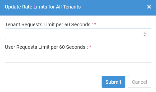

  1. Click Update All. The Update Rate Limits for All Tenants dialog appears. IMG_256
  2. Enter the value you want as the rate limit in the Tenant Requests Limit per <displays user defined value> Seconds and User Requests Limit per <displays user defined value> Seconds fields, and then click Submit. The updated details appear in the table on the Rate Limiter page You can search for tenant details using Search or Advanced Search options

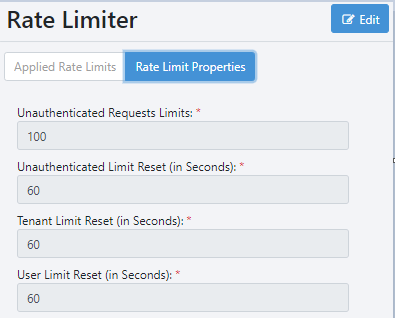

In addition, you can modify the rate limit for unauthenticated requests and the time limit after which the users can again attempt to make request calls.
To modify the rate limit properties
  1. In the menu, go to Settings -> Rate Limiter. The Rate Limiter page appears.
  2. Click the Rate Limit Properties tab. The properties details appear.
    IMG_256
Figure 104: Rate Limiter
  1. Click Edit. The read-only fields become available for modifying the details.
  2. Modify the details, as required, and click Save. The limit details are updated.
