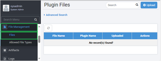

  1. In the menu, click File Management  Files. The Plugin Files page appears.

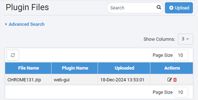

  2. Click Upload. The supporting file is uploaded.
alt text
• To update the existing plugin supporting file, in the Actions column, click edit . In the Update File dialog, select the updated file and then click Update.
alt text
• To remove the plugin supporting file from the AE server, click alt text

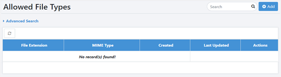

  1. In the menu, click File Management  Allowed File Types. The Allowed File Types page appears.
alt text
  1. Click Add. The Add File Types page appears.
File ExtensionEnter the file type you want to add to the list.
MIME Type*Enter the type of MIME you want for the file extension.
You can select multiple file extensions.
  • Indicates mandatory field.
  1. Click Add. The extension list is created.
  2. Click Add All. The extensions appear in the list on Allowed File Types page.
