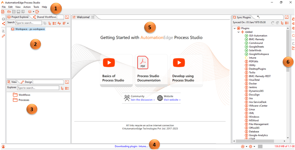

| Label | Interface | Usage |
| Menu bar and Toolbar | - Menu bar: Displays various menu options to work with in Process Studio. - Toolbar: Displays various tools to use instead of menu options. | |
| Project Explorer and Shared Workflows | - Project Explorer: Displays the name of the workspaces and list of projects, workflows, and processes. - Shared Workflows: Displays the list of workflows that are available for all users of the tenant. | |
| View and Design | - View: Displays the components, such as steps, database connections, hops, and process entries of in focus workflow or height process. - Design: Displays alphabetized list of steps or entries that you can use in workflow or process. | |
| Status bar | Displays the following: - User profile: Displays the details of the user. - Progress bar: Displays the current action in-progress in the Process Studio. For example, Downloading plugin: Intune. - Total Steps or Entries: Displays the step or entry details if a workflow or process is open. - Project Options: Displays a contextual menu with various options to perform actions on a project. - Quick Settings: Displays a contextual menu for allowing you quick setting. - Memory usage: Displays memory usage details. | |
| Canvas | Click the video or document links available under the Welcome tab, which is open by default. When working to build your workflows or processes, drag-and-drop steps or entries on the canvas. | |
| Sync Plugin and Sync Shared Workflow Debugging and Search | - Sync Plugins: Displays the list of new, updated, and deleted plugins. The new and updated plugins are synced. - Sync Shared Workflows: Displays the list of shared workflows ready for syncing. The Debugging pane displays three tabs, Breakpoints, Watch Variables, and Watch Fields. - Breakpoints: View all breakpoints in all projects in the currently active workspace. - Watch Variables: Add or update variables to watch during the workflow or process execution in debug mode. - Watch Fields: Add and update fields to monitor it during the debugging process. The Search pane, allows you to search values in a workspace, workflow, or process. |

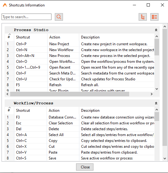

| Help | Shortcuts or F7 | Use to view the list of shortcut keys used in the Process Studio. You will see shortcuts specific to the Process Studio and workflows and processes. |

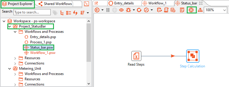

Use to locate in which project the current workflow or process appears. The workflow or process is highlighted in the Project Explorer.![]() The feature is especially useful when you have workflows with same name listed in different projects. | |
