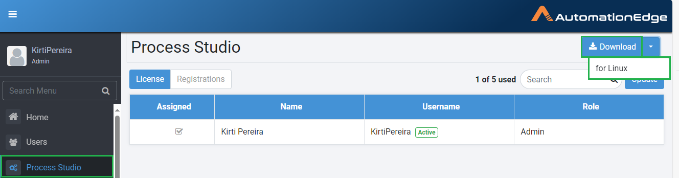

Sign in to the AE UI as the Admin and go to Process Studio. The Process Studio page appears.
In Process Studio Registration page, click Download. The Process Studio zip is downloaded for Windows.
note- To download Process Studio for Linux, click the corresponding dropdown.

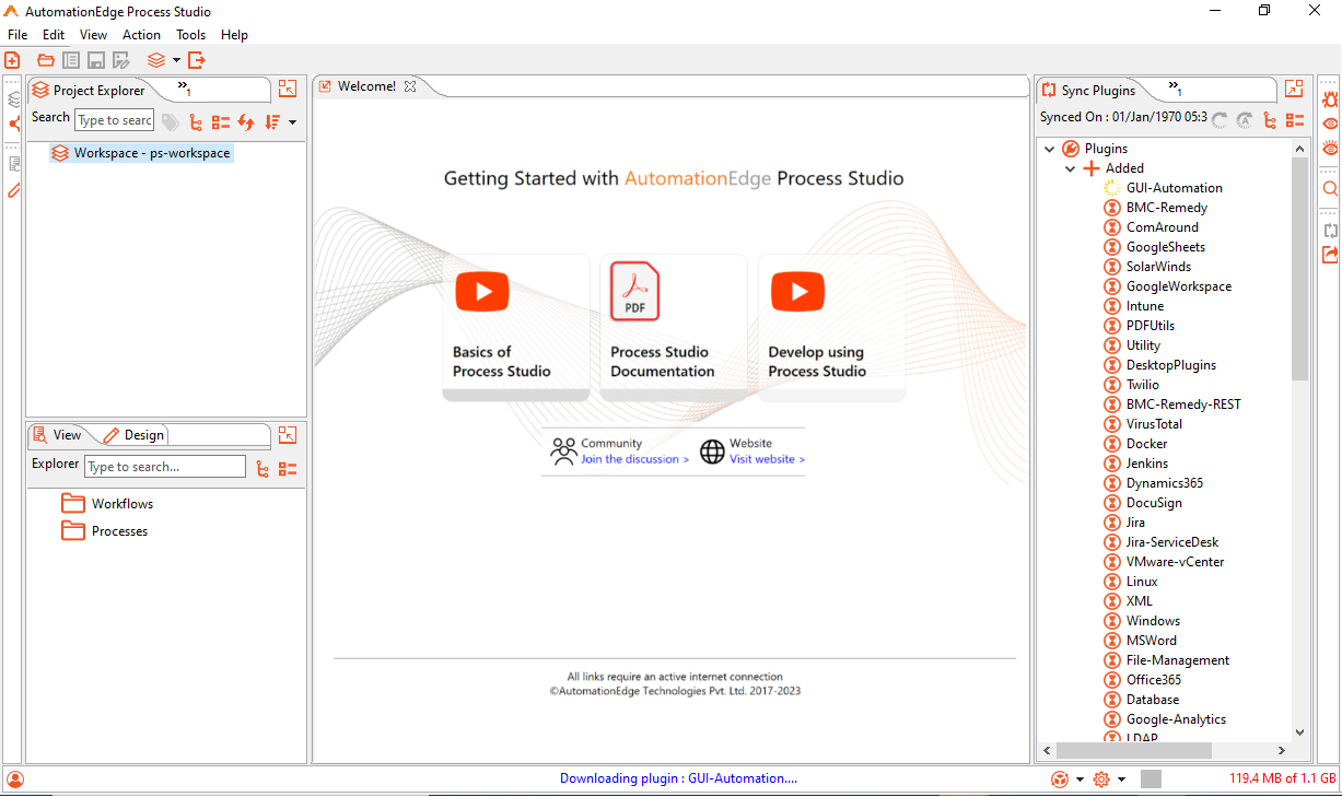

When you sign in to the Process Studio, by default, the Welcome tab is open in the canvas. The page provides links to training videos and Process Studio documentation.

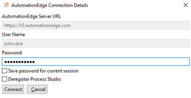

Run Process Studio, the AutomationEdge Connection Details dialog appears.
In the dialog, enter the details.
Field Description AutomationEdge Server URL Enter the AutomationEdge server path. User Name Enter your AE native or LDAP username. Password Enter your password to sign in to Process Studio. To save the sign in details of the current session, select the Save password for current session. -
Click Connect. The connection to the AutomationEdge server is complete, and the Open Workspace dialog appears.

Click Launch. The Process Studio opens.
After the Process Studio opens, you will see the list of plugins in the Sync Plugins pane. For details on synchronization of plugins, see Synchronize Process Studio with AE.

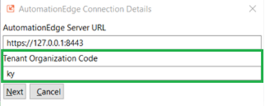

To sign in to Process Studio:
In the dialog, click Sign In with SSO. The SSO sign in details dialog appears.
Enter your tenant code in Tenant Organization Code and click Next. The AutomationEdge server connection is initiated.
tipIf a Security Alert pop-up appears, click Yes to proceed.

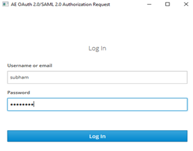

After the connection to AutomationEdge server is complete, the IDP Log In page appears.
Enter your AE SSO details, such as username or email and password in the Username or email and Password fields, respectively.
Click Log In, the Open Workspace dialog appears. Browse for your workspace and click Launch. Process Studio opens.

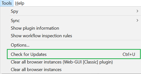

You can also check for updates, manually, through the Tools menu in Process Studio.
i. In Process Studio, click Tools and select Check for Updates.
ii. If Process Studio is already up-to-date, a No updates available, message appears. Click OK to close the message. And if updates are available then, Process Studio is updated and restarted.

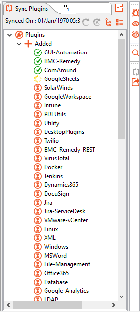

When you sign in to the Process Studio, it automatically checks for any plugin updates and synchronizes the plugins.
You can view the new, updated, or deleted plugins in the Sync Plugins pane. In addition, you can also view the list of updated or deleted files.
: Indicates plugin sync is successful.
: Indicates the plugin sync is in-progress.
: Indicates plugin sync awaited.
You can continue working with the Process Studio even when the syncing of new plugins is in-progress. The Process Studio does not restart if plugins are added. However, if a plugin is updated or deleted you are requested to restart the Process Studio.

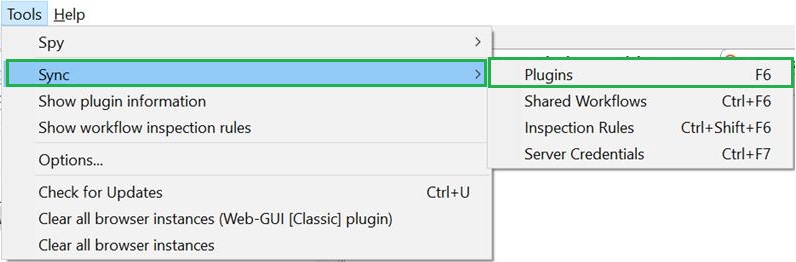

Synchronize plugins manually
You can synchronize plugins manually through Process Studio.
To synchronize plugins:
- Open Process Studio, go to Tools → Sync → Plugins. The AutomationEdge Connection Details dialog appears.
In the dialog, enter the password, and click Connect. If updates are available, a message confirming the updates appears.
Click OK. The plugins are updated and Process Studio restarts.
