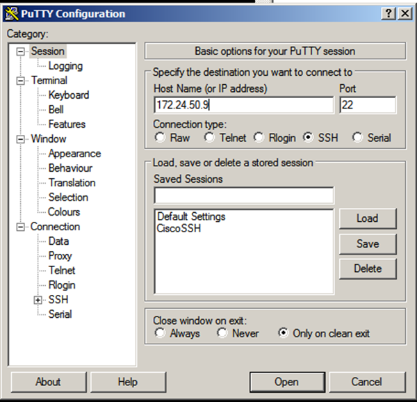

- Use Putty to connect to CISCO Switch.
- Provide the given IP Address and Port and click on Open.
- After clicking on Open, it will prompt for Security Alert, click on "Yes".

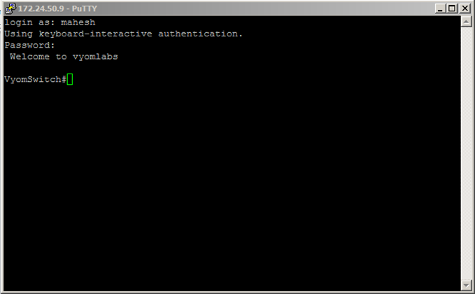

- The console will ask you to enter the username and password by which you have to login to the Switch. Enter the provided username and password.
- It will prompt for "VyomSwitch#", you can start writing your commands after #.
