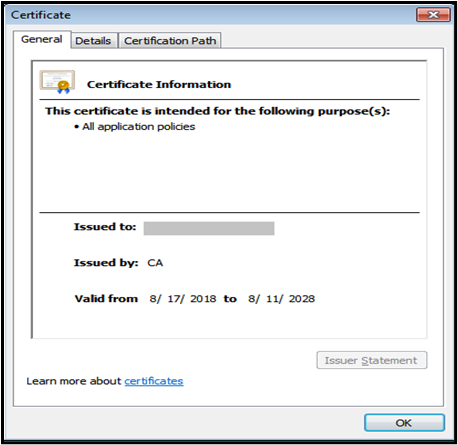

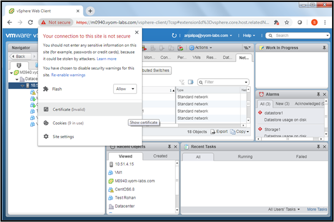

- Log in to vCenter Server using specified server name (https:\vmware.example.com) and follow the below procedure to install the certificate.
- The Certificate Windows opens.

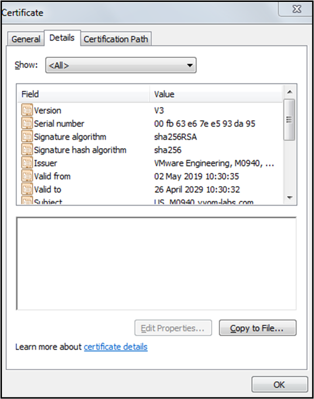

- Navigate to the Details tab.
- Click Copy to File button while on Details tab.

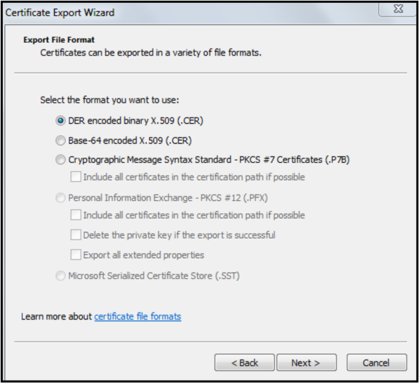

- Select the format as shown below.
- Click Next.

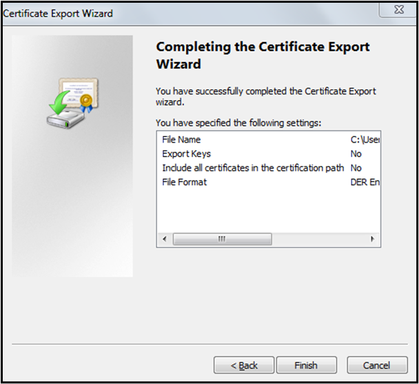

- You can now see the file path in the Certificate Export Wizard.
- Click Next
- This is the final step: Completing the Certificate Export.
- Click Finish.

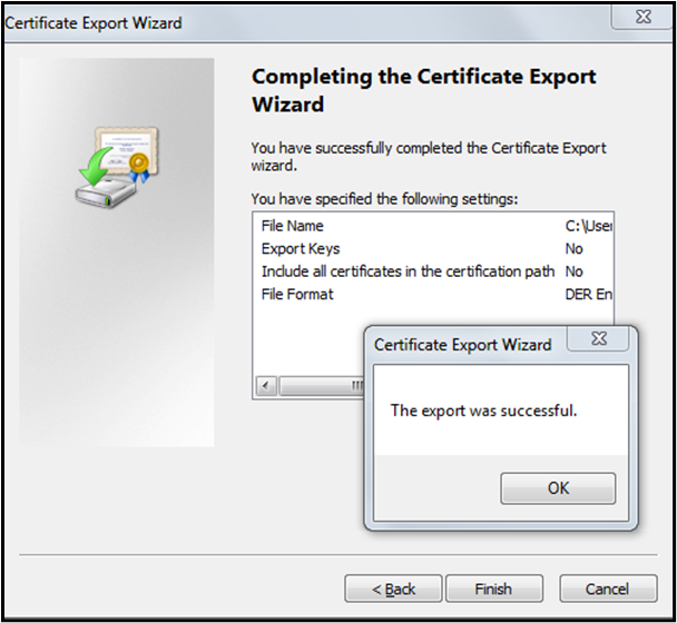

- A pop-up window appears showing the export was successful.
- Click OK.
