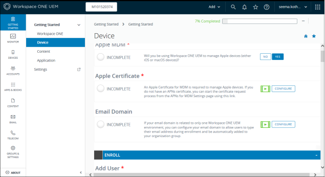

You can see that Apple MDM step is incomplete. If you will be using Workspace ONE UEM(AirWatch) to manage Apple devices click Yes.
Notes:- The following image shows that Yes has been selected.
- For devices other than Apple you need not perform the step.
Once you click Yes, a popup appears. Click Yes to navigate to Apple Push Notification Service (APNs) setup.

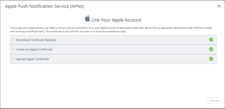

Apple Push Notification Service (APNs) setup:

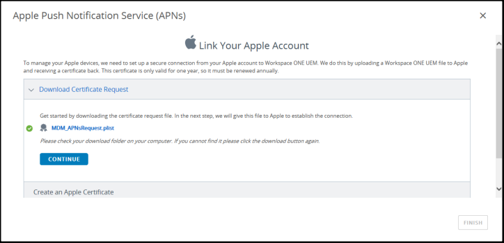

In the Download Certificate Request section, click MDM_APNsRequest.plist.
Click Continue.

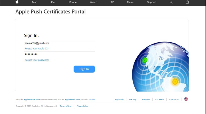

Provide your Corporate Apple ID. Click on Apple Push Certificates Portal.
Sign In to Apple Push Certificates Portal.
Enter the verification code shown on your trusted Apple device.

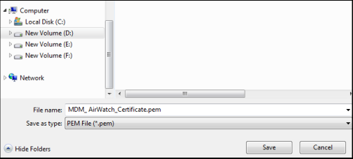

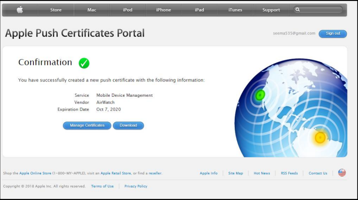

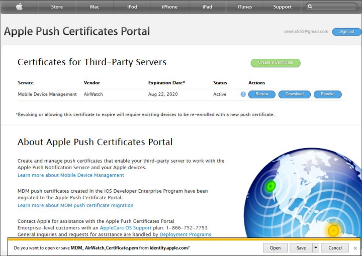

Click to Save your MDM_ AirWatch_Certificate.
Browse a file path to save MDM_AirWatch_Certificate.
You have successfully created a new push certificate Confirmation screen appears.

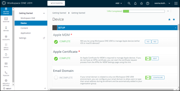

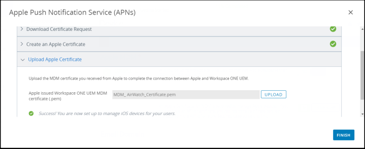

Go back to Workspace ONE UEM on the third step upload the Apple Certificate.
Go back to Workspace ONE UEM. On the third step upload the Apple Certificate.
Apple issued certificate is successfully uploaded to Workspace ONE UEM MDM.
Apple MDM step is now complete.

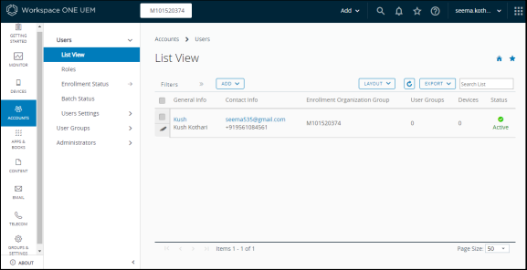

Next you can enroll users.

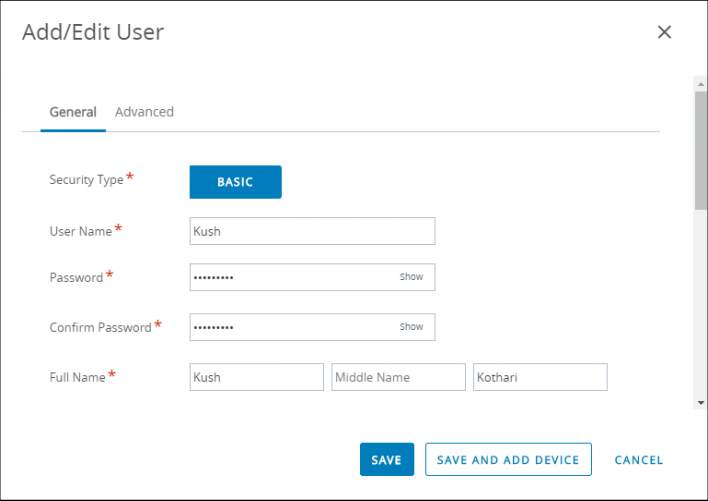

Provide the general user information.
Provide Advanced Information.
Enroll Device for the newly enrolled user.
User is enrolled.

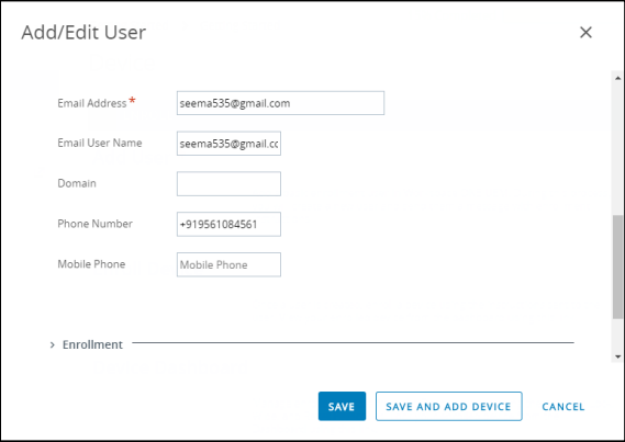

Go to the Enroll section and Add User. Add user to a Custom User Group. During this process you add a user and a Message sent to the user with enrollment instructions.

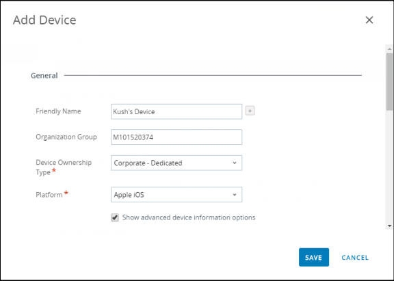

The next step is to complete Enroll Device as shown in the following image:
Enrollment user receives email for Device Activation.

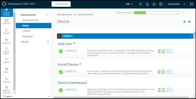

You can view your devices on the Device Dashboard. You can also start using Intelligent Hub and see Enterprise Applications as per roles assigned to the Custom User Group.
You can now start using the AirWatch Plugin steps.
