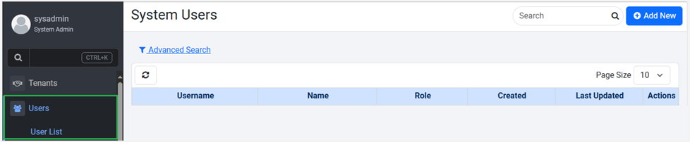

  1. Navigate to the Users -> User List menu. The System Users page appears.
    SystemUsers
    Users -> User List -> System Users page

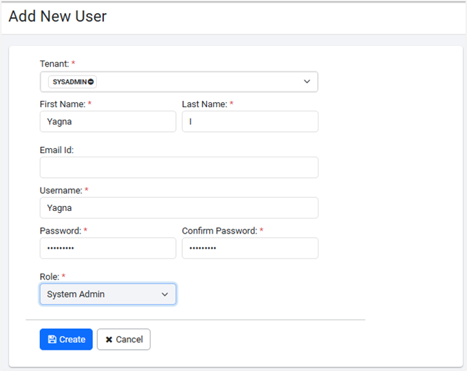

  2. Click Add New. The Add New User dialog appears.
     AddNewUser
    Add New User dialog
  3. Enter the field details:
Field Name Description
Tenant* Select the tenant under which you want to add the system user.
First Name* Enter a first name for the system user.
Last Name* Enter a last name for the system user.
Email Id Enter the system user’s email ID.
Note: -If you enter the email ID, then the Send verification link over email checkbox is available.
Send verification link over emailSelect the checkbox to send a verification email link to the user. Users can verify the sign in details through the link, which will activate the user account. Users will receive message confirming that the verification is successful.
Users can also reset their password after they activate the account.
Important: To use the field, the user must set the email configuration details in the Email Configuration section.
The link will be active for 24 hours only.
Note: Ensure that the proper URL is added to the ae.portal.baseURL property in the ae.properties file. Reach out to your support team if you face any issues when accessing the URL.
Username* Enter the system user’s sign in name.
Password* Enter the password with which the tenant user will sign in.
Confirm Password*Reenter and confirm the password with which the system user will sign in.
Role* Select the role you want to assign to the system user. Select from:
License Admin or System Admin.
* indicates a mandatory field.**
  1. Click Create. The user is created and the details are displayed on the System Users page.

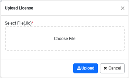

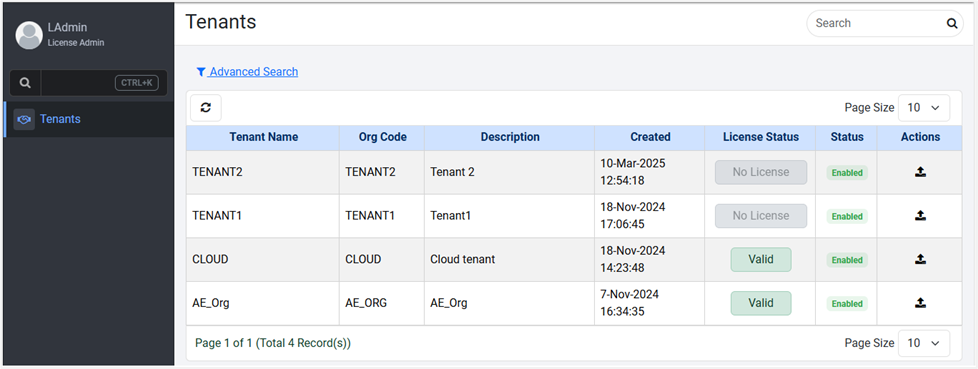

Upload license
You can upload a license for the tenant if you are assigned the License Administrator role. The System Administrator can create users with a License Administrator role.
For details about the License Administrator role, see Roles → System Defined Roles.
To upload a license
  1. Sign in as License Administrator. The Tenants page appears.
    alt text
    License Admin sign in → Tenants page
  2. On the page, select the tenant for which you want to upload the license, and then in the Actions column, click alt text. The Upload License dialog appears.
    alt text
  3. Click Choose File. The file open dialog appears.
  4. Select the license file, and then click Upload. The license is uploaded for the selected tenant.

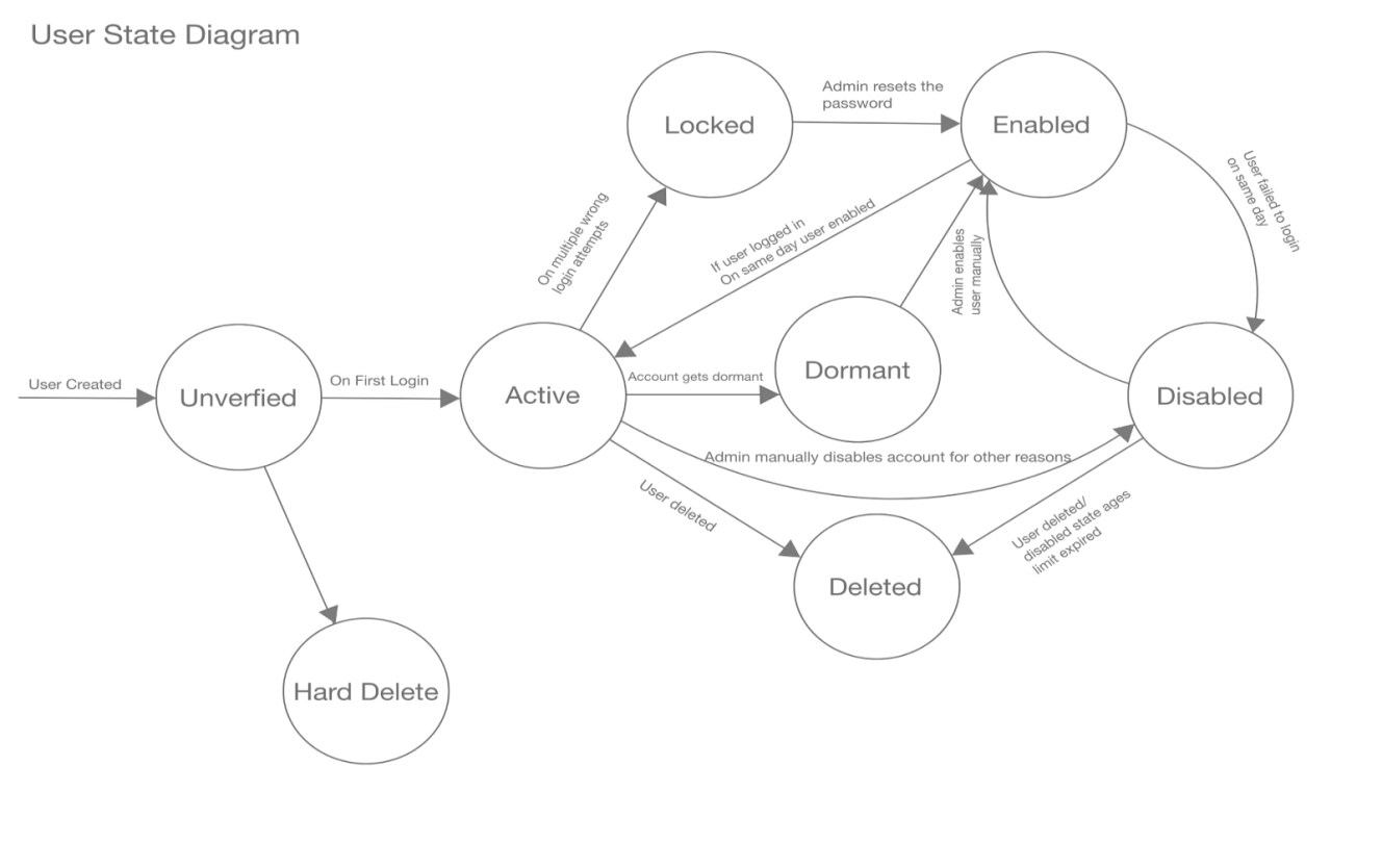

Understand Tenant User State
In the topic, you will learn about the various tenant user states.
Following are the possible states of the user accounts:
  • Unverified
    A newly created user account is an UNVERIFIED state. When the user tries to log in for the first time, a dormancy check is applied, and if the account happens to be dormant, then the account state changes to DISABLED otherwise, to ACTIVE.
  • Active
    A user performs in a usual way when in this state.
  • Locked
    A user account locks on crossing the max Number of Attempts for unsuccessful login set in the Settings -> Sysadmin Policy. The schedules configured by the locked user may continue to run.
  • Dormant
    If a user account has had no activity for an extended period, it goes to the dormant state. Set the Dormancy Period (In months) in the Settings -> Sysadmin Policy (after which if an account has had no activity becomes dormant). A dormant account can be enabled or disabled by the System or Tenant Administrator.
  • Disabled
    A user can be manually disabled. A confirmation pop-up for disabling user displays. If a user is disabled, their schedules get automatically disabled.
  • Deleted
    A User Account is in the DELETED state when an Administrator deletes the account. The User is soft-deleted (Disabled in the background). This state is not display on the UI.
  • Enabled
    A user can go to enabled state from disabled, dormant or locked state. Once the user logs in, the state changes from Enabled to Active.
    User States Inter relationships
    Check the following image that depicts the inter relationship between the User States,
    IMG_256
User State inter-relationships representation
User State -- Login behaviour

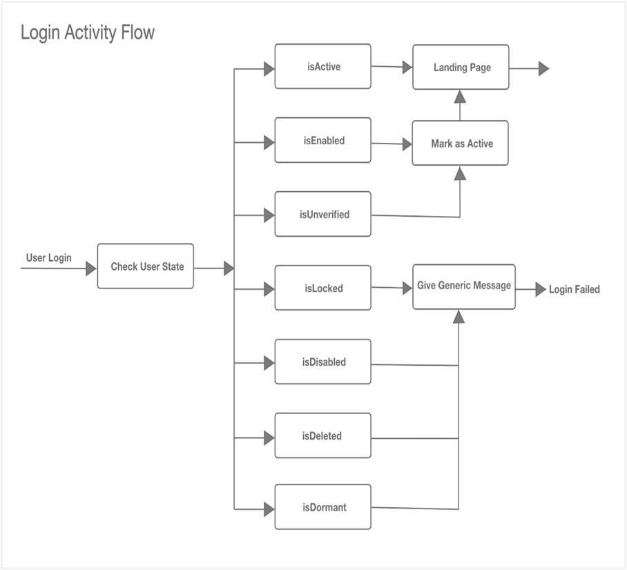

Additionally, to complement the previous User State interrelationship diagram, the following diagram illustrates the login behavior of users within various states.The diagram depicts the different user states.
alt text
User login activity
  • If the user is in Active state, then after login, user goes to the AutomationEdge UI landing page.
  • If a user is in an Enabled or Unverified state upon login, user account is marked as Active and user goes to the AutomationEdge UI Landing page.
  • If a user is in Locked, Disabled, Dormant or Deleted state, then after login, a generic failure message appears.
To change the state of any user, click the state link in the Status column complete the steps to change the user state.

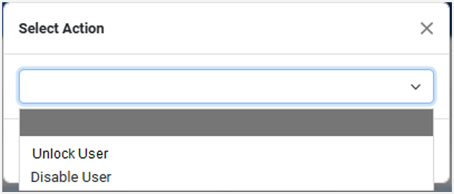

Unlock User
The System Administrator can unlock Admins and other tenant users.
To unlock a tenant user:
  1. In the menu, click Users -> Tenant Users menu. Tenant users page appears.
  2. In the Status column, click the LOCKED link corresponding to the tenant user you want to unlock. A Select Action dialog appears.
    IMG_256
Select Action Dialog

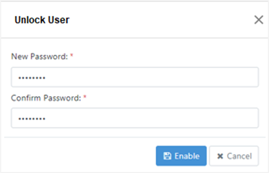

  1. In the dialog, select Unlock User. The Unlock User dialog appears.
alt text
Unlock User Dialog
  1. Enter the new password and confirm password. A User unlocked successfully message appears, and you are taken back to the login page.
  • After the user signs in to AE, you need to change the password, and the user state changes to ENABLED.
  • Sign in again after changing the password, and the user state changes to ACTIVE.

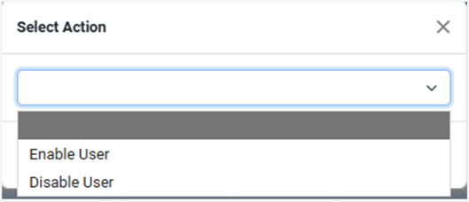

Enable User
You can enable dormant or disabled tenant users.
To enable a tenant user:
  2. In the Status column, click the DORMANT Or DISABLED link corresponding to the tenant user you want to enable. A Select Action dialog appears.    IMG_256

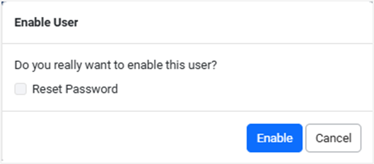

  1. In the dialog, select Enable User, and then click Next. The Enable User pop-up appears.
IMG_256
Enable User pop-up
  1. Click Enable. User enabled successfully message appears.

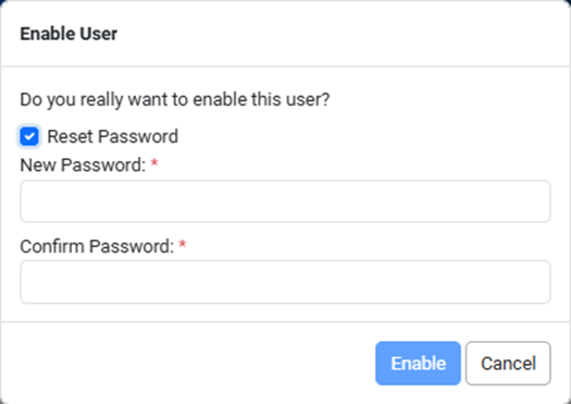

  • Sign in with the user credentials. After signing in, change the password and the user state changes to ACTIVE.
  • You can also enable a dormant or disabled user and then select Reset Password checkbox for a new password, if required. Enter the new password, and then click Enable.
Enable User
Enable User Dialog
  • The Reset Password option is unavailable for SSO and LDAP users.

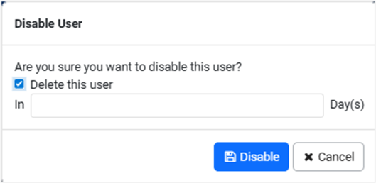

Disable or Delete User
System Administrators can manually disable or delete active users.
To disable or delete a tenant user:
  1. In the menu, click Users->Tenant Users. Tenant Users page appears.

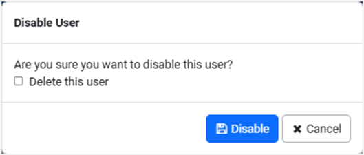

  2. In the State column, click the ACTIVE link corresponding to the tenant user you want to Disable or Delete. A Disable User dialog appears.
    DisableUser
    Disable User Dialog
  3. Click Disable. User account disabled successfully message appears.
  • If you select the Delete this user checkbox, then you need to provide a period in days after which the user is deleted (it is a soft delete).
Delete User CheckBox
Disable User dialog
  • After deletion you cannot restore the user account.
  • Deleted state is not displayed on UI.

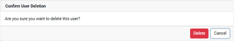

Delete tenant users
You can delete the tenant users, if required.
To delete tenant users:
  1. In the menu, click Users -> Tenant Users. The Tenant Users page appears.
  2. On the page, select user you want to delete, and then in the Actions column, click Dustbin . The Confirm User Deletion dialog appears.
alt text
  1. Click Delete. User deleted successfully message appears.
