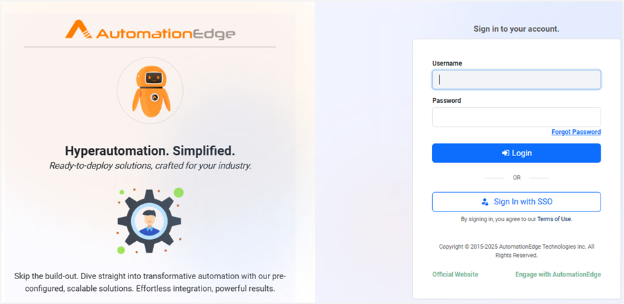

To log on to AutomationEdge:
  1. In the browser's address bar, enter the AutomationEdge URL.For example, http://localhost:8080/aeui.  The AutomationEdge Login page appears.
    alt text
    Login page
Field name Description
Username  Enter the name of the user with which you want to log on to the application.
Important: AutomationEdge provides the default, super user with the System Administrator’s role. The username is sysadmin. You cannot delete the sysadmin.
Note: If required, you can create users with System Administrator role. For details, see Add new users.
Password Enter the password to log on to the application.
Note: The default password for System Administrator, sysadmin is vY78_h$ia. After the first-time login, you will be prompted to change your password.

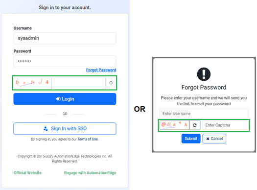

If the captcha property is enabled, that is, set to true in the aeui-config.properties file, then the captcha text appears on the login and forgot password pages. For more details, see the AutomationEdge Installation guide.
#This key is used to enable Captcha for UI. If Value is true, then Captcha will be enabled otherwise captcha is disabled.
enableCaptcha = false
Enter the captcha text along with the username and password, as shown in the following screenshot:
alt text
Captcha

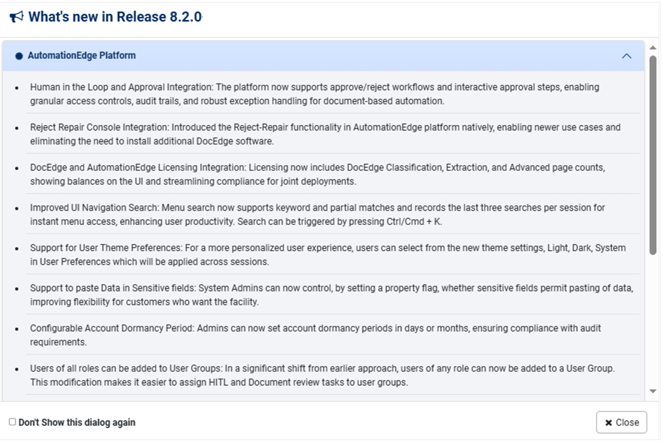

  1. Click Login. The Release Notes dialog appears.
alt text
Release Notes: Informing what’s new in the current release
  • To dismiss the Release Notes dialog, click Close.
  • The dialog appears each time you log on to AE UI. However, if you select the Don’t show this dialog again checkbox, then the dialog will not appear when you log on again. After you select the checkbox, when you again log on to AE UI you will see the Home page.
  • To view the dialog again, select What’s New in v<current release> in User profile.

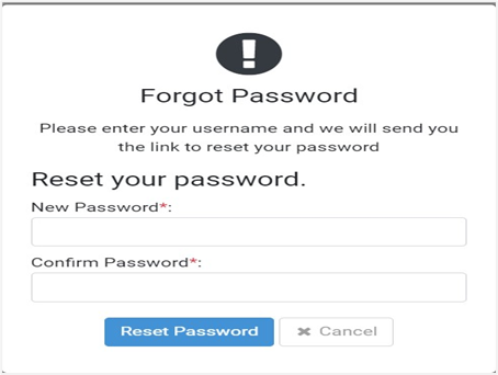

  1. In the username box, provide the name of the user, and then click Submit. The user will receive a link to reset the password.
  2. Click the link. The Reset your password dialog appears.
alt text
Forgot Password dialog: Reset your password
  1. Enter the password in the New Password and Confirm Password box, and then click Reset Password. The new password is saved.

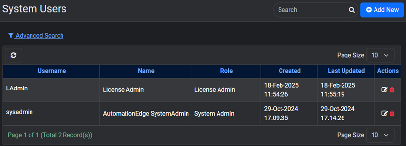

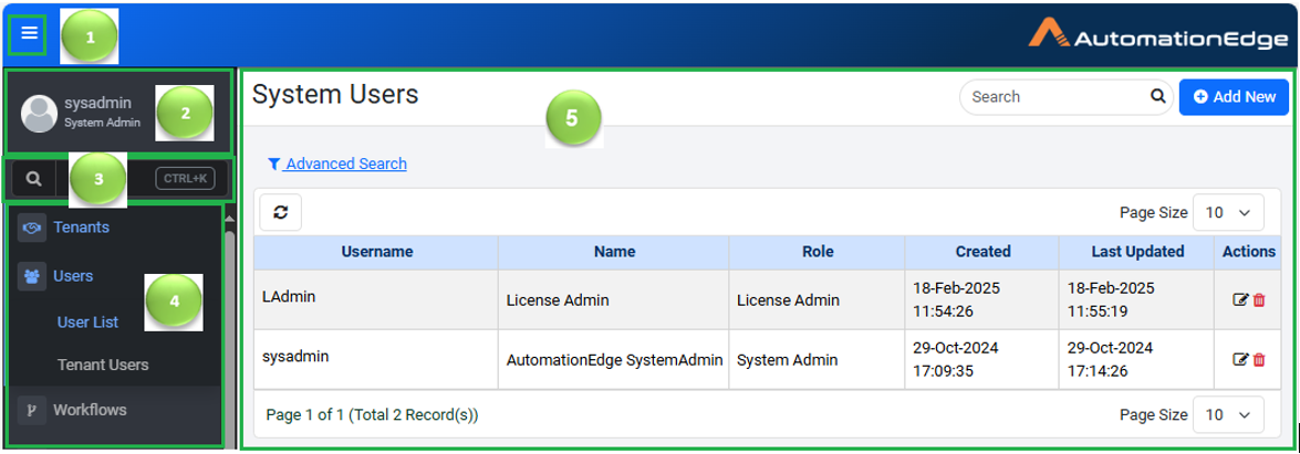

Understand the user interface (UI)
The topic provides an overview of the AE user interface. Understanding the UI will help you in navigating through the application.
IMG_256
User interface
LabelInterfaceUsage
alt textToggle navigation menuToggle the navigation menu,that is, hide or unhide the menu.
alt textUser profile menuView login details and user profile, and change user password.
alt textSearchEnter and search for the navigation menu in the Search box.
Use CTRL+K as a shortcut to open the search dialog.
alt textNavigation menuClick each menu option to work with each menu.
alt textWorkspacePerform various actions depending on the selected menu.

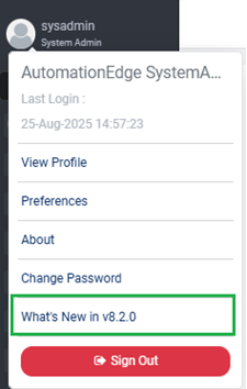

User Profile
After you sign in to AE UI, click the user name and view your sign in details, the user profile, the application details. You can also change your password.
User sign in details
You can view the details, such as username, user role, and the last login details that includes, date and time
alt text
User profile menu

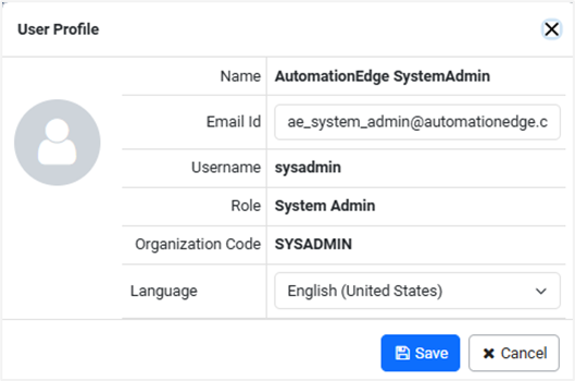

View Profile
You can view the user profile.
To view user profile:
  1. Click the User Icon on the top left corner of the AE UI page. The menu appears.
  2. In the menu, click View Profile. The User Profile dialog appears.
alt text
User Profile dialog
  1. Modify the following fields, if required:
    Email Id: Enter the email address.
    Language: Select the language for localization, if required. Else, the browser language settings are applied, by default.
Organization Code refers to the Tenant.

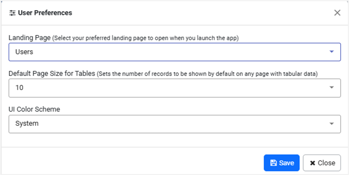

Preferences
User preferences help create personalized, efficient, and user-friendly experiences with respect to settings in AutomationEdge UI.
To set user preferences:
  2. In the menu, click Preferences. The User Preferences dialog appears.
alt text
User Preferences
  1. Select the following field details:
  • Landing Page: Select the option for your preferred landing page which opens when one logs into the system. For example, if you select Users as the landing page in the User Preferences dialog, then on signing in again to AE, you will see the Users->User List->System Users page as your default home page.
alt text
User Preferences: Landing Page
  • Default Page Size for Tables: Select the number of records you want to view on any page. For example, you can select to view 10 or 15 or 20 or so on records in a tabular format on a page. The default page size is 10 records.
  • UI Color Scheme: You can set the theme for the application to enhance the view, if required. Choose the theme that best suits your preference from the following available options:
  • Light: Applies a light-colored interface for better visibility in bright environments.
alt text
User Preferences: UI Color Scheme: Light
  • Dark: Applies a dark-colored interface to reduce eye strain, especially in low-light conditions.
alt text
User Preferences: UI Color Scheme: Dark
  • System: Automatically matches the theme with your device's system settings.
alt text
User Preferences: UI Color Scheme: System
The default color scheme of the application is System.
  1. Click Save. The details are saved.

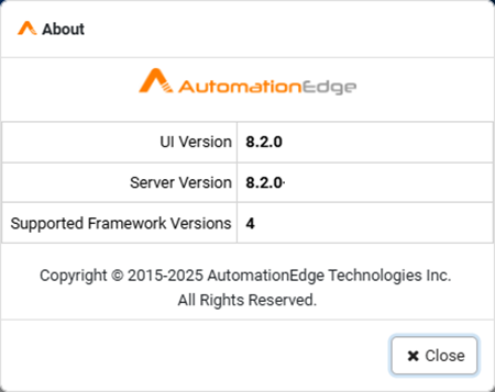

About
You can view the AE application details.
To view the application details:
  2. In the menu, click About. The About dialog appears.
alt text
About dialog
  1. View the following details:
  • UI Version: Displays the current AE user interface version.
  • Server Version: Displays the current AE server version.
  • Supported Framework Version: Displays the current Process Studio framework.

What’s new in v<current version>
Click to reopen the Release Notes dialog.
alt text
What’s New dialog

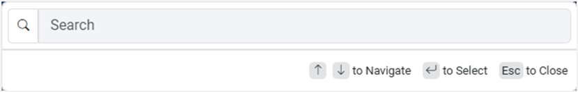

Use the Search feature to search and navigate to menu and submenu options with ease.
The spotlight search allows you to enter keywords to filter and display a list of matching navigation options. The search matches keywords against the Menu ID, ID, menu title, and any associated tags to the tabs.
To search a menu or submenu option
  1. After signing in to AE UI, in the left pane, click in the search box OR press CTRL+K.
    The Search dialog appears.
alt text
Search dialog
  1. Enter the name of the menu that you want to navigate to, for example, configuration.
    Menus and submenus having configuration in their name are listed.
alt text
Search dialog
  • Use ↑ to navigate in the ascending order through the search list.
  • Use ↓ to navigate in the descending order through the search list.
  • Press Enter or click an option from the list to select it.
  • Press Esc or click anywhere outside to close the search dialog.

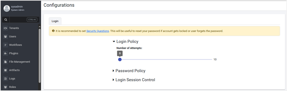

  1. Select and click OR press Enter to navigate to the selected menu, for example, Configurations (Settings > Configurations). The selected menu page appears.
alt text
Configurations page
