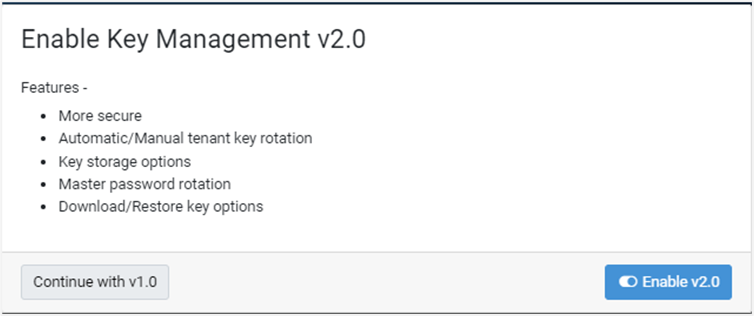

  2. Click Upgrade to v2.0. The Enable Key Management v2.0 dialog appears.
  3. Click Enable v2.0. The Enable Key Management v2.0 dialog field appears.

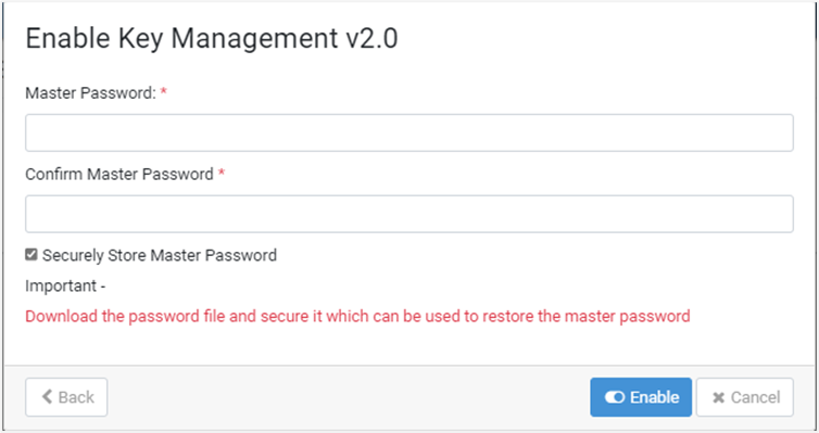

  4. In the dialog, enter the following field details:
    FieldsDescription
    Master Password*Enter a unique password as your master password.
    Confirm Master Password*Re-enter the master password
    Securely Store Master PasswordSelect the checkbox to save your master password in the AeKey.ask file, which you can download.
    Note: The password is saved in the AeKey.ask file, which you can download. For details, see Master Password.
    * Indicates mandatory field.
  5. Click Enable. The Key Management page appears, and the Master Password option appears in the menu pane.

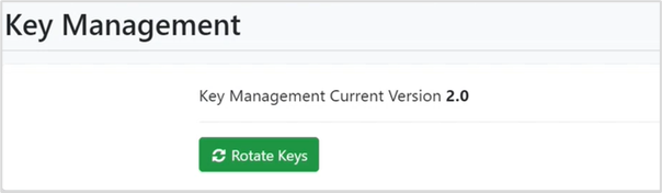

  6. On the Key Management page, click Rotate Keys. The Sysadmin key encryption key (tenantid = 1) is rotated or modified. Rotating the keys enhances the security of the user account. Key Management Rotate Keysalt text

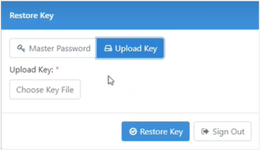

However, if you have downloaded the key file then you can upload the file through Upload Key when you restart the system.
Restore Key Upload Key tab
Restore Key dialog -> Upload Key tab
To restore the key, click Restore Key after entering the key or uploading the key file.

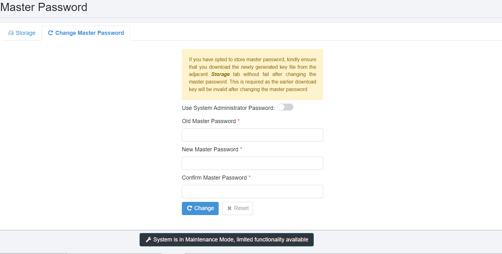

To change the master password:
  1. In the menu, click Key Management → Master Password. The Master Password page appears.
  2. On the page, click the Change Master Password tab. The change master password field details appear.
Master Password  Change Master Password tab
Master Password -> Change Master Password tab

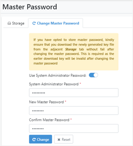

  1. You can change the master password in any of the following way:
    Use the System Administrator Password:
    Change master password with System Administrator Password
    Change master password with Use System Administrator Password option
    FieldsDescription
    Use system Administrator passwordToggle the switch if you want to use the system admin password as Master Password.
    Note: If you are using the system admin password as your master password, then the Old Master Password field name changes to System Administrator Password.
    System Administrator Password*Enter your system administrator password that you want to reset.
    New Master Password*Enter the new password you want to set
    Confirm Master Password*Re-enter new password for confirming the new password.
    Directly enter the old master password, new master password, and confirm the master password.
    MasterPasword
  2. After entering the new password details, click Change. The new master password is saved.
Click Reset to reenter the details.
