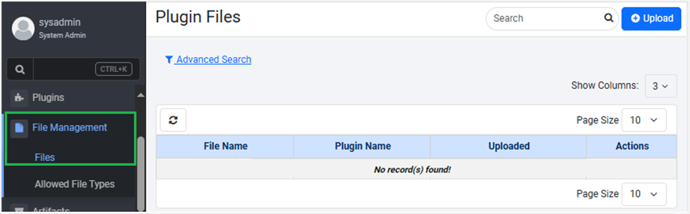

  1. In the menu, click File Management -> Files. The Plugin Files page appears.
    Plugin Files

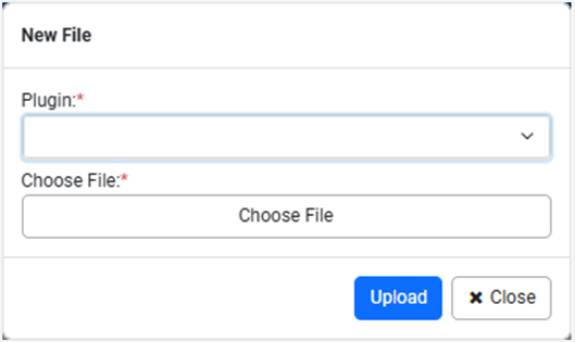

  2. On the Plugin Files page, click Upload. The New File dialog appears.
    New File
    The New File dialog
  3. Click in the Plugin box. The list of plugins for which you can upload the supporting files appears.
    To select multiple plugins, select the respective plugin checkbox.
  4. Select the plugin, and then click Choose File. In the Open dialog select the zip file you want to upload.
  5. Click Upload. The supporting file is uploaded.

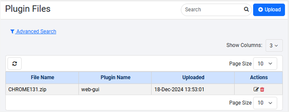

    Plugin Files Upload
    Plugin Files: The uploaded support file view

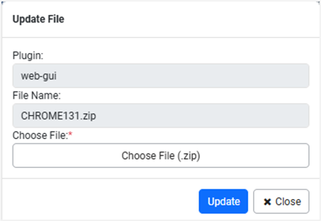

  • To update the existing plugin supporting file, in the Actions column, click edit . In the Update File dialog, select the updated file and then click Update.
    Update File
    Update File dialog

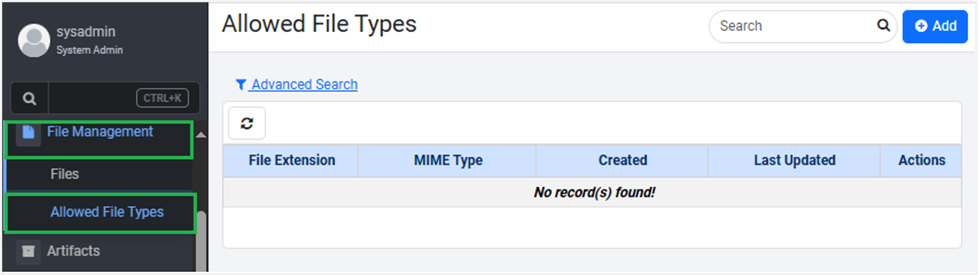

  1. In the menu, click File Management -> Allowed File Types. The Allowed File Types page appears.

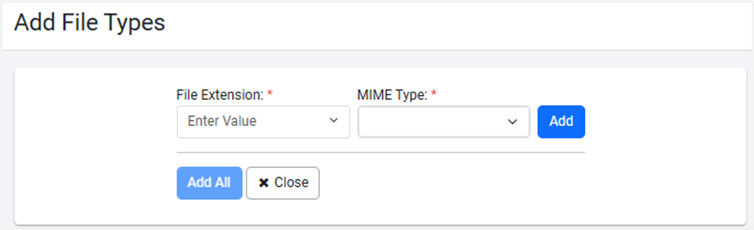

  2. Click Add. The Add File Types page appears.
    Add File Types dialog
    File ExtensionEnter the type of file you want to add to the list. For example, pdf.
    MIME Type*Enter the type of MIME you want for the file extension.
    Note: You can select multiple file extensions.
* Indicates mandatory field.
  1. Click Add. The extension list is created.
  2. Click Add All. The extensions appear in the list on Allowed File Types page.
