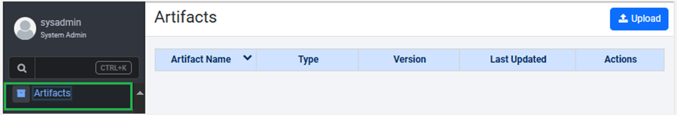

  1. In the menu, click Artifacts.The Artifacts page appears.
    Artifacts page
    Artifacts page

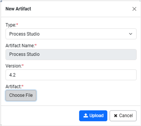

  2. Click Upload. The New File dialog appears.
    New Artifact dialog
    New Artifact dialog
    Type*Select the artifact type you want to upload. Available artifact types are:
    Process Studio
    Files
    Note: If you select None, a message informing you to select another artifact type appears.
    Artifact Name*Displays the name as Process Studio, if the selected Type is Process Studio.
    Enter the name of the artifact, if the selected Type is Files.
    Note: The option to upload various artifacts for Type Files will be available in upcoming releases.
    Currently, you can upload Process Studio only.
    Version*Enter the version of the artifact you want to upload.
    Artifact*Click to select the artifact, that is, Process Studio.
    * Indicates mandatory field.
  4. Click Upload. The artifact is uploaded to AE server.
