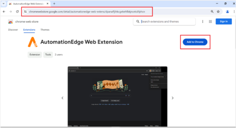

  1. Open MS Edge/Google Chrome browser.
  2. Enter Web store extension URL in address bar: chromewebstore.google.com/detail/automationedge-web-extens/dpanaffjihkcgekehfbkjncekdifphcn
  3. Chrome web store page opens. Click Get/ Add to Chrome.

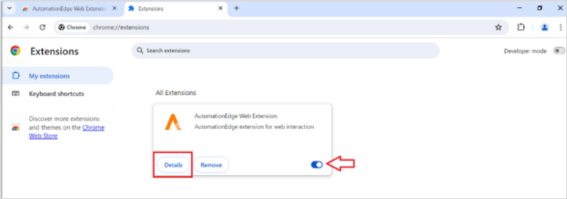

  1. After download and installation complete, go to Settings > Extensions > Manage Extensions.
  2. Enable AutomationEdge Web Extension vX.X.X.

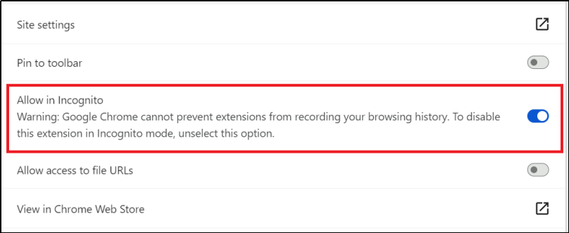

  1. Click Details and then toggle the Allow in Incognito mode switch. The extension will work in the incognito mode for Web technology.

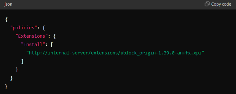

Step 1: Create the policies.json File
  1. Create the JSON File:
  • Open a text editor and create a new file named policies.json/
  1. Add Extension Configuration:
  • Add the necessary JSON configuration for the extensions you want to install. Here’s an example for installing the "uBlock Origin" extension:
JRE icon
  • Adjust the URL to point to your internal server or file share where the .xpi file is hosted.
