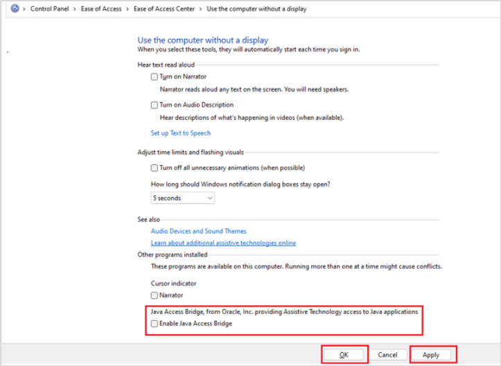

Enable Java Access Bridge
To enable JAB: 1.Click Start → Control Panel → Ease of Access → Ease of Access Center → Use the computer without a display. The details page appears. 2.In the details page, scroll down and then select Enable Java Access Bridge checkbox. JAB is enabled.
