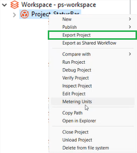

To export a project:
  1. In Process Studio, select File and then click Export Project. The Export Project dialog appears.
    You can also export a project using any of the following ways:
    • The contextual menu:
    • Click Project Options on the Status bar. The Export Project menu is available only if workflows or processes are open on the canvas.

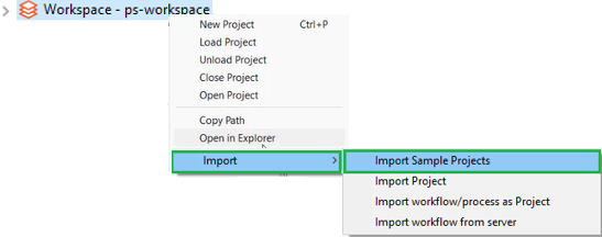

Import sample projects
Before creating a new project, you can work with sample projects. Sample projects are bundled with your Process Studio and are available in the ps-home/samples directory. You can import the projects using the Import 🡪 Import Sample Projects option in the contextual menu.
The Import Sample Projects option is unavailable, if the ps-home/samples directory is not present or is empty.
Import Sample Projects contextual menu
If the project already exists in the currently open workspace, then the imported project is added to the workspace with a number suffixed after the project name. For example, the existing project name, HelloWorld, the imported project name will be HelloWorld_1.

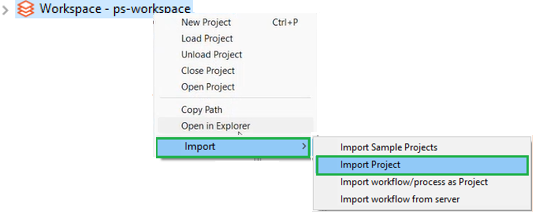

Import project
You can also import existing projects from other workspaces to your current workspace.
To import existing project from other workspaces:
  1. In Process Studio, click File and select Import. The sub-menu appears.
    You can also import a project using any of the following ways:
    • Click Project Options on the Status bar. The Import Project menu is available only if no workflows or processes are open on the canvas.
  2. Click Import Projects. The Import Project dialog appears.

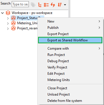

To export a project as shared workflow:
  1. In the Project Explorer, select and right-click on the project from which you want to share the workflow. The contextual menu appears.
    Export as Shared Workflow contextual menu
  2. Click Export as Shared Workflow. The Configuration dialog appears.

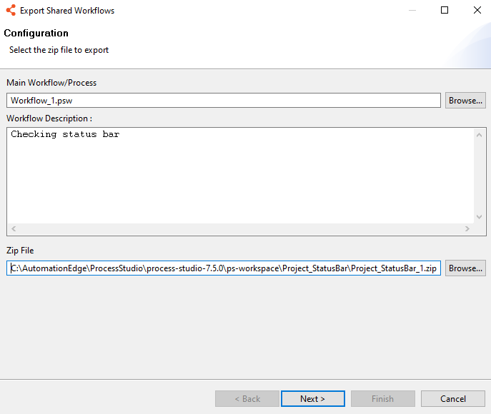

    Export Shared Workflows – Configuration dialog
  3. Enter the field details.
    FieldDescription
    Main Workflow/ProcessDisplays the main workflow name already set for the project.
    NOTE: To modify the details, click Browse and select another workflow or process from the project.
    Workflow DescriptionEnter a description about the workflow.
    Zip FileDisplays the zipped project folder path of the workflow you want to export.
    NOTE: To modify the details, click Browse and select another zipped project folder.

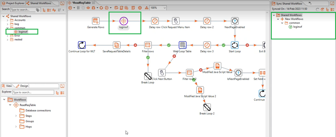

    • The shared workflows appear in the Shared Workflows tab in the Process Studio.
    • After syncing the shared workflows, you can drag and drop the shared workflows on to the canvas, and it appears as a workflow or process executor.
    • For details about uploading the shared workflows to the AutomationEdge UI, see Workflows 🡪 Shared in the AutomationEdge user’s guide.

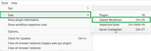

After uploading shared workflow through the AutomationEdge UI, you can sync the shared workflows using the Sync Shared Workflows feature. The shared workflows appear in the Shared Workflows tab.
Similarly, you can also sync and work with shared processes.
To sync and use the shared workflow:
  1. In the Process Studio, click the Sync Shared Workflow pane. The list of shared workflows that need to be synced appears.
    Sync Shared Workflows pane
  2. Click Tools 🡪 Sync 🡪 Shared Workflows. The workflows are synced.
    Sync Shared Workflows via Tools menu
  3. Drag-and-drop the shared workflow on to the canvas, which becomes the workflow executor step.
    Shared workflow as workflow executor on canvas
