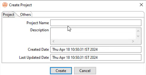

  2. Select New Project. The Create Project dialog appears.
  3. In the respective tabs, enter the field details.
    FieldDescription
    Project tab:
    Project NameEnter the name of the project.
    NOTE: It is recommended not to use special characters in your project name.
    DescriptionEnter a description of the project.
    Created DateDisplays the project creation date and time.
    Last Updated DateDisplays the date and time when the project was updated.

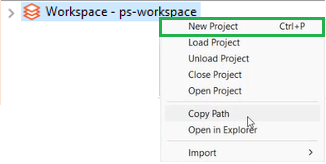

    You can also create a project through the contextual menu.
