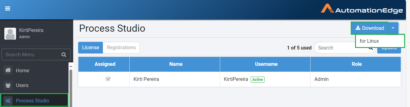

  1. Sign in to the AE UI as the Admin and go to Process Studio. The Process Studio page appears.
    img Process Studio page in AutomationEdge UI
  2. In Process Studio Registration page, click Download. The Process Studio zip is downloaded for Windows.
    • To download Process Studio for Linux, click the corresponding dropdown.

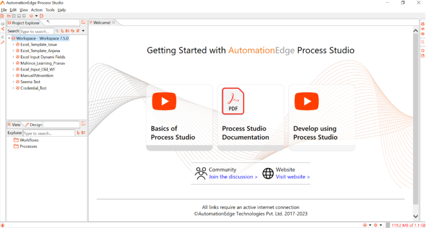

When you sign in to the Process Studio, by default, the Welcome tab is open in the canvas. The page provides links to training videos and Process Studio documentation. img

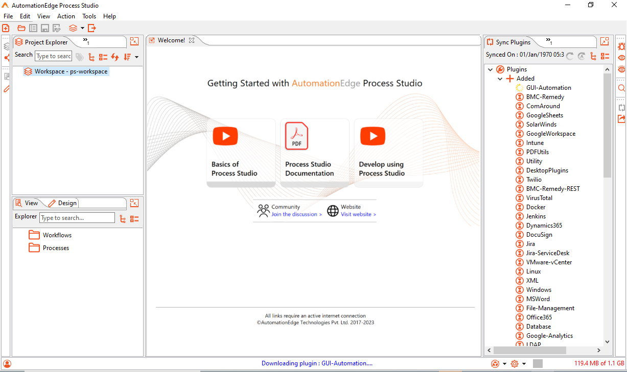

After the Process Studio opens, you will see the list of plugins in the Sync Plugins pane. For details on synchronization of plugins, see Synchronize Process Studio with AE.

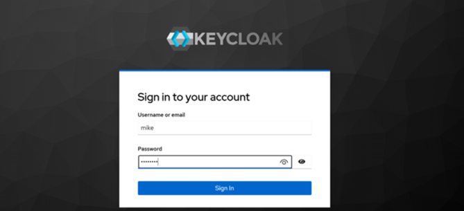

  1. Start Process Studio, click Sign In with SSO. Organization code dialog appears.
  2. In the dialog, enter the organization code. You are redirected to IDP through the system's default browser.
Additional Redirect URI need to be added to IDP settings to support PS SSO login. Example: http://localhost:2611/callback
KEYCLOAK
SSO sign-in page
  1. Enter Username or email and password. You are logged in to Process Studio. You can close the browser window on successful login.

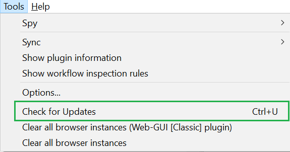

  2. You can also check for updates, manually, through the Tools menu in Process Studio.
    i. In Process Studio, click Tools and select Check for Updates.
    A screenshot of a computer Description automaticallygenerated
    Check for Updates option in Tools menu
    ii. If Process Studio is already up-to-date, a No updates available, message appears. Click OK to close the message. And if updates are available then, Process Studio is updated and restarted.

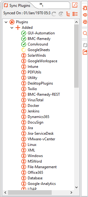

Synchronize plugins automatically
When you sign in to the Process Studio, it automatically checks for any plugin updates and synchronizes the plugins.
You can view the new, updated, or deleted plugins in the Sync Plugins pane. In addition, you can also view the list of updated or deleted files.
Sync Plugins view
  • : Indicates plugin sync is successful.
  • : Indicates the plugin sync is in-progress.
  • : Indicates plugin sync awaited.
You can continue working with the Process Studio even when the syncing of new plugins is in-progress. The Process Studio does not restart if plugins are added. However, if a plugin is updated or deleted you are requested to restart the Process Studio.
  • Existing workflows or processes in the Process Studio display a message informing about missing plugins. After the sync is complete the workflow or process will work as expected.
  • When plugin sync is in-progress you cannot perform server activities, such as publishing workflows, checking for updates, switching workspace, or again syncing the Process Studio.

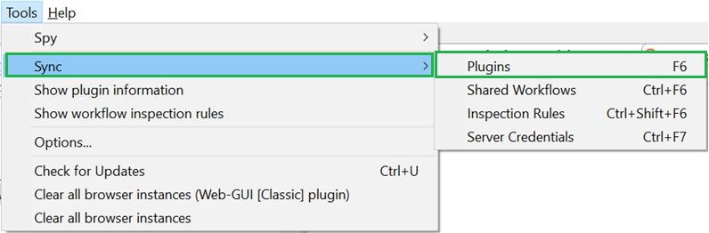

You can synchronize plugins manually through Process Studio.
To synchronize plugins:

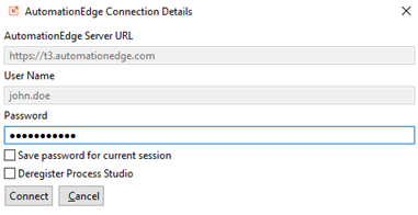

  1. Open Process Studio, go to Tools → Sync → Plugins. The AutomationEdge Connection Details dialog appears.
    Sync Plugins option in Tools menu
  2. In the dialog, enter the password, and click Connect. If updates are available, a message confirming the updates appears.
  3. Click OK. The plugins are updated and Process Studio restarts.

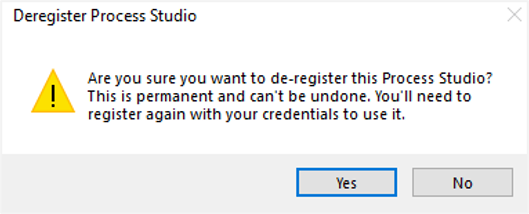

  1. In Process Studio, select on the toolbar. Deregister Process Studio dialog appears.
alt text
Deregister Process Studio confirmation dialog
  1. In the dialog, click Yes. The process is initiated, and a message confirming the deregistration appears.
You don’t need to enter any credentials when initiating the deregistration process.
  1. A dialog confirming the deregistration appears. Click OK to close the message.
