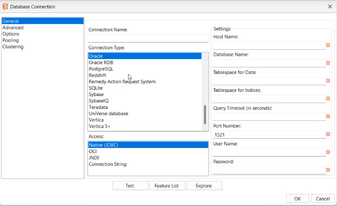

  3. In the first pane, select the connection you want, that is, General or Advanced or Options or Pooling, or Clustering. The fields in the second and third pane of the dialog change depending on the connection selected.
  4. Enter or select the details in the fields, as required.
    Connection NameEnter a name for the database connection.
    Connection TypeSelect the type of connection you want for the database. For example, PostgreSQL.
    AccessSelect the type of access you want for the database. Available options are:
    - Native (JDBC)
    - OCI
    - JNDI
    - Connection String
    The availability of options depends on the type of connection selected. For example, when you select Connection String, the Connection String dialog appears. Enter the connection string and click Finish.
    SettingsEnter the field details, as required.
    - The fields available under Settings change depending on the type of connection and access selected.
    - The Query Timeout (in seconds) field is available only if you select Native (JDBC) or Connection String access option.
  5. Click Test to verify that the database connection is complete.
  6. Click Feature List to view the list of features.
  7. Click Explore to view the components, such as tables and views, of the selected database.

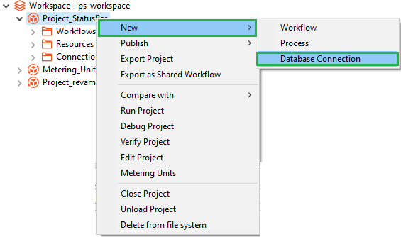

  • In the Project Explorer, select ProjectNewDatabase Connection
    Project → New → Database Connection
  • In the Project Explorer, select WorkspaceProjectRight click on ConnectionsNew Database Connection
    Workspace → Project → Connection → New Database Connection
  • In the Project Explorer, select WorkspaceProjectConnectionsRight click on Database connectionNew Database Connection
    Workspace → Project → Connections → Database → New Database Connection
  • In the Project Explorer, select WorkspaceProjectConnectionsDatabaseRight click on database connectionNew
    Workspace → Project → Connections → Database → Database connection → New

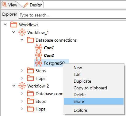

Share a local database connection
To share a local database connection, right click on local connection -> Share.
If you duplicate a local connection and make it a shared database connection, then the shared database connection overrides across the connection in workflows and processes in the project.
