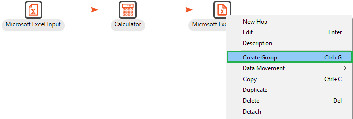

You can group the steps in following ways:
  • Based on function, such as Input, Output, Scripting, and so on.
  • Based on the target system, such as MSSQL, Active Directory, Solar Winds, Microsoft Azure, and so on.

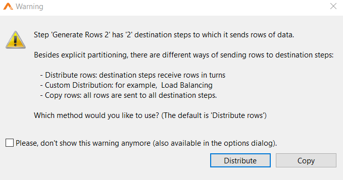

    If a step sends outputs to more than one step, the data can be copied to each step or distributed among them.

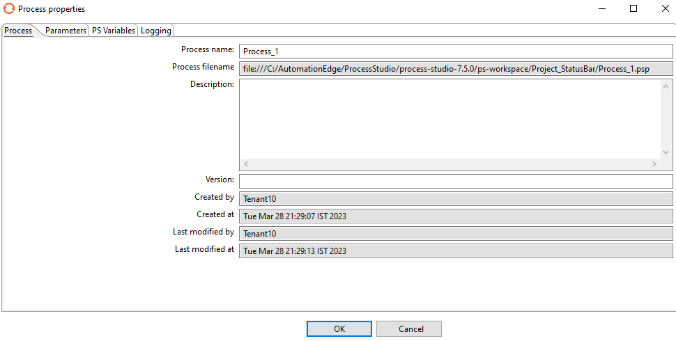

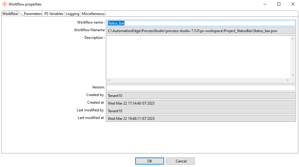

  6. Right-click on the canvas and select Properties or select CTRL+T. The Workflow properties dialog appears.
    You can also open the Workflow properties dialog through Edit 🡪 Settings... or double-click anywhere in the canvas.
  7. Specify the required details in the following tabs: Workflow, Parameters, PS Variables, Logging, and Miscellaneous.
    FieldDescription
    Workflow
    Workflow nameEnter a new name of the workflow.
    NOTE:
    If you modify the name of an existing workflow, then the name is also updated in the Project Explorer.
    Workflow filenameDisplays the path of the workflow.
    DescriptionEnter a description of the workflow.
    VersionEnter a version number.
    Created byDisplays the name of the user who created the workflow.
    Created atDisplays the date and time of workflow creation.
    Last modified byDisplays the name of the user who last modified the workflow.
    Last modified onDisplays the last workflow modification date and time.

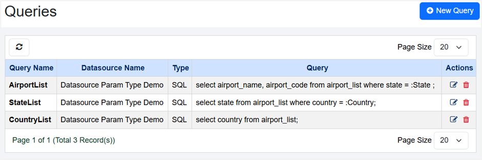

    For example, in the following figure, a query named AirportList has been defined on the server. Consequently, this exact value is entered into the Process Studio configuration to bind the parameter to the correct data source.
    alt text
    Figure 58: Snapshot of queries defined on AutomationEdge Server visible on AEUI on Reports -> Queries tab
    Query Name
    The Query Name field establishes the critical link between the workflow parameter in Process Studio and the SQL logic defined on the Automation Edge server. It tells the system specifically which pre-defined dataset to retrieve.
    To configure this, enter the name of the query exactly as it is listed in the AEUI Queries tab. This input acts as a strict identifier; the value provided here must match the server-side definition precisely—including casing and spacing—or the data retrieval will fail.

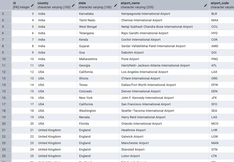

    Figure 59: Snapshot of Database table airport_list

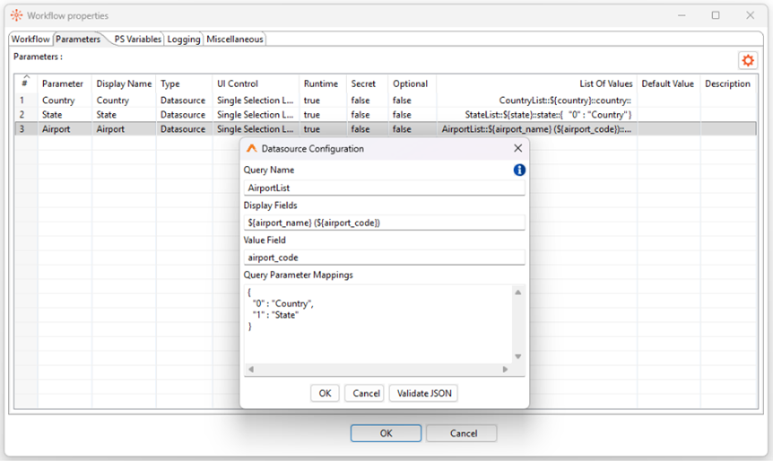

    Process Studio allows you to concatenate multiple columns or append static text to create a composite label. This is particularly useful when a single column provides insufficient context.
    alt text
    Figure 60: Snapshot of how Datasource type property is set in Process Studio Parameter
    - Configuration: As seen in the configuration window above, the Display Field is configured using the pattern ${airport_name} (${airport_code}).
    - Result: This configuration dynamically pulls data from both columns and formats it with parentheses.
    Static Text Example
    You may also include fixed text strings. For example, configuring ${country} displays simply India, whereas configuring Country is ${country} would display Country is India.
    Value Field
    The Value Field determines the actual data that the system captures and processes when a user makes a selection in the catalog. While the Display Field optimizes the user interface with readable text, the Value Field ensures that the backend workflow receives the correct technical identifier required for execution.
    Configuration
    To configure this field, enter the exact database column name that contains the data intended for processing (refer to Figure 59).
    - Syntax: Unlike the Display Field, do not use the $ notation or any special formatting. Simply input the raw column name.
    - Implementation: As illustrated in Figure 60, the value airport_code is entered into the Value Field. This tells the system to read from that specific column.
    Functional Example
    By mapping the value field correctly, you separate the user interface from the data logic:
    - User Selection (Display): The user selects Los Angeles International Airport (LAX).
    - System Input (Value): Because of the configuration in Figure 60, the workflow receives the value LAX (the data stored in the airport_code column) to use in subsequent automation steps.

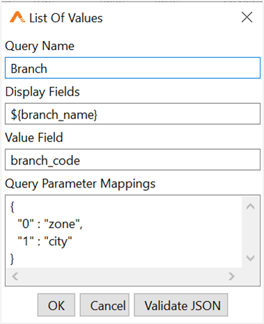

    The Query Parameter Mappings field is used to define dynamic dependencies between Datasource parameters. This configuration creates "cascading dropdowns," where the options available in one list change based on the selection made in a previous list.
    This feature allows you to build a hierarchy (e.g., Country -> State -> Airport). Users must select a value in the parent field before the dependent child field becomes active.
    Configuration Logic
    To establish this relationship, you must enter a JSON object that maps the hierarchy levels to the specific parameter names defined in your workflow.
    - Hierarchy Index (Key): Represents the level of the parent parameter. A lower number (e.g., "0") indicates a higher-level root parent (like Country), while a higher number (e.g., "1") indicates a strictly dependent parent (like State).
    - Parameter Name (Value): The exact display name of the parent parameter this field depends on.
    Strict Syntax Requirements
    This field requires valid JSON format. You must enclose both the Key (Index) and the Value (Parameter Name) in double quotes (""). Failure to use double quotes will cause the configuration to fail.
    Configuration Example
    In the scenario shown in Figure 60, we are configuring the Airport parameter. Because the list of airports depends on the State, and the State depends on the Country, we must map both dependencies.
    1. Define the Mapping: Enter the following JSON structure into the mappings field:
    JSON <br/> { <br/> "0": "Country", <br/> "1": "State" <br/> }
    2. System Interpretation:
    * "0": "Country" tells the system that Country is the root filter.
    * "1": "State" tells the system that State is the secondary filter.
    Connecting to Queries
    These mappings correspond directly to the SQL definitions shown in Figure 58. The SQL query for the Airport list expects specific inputs (like :State); the JSON mapping ensures those inputs are passed correctly from the user's previous selections.
    Comprehensive Example: Configuring the "Airport" Parameter
    To visualize how these configuration options function in a live environment, we will examine the complete lifecycle of the Airport parameter. This example demonstrates how database columns, server-side queries, and workflow settings converge to create a functional user request form.
    1. Data Foundation
    The process begins with the raw data and server definitions.
    - Database: As shown in Figure 59, the database table contains two distinct columns of interest: airport_name (e.g., "Los Angeles International Airport") and airport_code (e.g., "LAX").
    - Query Definition: An SQL query named AirportList is created on the Automation Edge server (Figure 58). This query acts as the data fetcher.
    2. Workflow Configuration
    In Process Studio (Figure 60), the Airport parameter is configured to consume this data:
    - Query Name: The value AirportList is entered to target the specific server-side query.
    - Display Fields: The format ${airport_name} (${airport_code}) is used. This instruction tells the system to combine the readable name with the technical code, wrapped in parentheses.
    - Value Field: The column airport_code is specified. This ensures that while the user reads the full name, the system processes only the unique 3-letter code.
    - Mappings: The JSON mapping {"0": "Country", "1": "State"} is applied, ensuring the airport list only populates after the user selects a Country and State.

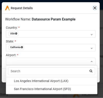

    3. The User Experience
    The result of this configuration appears in the Service Catalog request form.

    - Visual Output: Because of the Display Field configuration, the user sees a descriptive, user-friendly entry: Los Angeles International Airport (LAX).
    - System execution: When the user selects this option, the system ignores the descriptive text and captures the value LAX (based on the Value Field setting). This code is then passed to the workflow for accurate backend processing.
    This separation of visual presentation and technical execution allows for a seamless user experience without compromising the precision required for automated workflows.

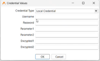

    NOTE: Select Type as Credential, and then click the Default Value field, to open the Credential Values dialog.
    A screenshot of a computer Description automatically generated
    The Credential Type list contains the list of all AE server credentials. However, the default value is the current credential.
    IMPORTANT:
    - For all AE server credentials to be available in the list, ensure that you sync the cred entials.
    - If you select an AE server credential, then the other fields in the dialog are read-only.
    - If the AE server credential is deleted from the server or the permission is revoked for the tenant, then you will see a notification.

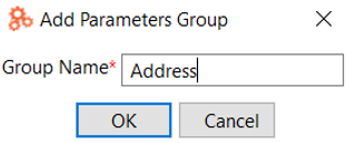

    Parameter Configuration ()Order and group the parameters to be viewed during request submission.
    The option is available only in the main workflow or process and is applicable only for runtime parameters.
    NOTES: The settings you configure in Process Studio will appear in the AE UI in the following two menus:
    - Catalogue 🡪 Submit Request
    - Schedules
    When you click , the Parameter Configuration dialog appears. It displays the list of parameters entered in the Workflow properties dialog. You can view the toolbar in the dialog.
    i. Select to add a new group. In the Add Parameter Group dialog, enter the name of the group.
    ii. Select the parameters to drag-and-drop to the group. You can create nested groups up to three levels.
    iii. Right-click on the group name, the contextual menu appears. Select Rename or F2 or to rename the group and Delete or DEL or to delete the group.
    iv. To expand or collapse the groups, select or respectively on the toolbar.
    If you want to view a single column layout of parameters in AE UI, select the Single Column Layout checkbox. The view in AE UI appears as follows:
    Else, clear the checkbox to have a double column layout.

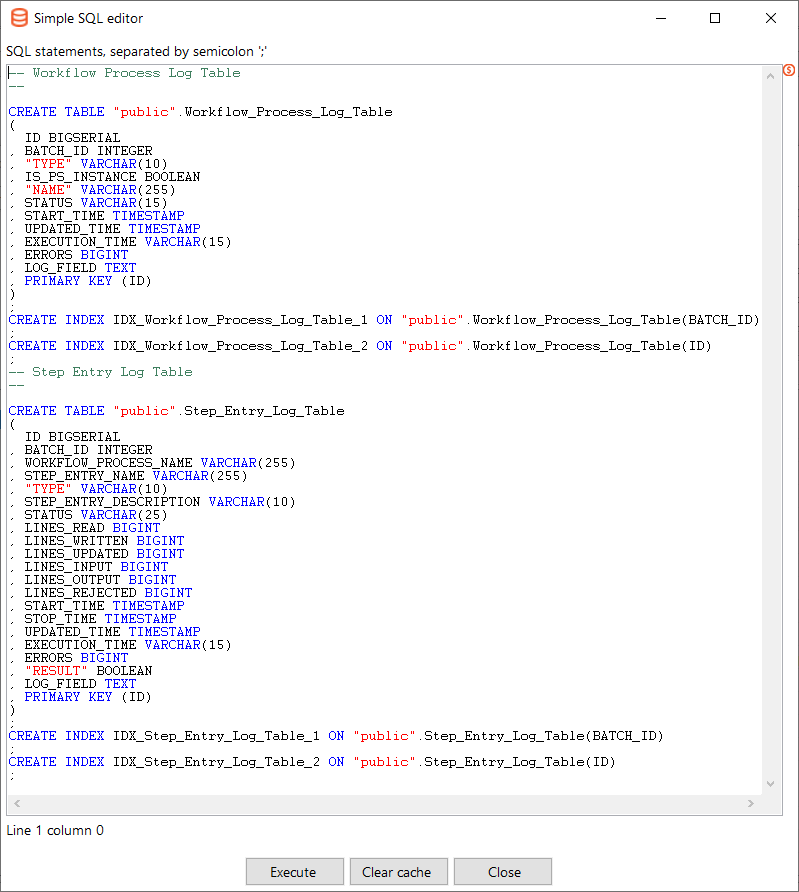

    LoggingIn the Logging tab, the following two options are available in the left pane: Workflow and Step. Select either Workflow or Step, and view the list of fields and their description, respectively. The fields listed for Workflow or Step are available to log step metrics data.
    Click Create Table and create a new database table, such as Workflow_Process_Log_Table and Step_Entry_Log_Table.
    In the result window, click Execute. The tables are created.
    NOTE: Creation of the tables is a one-time activity.

  5. Right-click on the canvas and select Properties or select CTRL+T. The Process properties dialog appears.
    You can also open the Process properties dialog through Edit 🡪 Settings... or double-click anywhere in the canvas.
  6. Specify the required details in the following tabs: Process, Parameters, PS Variables, and Logging.
    FieldDescription
    Process
    Process nameEnter a new name of the process.
    NOTE: If you modify the name of an existing process, then the name is also updated in the Project Explorer.
    Process filenameDisplays the path of the process.
    DescriptionEnter a description of the process.
    Created byDisplays the name of the user who created the process.
    Created atDisplays the date and time of process creation.
    Last modified byDisplays the name of the user who last modified the process.
    Last modified atDisplays the last process modification date and time.
    For details about the Parameters, PS Variables, and Logging tabs, see Create a workflow.

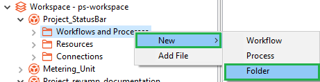

Create a folder
The section explains the steps to create a folder.
To create a folder:
  1. Under project, select Workflow and Processes and right-click. The contextual menu appears.
  2. Select Folder, the Create Folder dialog appears.
  3. Enter the name of the folder and click Create. The folder is created under the selected project.
    • Select the new folder and right-click on it. The contextual menu appears.
    • If there is an existing folder the Delete option is also available in the contextual menu.
    • You can also select Resources, and then select New Folder to create a new folder.

To create a group:
  1. In the workflow, select the steps that you want to group and right click on them. The contextual menu appears.
  2. Select Create Group. The Group dialog appears.
  3. Enter a name for the group, and then click OK. The selected steps are grouped together and a new group icon replaces them on the canvas.
    The group appears in the View pane as follows:

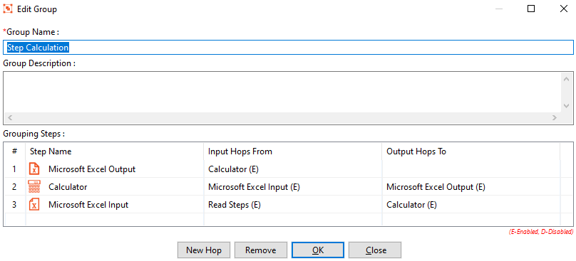

To edit a group:
  1. On the canvas, double-click the group icon. The Edit Group dialog appears.
  2. Modify the field details.
    FieldDescription
    Group Name*Modify the name of the group.
    Group DescriptionModify the description of the group.
    Grouping StepsProvides a list of steps grouped together.
    Right-click on each step and check the menu options available.
    * indicates a mandatory field.
  3. In the dialog, click New Hop to reset the existing hops.
  4. To remove a step from the group, select a step and click Remove. The step is removed from the group but is not deleted from the workflow.
