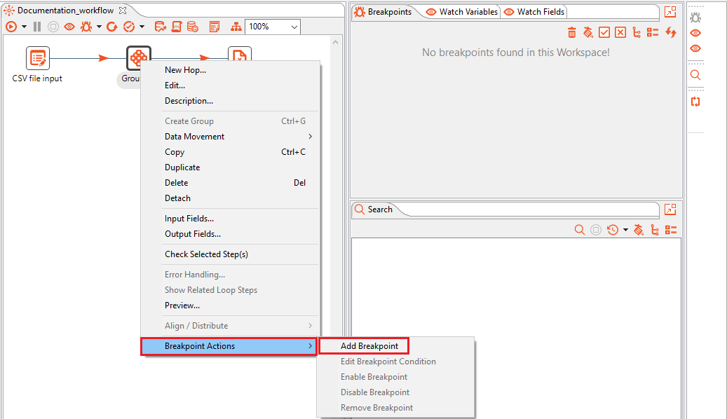

To add a breakpoint:
  1. Open a workflow and select a step.
  2. Right-click on the selected step and in the contextual menu, select Breakpoint Actions. The sub-contextual menu appears.
  3. In the sub-contextual menu, select Add Breakpoint. The Add Breakpoint dialog appears.
  4. In the dialog enter the condition for the breakpoint on the selected step. Click OK to save the details.
    • To reset the breakpoint condition, click Clear Condition.
    • A breakpoint on a step without any condition pauses at each row in that step.
    • A breakpoint added with a condition pauses at the row only if the condition is true.
  5. Run the workflow in debug mode. The details appear in the Breakpoints, Watch Variables, and Watch Fields tabs, and the row data and variables appear in the Debug tab of Execution Results.

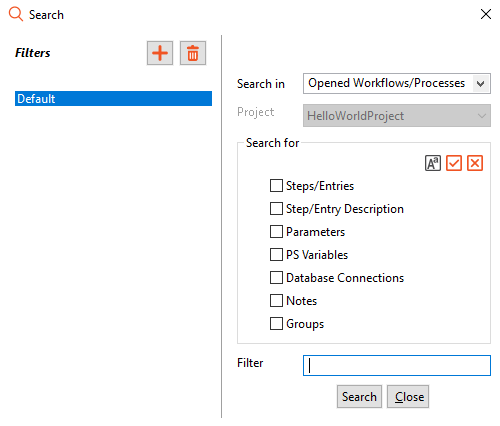

  1. Click Edit, and select Search Meta data... or CTRL + F. The Search dialog appears.
    You can also search for metadata using the Search tab. Click to open the Search dialog.
  2. In the Search dialog, enter or select details as required.
    FiltersDisplays the filters defined for search. The default filter is Default.
    - To add a new filter, click
    - To delete a filter, click
    - If you delete the Default filter an error message appears.
    - If you add or select existing filters, then the field Filter Name appears in the dialog box.
    Search inSelect the scope of search. Available search scope options are:
    - Workspace
    - Projects
    - Opened Workflows/Processes
    Note: If you select Steps/Entries as the scope of search, you can right click on the step or entry and select the Highlight option. The step or entry is highlighted on the canvas.
    To stop the highlight, select the step or entry on the canvas or press CTRL + H.
    The feature is available only for Steps/Entries option.
    Limitation: The Highlight feature may not work as expected, that is, may not highlight the step or entry when there are many steps on the canvas, especially if scrolling is required to reach the step.
    ProjectSelect the project in which you want to search the metadata.
    Note: The field is available only if you select Project in Search in.
    Search forSelect the checkbox against metadata you want to search for in the workspace, project, or open workflow or process.
    - To make the search case sensitive, select . If the search is case sensitive, then the icon appears as
    - To search all metadata, select
    - To clear the selected metadata, select
    - You must select at least one metadata for search.
    FilterEnter the filter criteria.
    Note: The field is optional and valid values are a simple string or regular expression. For example, name.
  3. Click Save, and then click Search. The results of search appear in the Search tab.
