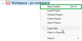

Create a new project through File menu
You can create a new project using the New option available in the File menu.
In addition, you can also click available on the status bar and create a project.
To create a new project:
  1. In Process Studio, click File and select New. The sub-menu appears.
  2. Select New Project. The Create Project dialog appears.

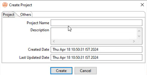

  3. In the respective tabs, enter the field details.
    FieldDescription
    Project tab:
    Project NameEnter a name of the project.
    NOTE: It is recommended not to use special characters in your project name.
    DescriptionEnter a description for the project.
    Created DateDisplays the project creation date and time.

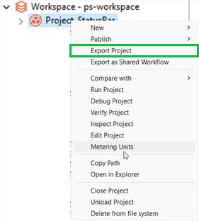

Export a project
Export a project for sharing the entire project setup or selected files or folders as a zip file within the team and import it into any Process Studio workspace.
To export a project:
  1. In Process Studio, select File and then click Export Project. The Export Project dialog appears.
    You can also export a project using any of the following ways:
    • The contextual menu:
    • Click Project Options on the Status bar. The Export Project menu is available only if workflows or processes are open on the canvas.
  2. Enter the field details.
    FieldDescription
    ProjectSelect the project you want to export.
    NOTE: If you want to narrow down the project list, enter the text in Type filter text.
    Zip FileEnter or browse the folder path of the zipped project file.
    NOTE: A default zipped project file path appears in the field, which you can modify, if required.

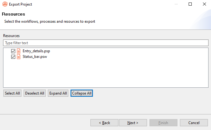

  3. Click Next. The Resources dialog appears.
  4. In the Resources dialog, select the required checkboxes. The selected workflows, processes, and resources are added to the zipped project file.
    • Click Select All if you want to export all available resources with the project.
    • Click Deselect All if you want to clear all selection.
    • Click Expand All if you want to expand the view.
    • Click Collapse All if you want to collapse the view.
  5. Click Next. The Connections dialog appears.
  6. In the Connections dialog, select the connections you want to export. The selected connections are added to the zipped project file.
  7. Click Next. The Breakpoints dialog appears.
  8. In the Breakpoints dialog, select the breakpoints you want to export. The selected breakpoints are added to the zipped project file.
  9. Click Finish. A message confirming that the project is successfully exported appears.

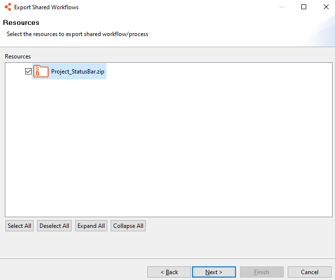

Export as Shared Workflow
Share the workflow with other users of the tenant using the Export as Shared Workflow feature. The tenant users can use the shared workflow to create their workflows, as required.
You can also share processes using the Export as Shared Workflow feature. Ensure that you select the main workflow or process for your project before you proceed with exporting the workflow.

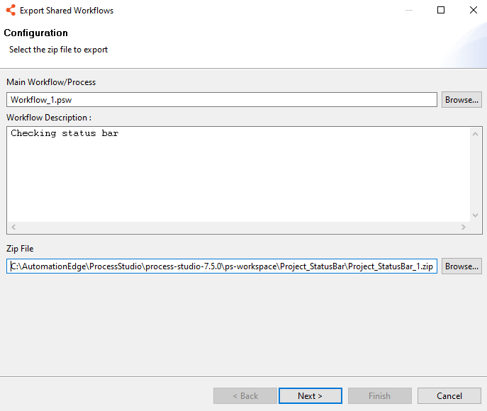

To export a project as shared workflow:
  1. In the Project Explorer, select and right-click on the project from which you want to share the workflow. The contextual menu appears.
  2. Click Export as Shared Workflow. The Configuration dialog appears.
  3. Enter the field details.
    FieldDescription
    Main Workflow/ProcessDisplays the main workflow name already set for the project.
    NOTE: To modify the detail, click Browse and select another workflow or process from the project.
    Workflow DescriptionEnter a description about the workflow.
    Zip FileDisplays the zipped project folder path of the workflow you want to export.
    NOTE: To modify the detail, click Browse and select another zipped project folder.
  4. Click Next. The Resources dialog appears.
  5. Select the resources you want to export with the workflow.

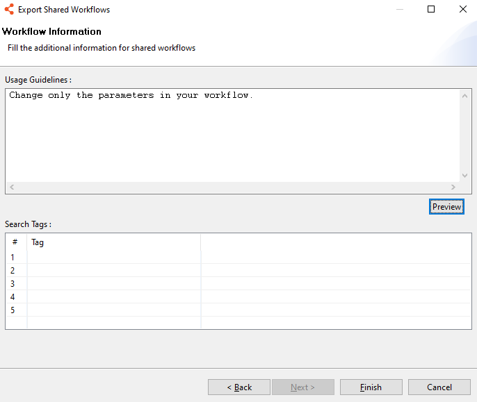

  6. Click Next. The Workflow Information dialog appears.
  7. In the Usage Guidelines field, enter the instructions for using the workflow, and in the Search Tags field enter the tags for searching the shared workflow in the Process Studio or the AutomationEdge UI.
    Click Preview, to view the guidelines. The tenant user must follow the guidelines provided by the workflow or process owner when using the workflow in the projects.
  8. Click Finish. A message confirming that the workflow is exported successfully appears.

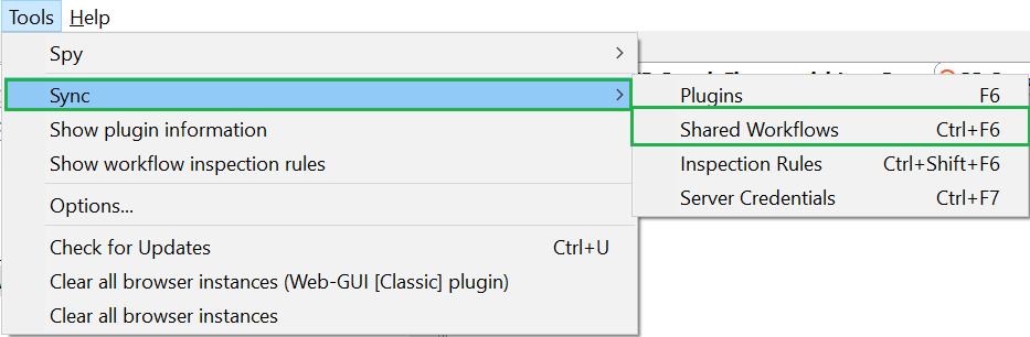

After uploading shared workflow through the AutomationEdge UI, you can sync the shared workflows using the Sync Shared Workflows feature. The shared workflows appear in the Shared Workflows tab.
Similarly, you can also sync and work with shared processes.
To sync and use the shared workflow:
  1. In the Process Studio, click the Sync Shared Workflow pane. The list of shared workflows that need to be synced appears.
  2. Click Tools 🡪 Sync 🡪 Shared Workflows. The workflows are synced.
  3. Drag-and-drop the shared workflow on to the canvas, which becomes the workflow executor step.

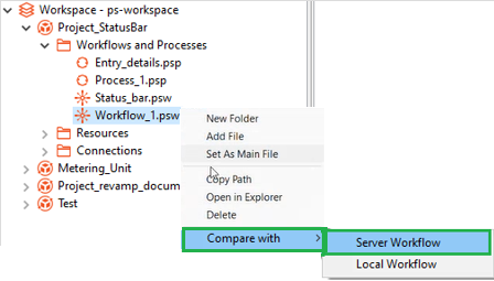

Manage a project
Manage a project using various options available in the Process Studio. The Process Studio allows you to compare your projects, run or debug or verify a project. In addition, you can also edit the project and view the unit consumption detail.
To manage a project, it must have workflows and / or processes. For more detail on workflow and process, see Work with workflows and processes.
You can manage a project in following ways:
Compare a project with...

Compare with a server workflow
Use the Server Workflow option if you want to compare the project and workflows on the AutomationEdge server to confirm the files added or removed before publishing or updating a workflow on server.
To compare the project with a server workflow:
  1. In the Project Explorer, select the project you want to compare, and right-click on it. The contextual menu appears.
    You can also compare the workflows at the workflow-level. !
  2. Select Compare with, and then select Server Workflow. The Select Workflow dialog appears.
  3. In Workflow, select the server workflow, and then click Select. The Project Difference dialog appears.
    The project from the Process Studio appears in the Source pane and projects from the AutomationEdge server or the selected local project appear in the Target pane.

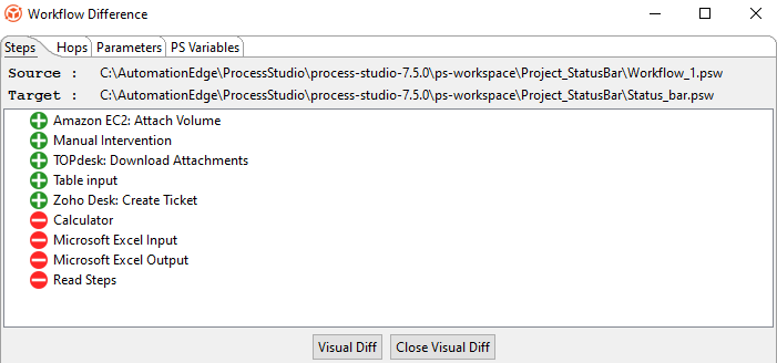

If you right click the workflow in the Source project pane, click View Diff in the contextual menu. The Workflow Difference dialog appears.
  • Steps: The tab lists the steps added or deleted or common in the two workflows.
  • Hops: The tab lists the step connectivity added or deleted or common in the two workflows.
  • Parameters: The tab lists the parameters added or deleted or common in the two workflows. You will see the configuration and runtime parameters only if the main file is same in the source and target projects.
  • PS Variables: The tab lists the Process Studio variables added or deleted or common in the two workflows. You will see the Process Studio variables only if the main file is same in the source and target projects.
  • Click View Diff to open the target workflow, Status_bar.psw, in the canvas.
  • Click Close Visual Diff to close the open workflow.

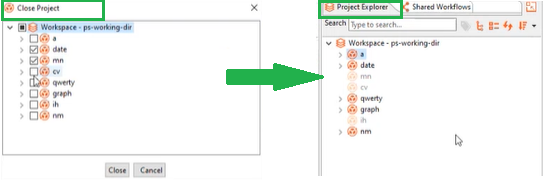

Close or open a project
You can close all open workflows, processes, and files in the selected project through the contextual menu. The closed project appears greyed out in the Project Explorer. On closing the project, you can open it again, using the Open Project menu that appears on selecting the same project again.
A screenshot of a project Description automatically generated
To open or close multiple projects, right-click on the workspace and select Open Project or Close Project in the contextual menu. The Open Project or Close Project dialog appears. In the dialog, select all or multiple projects to open or close, and then click Open or Close.
For example, the following screenshot shows the Close Project dialog with multiple projects selected. After clicking Close, the selected projects appear faded out in the Process Studio’s Project Explorer.

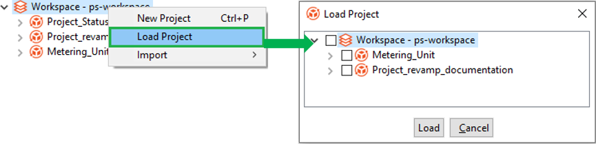

Unload or load a project
You can remove the project from the workspace list. However, the project is still available on your system, and you can load the project again to the Process Studio.
A screenshot of a computer Description automatically generated
To reload the removed project, use the Load Project menu that appears when you select the workspace.
You can also load and unload multiple projects through the workspace contextual menu.
