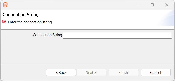

    AccessSelect the type of access you want for the database. Available options are:
    - Native (JDBC)
    - OCI
    - JNDI
    - Connection String
    Note: The availability of options depends on the type of connection selected. For example, when you select Connection String, the Connection String dialog appears. Enter the connection string and click Finish.

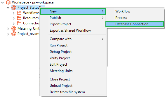

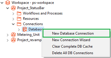

Configure new shared database
You can configure new shared database connections using any one of the following ways:
  • In the Project Explorer, select Project 🡪 New 🡪 Database Connection
  • In the Project Explorer, select Workspace 🡪 Project 🡪 Right click on Connections 🡪 New Database Connection
  • In the Project Explorer, select Workspace -> Project -> Connections -> Right click on Database connection -> New Database Connection
  • In the Project Explorer, select Workspace 🡪 Project 🡪 Connections 🡪 Database 🡪 Right click on database connection 🡪 New
    For details about configuring the database connection, see File menu

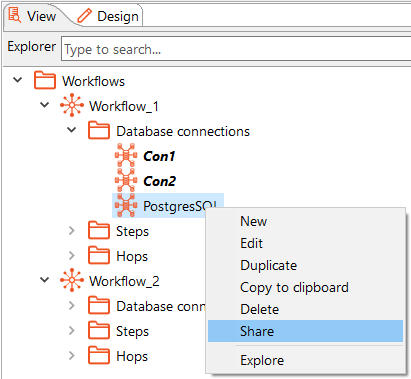

Share a local database connection
To share a local database connection, right click on local connection -> Share.
If you duplicate a local connection and make it shared database connection, then the shared database connection overrides across the connection in workflows and processes in the project.

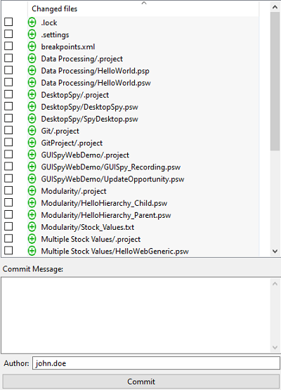

Changed files
In the section, you can work on the files in the repository.
You can view the new or modified files in the Changed files pane. A new file added to the repository has https://github.com/HiromuHota/pdi-git-plugin/raw/master/src/main/resources/org/pentaho/di/git/spoon/images/added.png icon against it. A modified file has https://github.com/HiromuHota/pdi-git-plugin/raw/master/src/main/resources/org/pentaho/di/git/spoon/images/changed.png and removed file has https://github.com/HiromuHota/pdi-git-plugin/raw/master/src/main/resources/org/pentaho/di/git/spoon/images/removed.png icons against it, respectively.

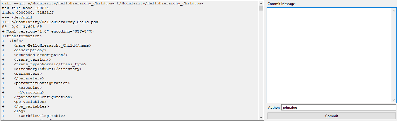

To commit a file:
  1. In the Changed files pane, select the checkbox against the files that you want to commit.
  2. Select the file to view its details in the stage pane, then enter a comment in Commit Message.
  3. Click Commit. The changes are committed to the working branch.
  • In the SVN perspective, committing the file pushes the updates to the remote repository.
  • In Git perspective, click Push, to commit the updated branch to the repository. The changes are now available in the remote repository.
