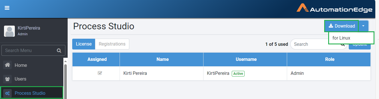

  1. Sign in to the AE UI as the Admin and go to Process Studio. The Process Studio page appears.
    img Figure 1: AutomationEdge user interface: Process Studio page
  2. In Process Studio Registration page, click Download. The Process Studio zip is downloaded for Windows.
    • To download Process Studio for Linux, click the corresponding dropdown.

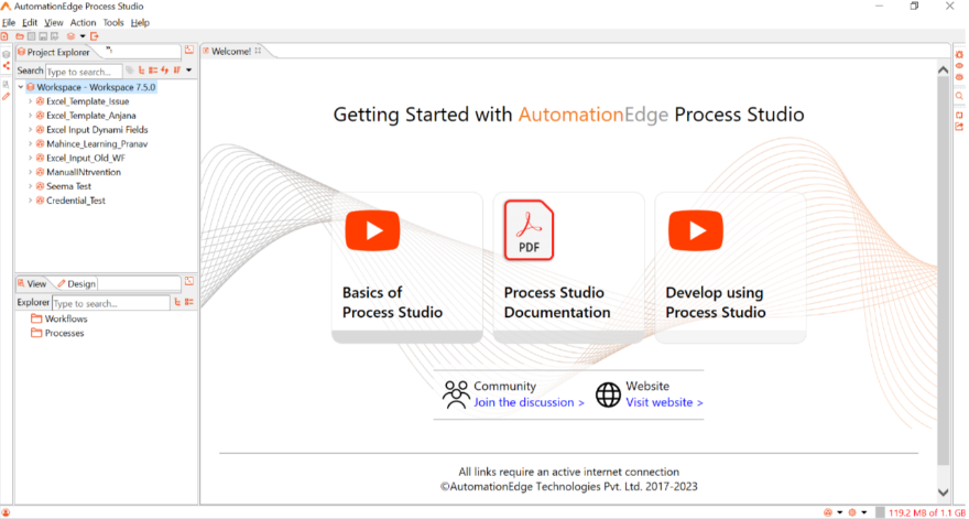

  1. Click Launch. The Process Studio opens.
    Figure 4: Process Studio
After the Process Studio opens, you will see the list of plugins in the Sync Plugins pane. For details on synchronization of plugins, see Synchronize Process Studio with AE.

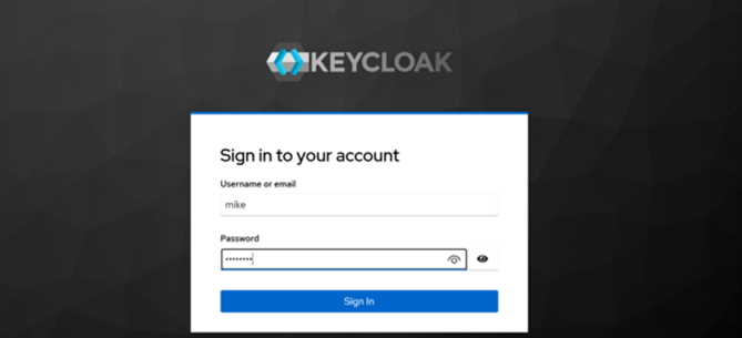

KEYCLOAK
  1. Enter Username or email and password. You are logged in to Process Studio. You can close the browser window on successful login.

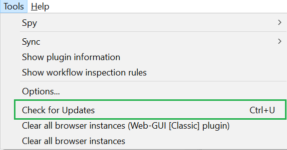

  2. You can also check for updates, manually, through the Tools menu in Process Studio.
    i. In Process Studio, click Tools and select Check for Updates.
    A screenshot of a computer Description automaticallygenerated Figure 7: Process Studio -> Tools -> Check for Updates
    ii. If Process Studio is already up-to-date, a No updates available, message appears. Click OK to close the message. And if updates are available then, Process Studio is updated and restarted.

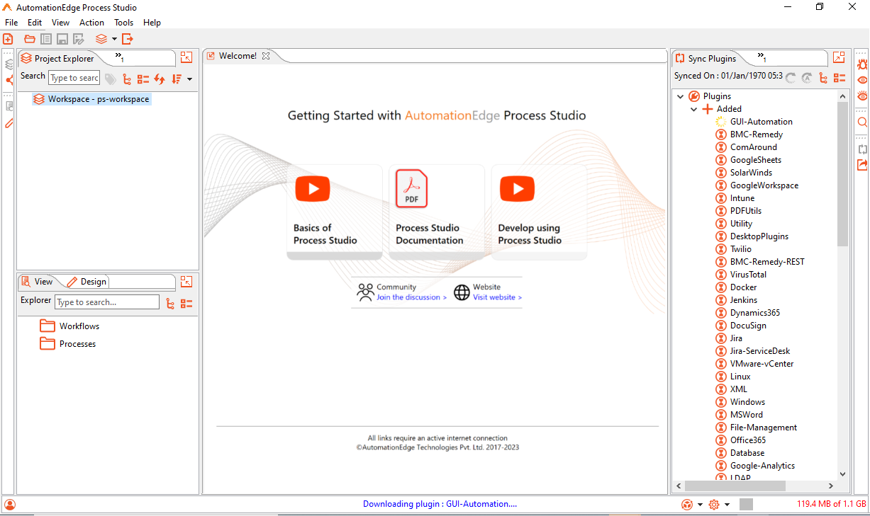

When you sign in to the Process Studio, new or updated plugins from the AutomationEdge server are automatically synchronized. You can see the plugins in the Sync Plugins pane. You can also manually synchronize the plugins through Process Studio, Tools 🡪 Sync 🡪 Plugins.
Known issue: Plugins are not syncing in the Process Studio due to time difference between the Process Studio and AE server.
Synchronization also cleans up any invalid plugins in Process Studio.

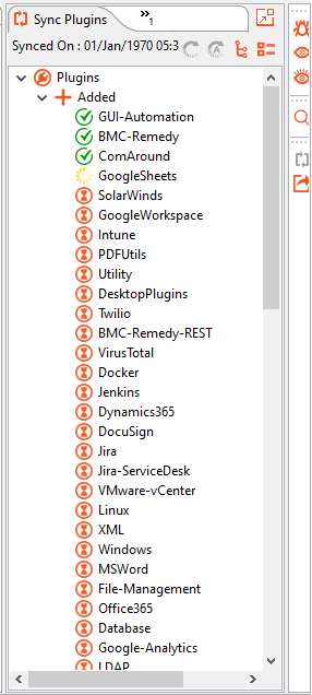

Synchronize plugins automatically
When you sign in to the Process Studio, it automatically checks for any plugin updates and synchronizes the plugins.
You can view the new, updated, or deleted plugins in the Sync Plugins pane. In addition, you can also view the list of updated or deleted files.
Figure 8: Process Studio -> Sync Plugins view
  • : Indicates plugin sync is successful.
  • : Indicates the plugin sync is in-progress.
  • : Indicates plugin sync awaited.
You can continue working with the Process Studio even when the syncing of new plugins is in-progress. The Process Studio does not restart if plugins are added. However, if a plugin is updated or deleted you are requested to restart the Process Studio.

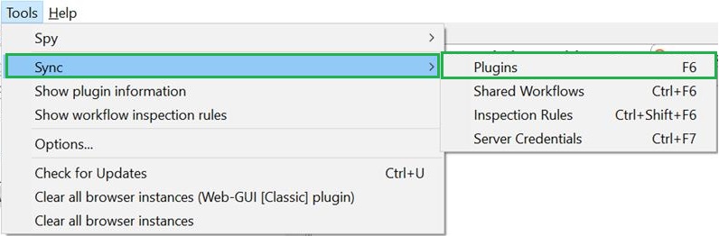

Synchronize plugins manually
You can synchronize plugins manually through Process Studio.
To synchronize plugins:
  1. Open Process Studio, go to Tools → Sync → Plugins. The AutomationEdge Connection Details dialog appears.
    Figure 9: Process Studio -> Tools -> Sync -> Plugins
  2. In the dialog, enter the password, and click Connect. If updates are available, a message confirming the updates appears.
  3. Click OK. The plugins are updated and Process Studio restarts.

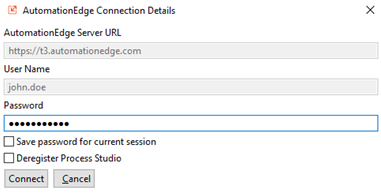

Deregister through AutomationEdge Connection Details dialog
You can directly deregister Process Studio through the AutomationEdge Connection Details dialog.
AE Connection Details dialog
Figure 10: AE Connection Details dialog
Run Process Studio, and in the AutomationEdge Connection Details dialog select Deregister Process Studio.
If the deregistration is successful a message confirming the success appears.
